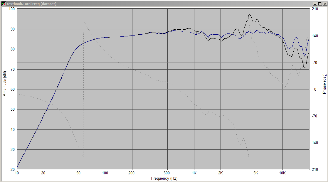

edit: Just out of interest, I've posted a comparison between a textbook 2nd order L/R at 3Khz with a textbook lpad (with 8db cut target) and what I had so far come up with. I think this is a good example of how poorly an off the shelf text book crossover can perform. text book is the black curve. Note this one has not got full bsc, as per Chris' comments. I'm not sure yet if it is as good or not. using full BSC gives a bit more room for manipulation 😉
Tony.

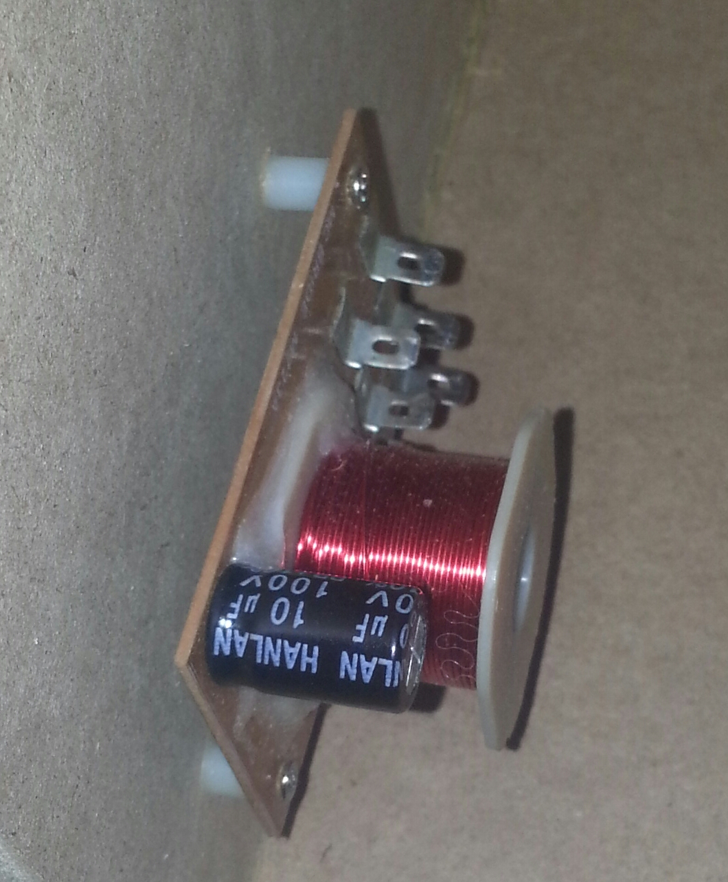

thanks my next question after looking at the crossover was is it a 10uF cap 🙂 looks like textbook 1st order. so coil will be around 0.63mH (I'll guess the closest standard value).
I put this into speaker workshop this morning and it was surprisingly not too bad (better than the 2nd order 3Khz I modeled before).

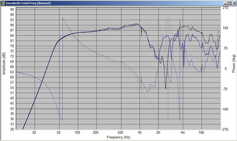

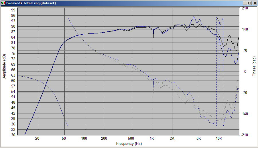

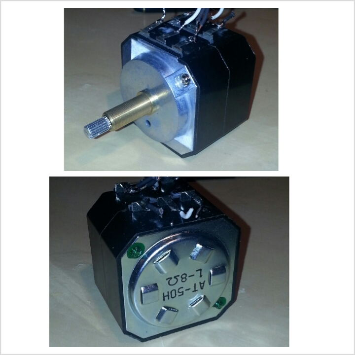

Hi Shaolin,
Below are the results of tweaking the off the shelf crossover circuit. The first is the actual modifications to the circuit.
2nd is the simulated spl compared to the (blue) simulation of the off the shelf crossover with just an lpad. There isn't a huge difference, but I think the removal of the peak between 4 and 5Khz should make quite a difference to the sound balance.
3rd is the simulation with the tweeter phase reversed (note that it should be connected in reverse polarity in this crossover). The null is not too bad and shows reasonable phase tracking in the crossover region. The off the shelf doesn't do as well.

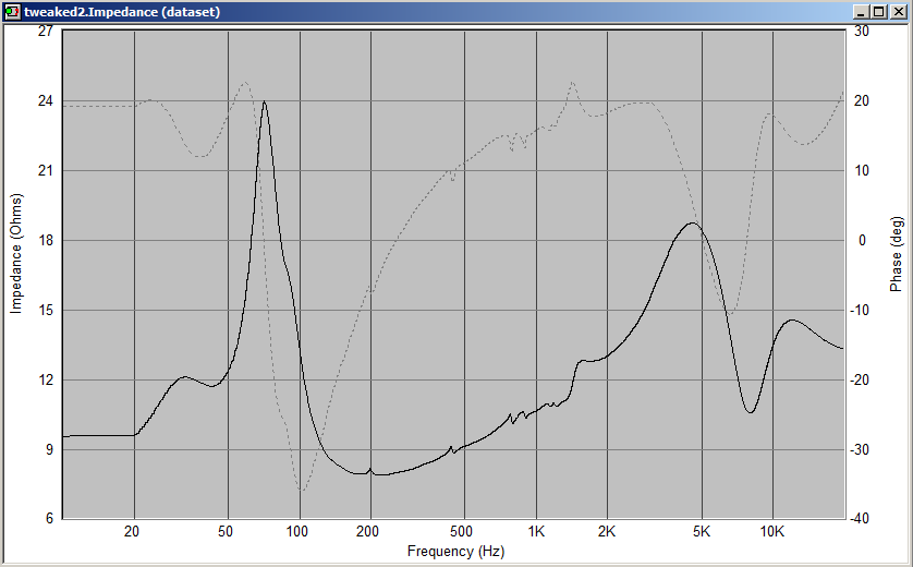

4th is the impedance plot to show that there are no nasty dips.
The crossover is actually 2nd order bessel acoustically at around 2Khz. This is rather low for this tweeter, but provided the speakers are not pushed too hard it will probably be ok.
The bass response was using the model for the bass reflex tuning of 53Hz in your existing enclosure. I'll see if I can do a sealed for comparison.
Note that this still needs some baffle step compensation. I'd suggest doing this as passive line level as Chris posted earlier. It should be much cheaper and easier and easier on your amp. Rod Elliot covers it here --> Baffle Step Compensation
I haven't tallied up the cost for this variation, but I think the coils will be the most expensive and I simmed using these ones Jantzen 0.50mH 20 AWG Air Core Inductor 255-036 which are only $4.59 each. In total it probably won't be much over $20.
So I guess the question is whether you want to spend a bit more to see what improvments you can make or start from scratch with a proven design. I guess the most important thing is to have learned something from this one 🙂
Tony.

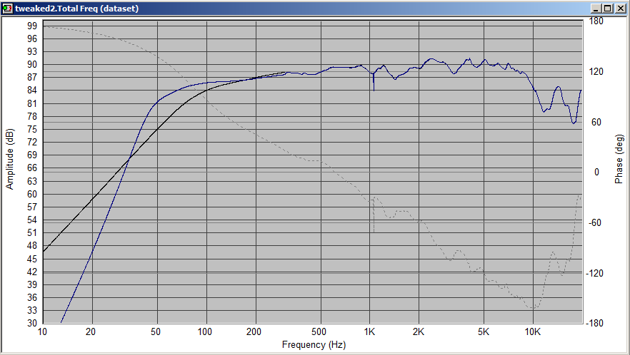

I've just done the sim with the sealed alignment (with baffle step factored in) and attached is the comparison to the vented. Blue is the vented.
Tony.

First the rated bass response is 56hz, but the resonance of the speaker is about 65hz. Below resonance bass drops off quickly.
In a sealed cabinet, the rated low end is 69hz. That's just OK, but no more.
However, if a ported bass reflex cabinet, of about twice the size, the rated low end is 36hz.
In short, you don't get much bass in a sealed cabinet.
The next issue that other are addressing is the difference in the output of the drivers.
To determine this, look at the Sensitivity rating of both speaker -
88dB = Goldwood Woofer
100db = Pyle Tweeter.
That means you have to bring the level of the Pyle Tweeter down close to that of the Goldwood woofer.
I have a speaker that uses an off the shelf crossover, it is not perfect, but it works fine for a first time build.
Here are a couple of photos -
Notice the white rectangles behind the crossover. Those make up an L-Pad; one to bring the level of the Horn Tweeter down, and the other to bring the level of the Horn Midrange down.
On the next image -
You can see the crossover and the drivers completely wired. Notice the VARIABLE L-PAD, the white resistors being the Horn Midrange down the first step, then the variable L-Pad lets me adjust it the rest of the way to my taste. Cutting the level down on the Midrange with the resistors makes the L-Pad a bit less sensitive and gives me a finer adjustment. But, if I had know precisely how must attenuation I needed, I could have accomplished it with just fixed resistors.
At the very bottom of this link -
Crossover Design Chart and Inductance vs. Frequency Calculator(Low-pass)
You will find a Calculator that will give you the necessary resistor values to get any attenuation you want for any impedance of speaker.
This creates an Impedance Balanced attenuation. You have an 8 ohm tweeter, so no matter how great or slight the attenuation, the amp will always see 8 ohms there.
The resistors I'm using are 10 watt audio resistors, very low cost and easy to find.
In theory you would need this much attenuation -
At = St - Sb = 100 - 88 = 12 dB
But, what works in theory, doesn't always work in practice. I would calculate the resistor values for -9db, -12db, and -15db then try them all and see which you feel sound best.
The resistor are probably less than $2 each.
As an example -
Dayton Audio DNR-2.0 2 Ohm 10W Precision Audio Grade Resisto 004-2
The Shipping from Parts Express on small order can be pretty high, but these resistor are common as dirt and you can find them anywhere. Do a Google-Shopping search and see what comes up. Or call some local HiFi or Electronic stores.
I'm assuming these are bookshelf speaker, so I don't know who much room you have, but if you have a variable L-Pad, you can just dial in the what sounds best to you.
L-Pad 100W Mono 1" Shaft 8 Ohm 260-265
As you can see from this photo and my photo above these are not tiny.
