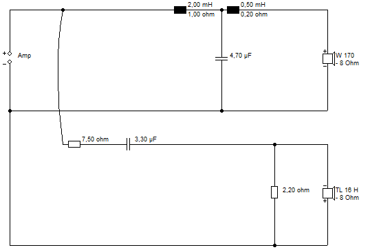

That small a difference is fine. they are often +- 5% or 10% anyway 🙂
The cheapest caps are usually bipolar electrolytics, but for small value caps I prefer to use polypropylene. I'd go with the cheapest poly caps they have there. you only need 1uf, 1.5uf and 5uF (I think they have 5.1uF) The 10uF is the one on the existing crossover. The 630uH coil is also the one on the existing crossover, so the only coil is the 0.51mH one.
For the resistors just get non-inductive white coffin types 🙂 They are usually about $1.50 each. If you don't want to spend so much on the caps have a look at the bi-polar electrolytics (Though defiinitely get a polypropylene one for the 1.5uF in the notch filter. I found that electrolytics in notch filters do not perform as expected). 50V ones should be more than adequate for the power you have.
