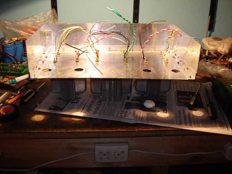

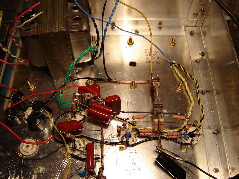

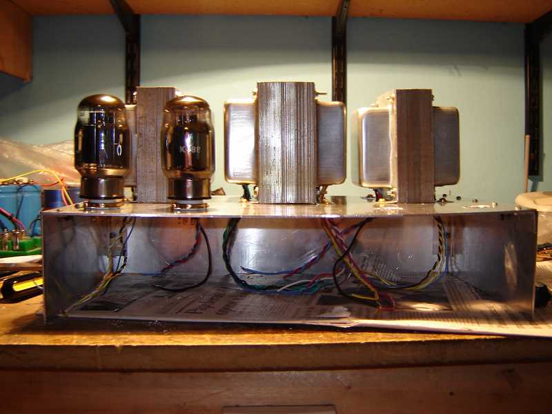

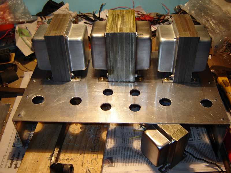

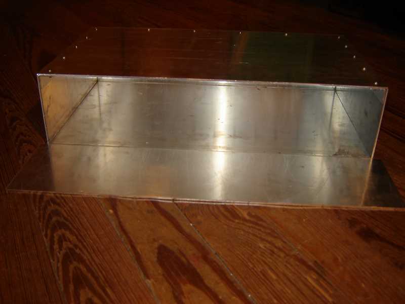

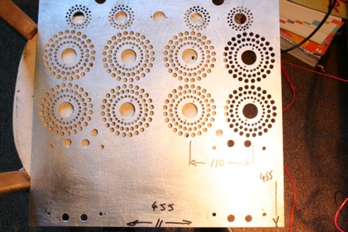

But... doesn't it make sense to have an asymetrical layout with a stereo amp? The visual appeal of symetrical layout is something, but it doesn'r really allow for the best performance possible.
If the input tranny is off to one side and the outputs off to the other side, you can route the circuit to help minimize noise, not add to it.
Am I wrong thinking this way?

You are quite right. ther's alot of sense doing everything symmetrical esp when things go wrong on one side it is easier to compare A+B channel test. Looking at amps made decades ago, things where put where fitted. The rule is to keep the front end (input) away from power components and with stereo as you mention both channels look same all is better.
Photo top place stereo power amp 200W amp. The ventilation will need it for sure.

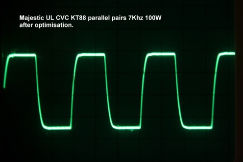

R4 seems wildly high....common pentode circuits in 3 stage amps use between 4K-22K, again this value is determined by the output transformer quality with square wave. So much hangs on o/p tranny quality.
When everything is working as it should be, one should get a square wave of this quality.

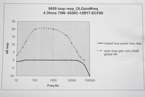

richwalters said:Assuming everything is working, have you thought of plotting the open loop gain and response ? encl example. Excel program is ideal for this.
richj

I forgot to reply regarding reducing amp gain. This OMO but depends how much you want reducing. If 3-6dB I'm tempted to increase global nfb, advantages even lower thd and noise. Don't, reduce it without an os' scope as as any change will result in ringing on square wave and will require a compensation cap change on the 1st stage..some experience is required.
If you <check out> a tube amp at 10Hz by forcing a sine wave through it at full power below the output transformer design cutoff frequency will probably saturate and overload the output tubes. This is bad practise.
Alot of p-p tube amps behave poorly below o/p tranny cutoff usually 6dB/oct. Lowest note in music is lowest organ note at 16Hz and no commercial amp/speaker system can manage this.
richj

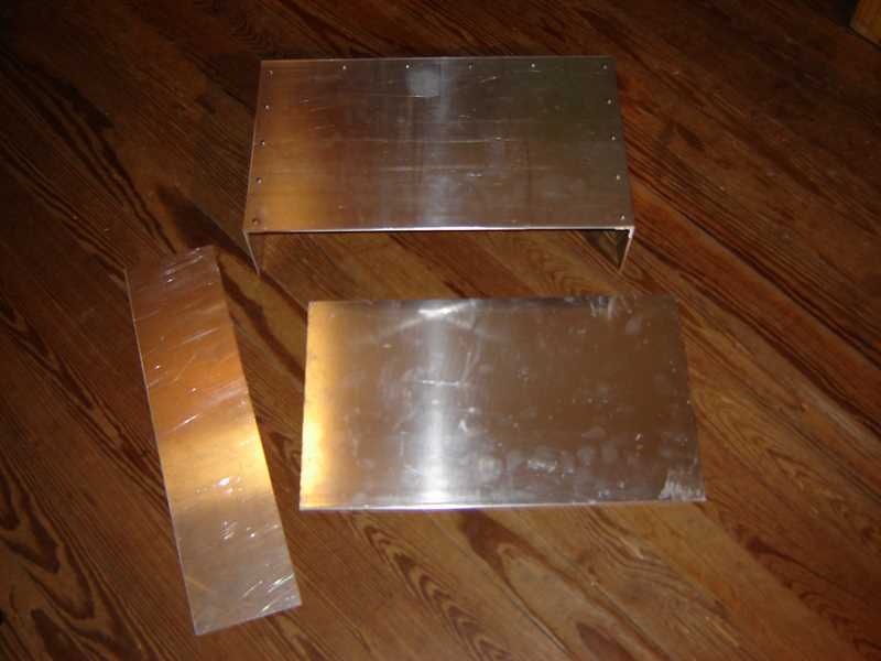

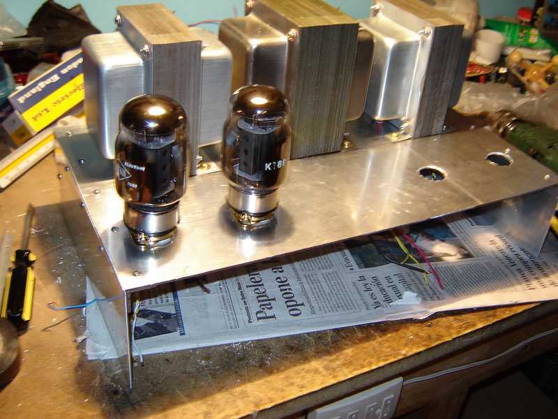

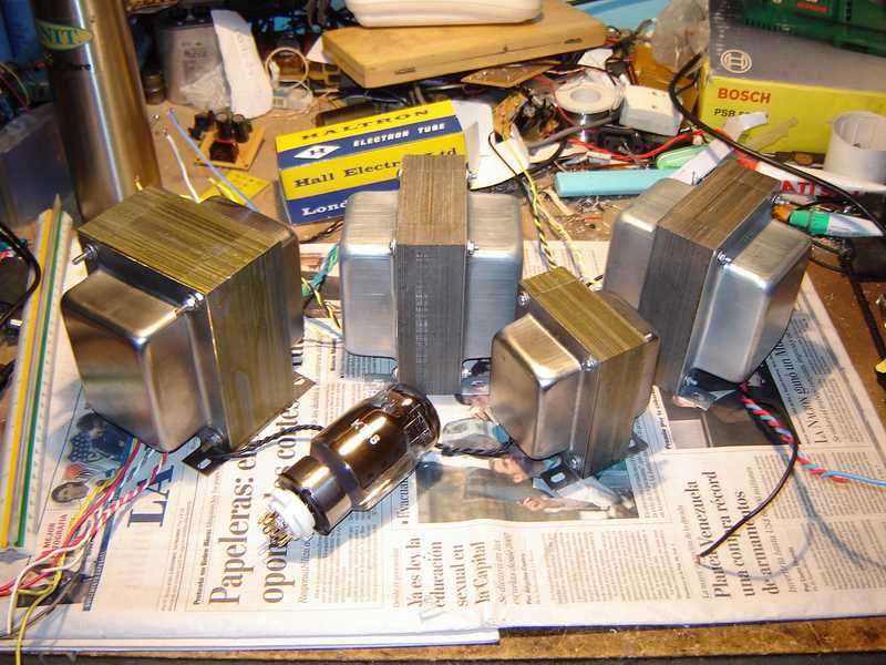

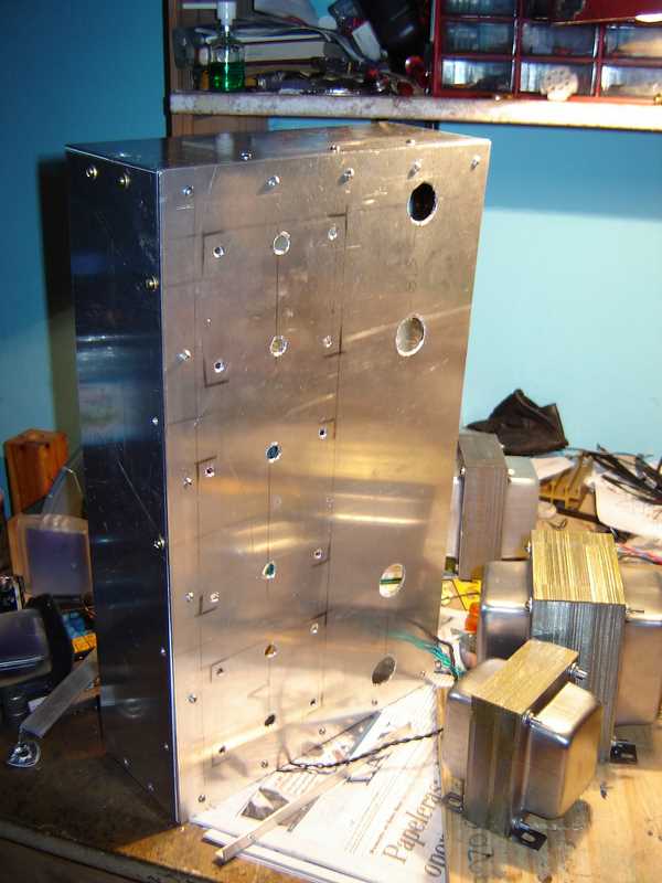

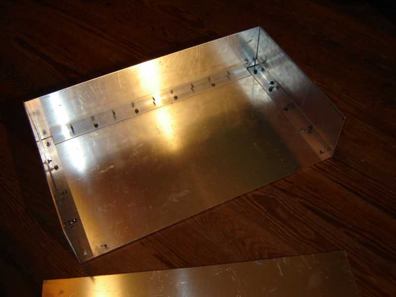

Just ran across this old thread and the pictures are all gone. Can anyone upload at least the final schematic? Thanks.
Hello!! how are you? Sadly I never finished the amp. It sounded amazing. I never moved from prototype to a good looking amp.
I will try to find the final schematic. 😀

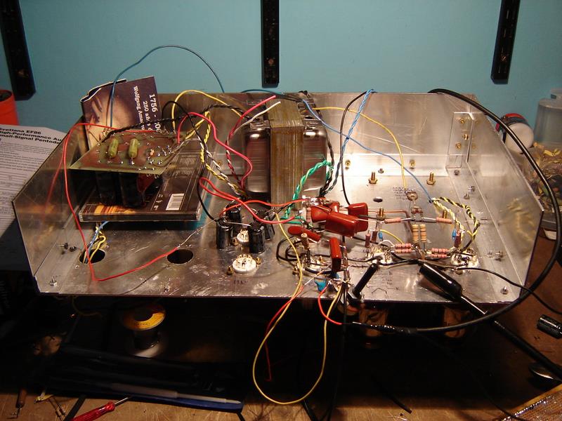

some pics...
