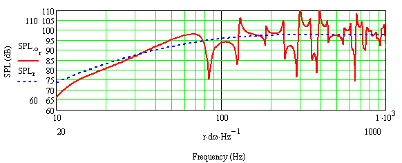

This is the cabinet with no damping applied, in the TL sections sheet & the drivers paralleled for the sake of the sim.
Scottmoose,

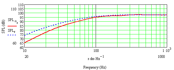

Thanks for taking the time to build those! Perhaps you can check my density calculations to make sure I'm not messing it up. 48 total ounces of stuffing into ~1.7 cuft of volume.
Interesting that your second graph with 1lb/ft^3 shows a -10db point of ~45-50hz, similar to what I'm seeing, though my measurements do have a bit steeper falloff.
Well, 48oz / 16 = 3lbs. 3lbs / 1.7 cubic feet = an average density of 1.76lbs ft^3 of material.
There will be a degree of variation in practice from the simulation, especially given that different materials require different packing densities for similar damping performance, but they get you in the right zone. In this case, your 75% great quantity of damping is going to kill some more of the LF gain.
People often get the wrong idea about TLs, primarily because the blasted phrase has come to be used for so many different cabinets, with completely dissimilar objectives. In the case of this cabinet, it's a near-aperiodic line, closer to a proper transmission line than a lot. These cabinets tend to offer a damped bass, with a shallower roll-off (starting at a higher frequency) than a vented enclosure; 18 or 12db / octave compared to 24db / octave is common. Their real advantage lies here, and in presenting a much flatter impedence to the amplifier (the mythical 'ideal' load), with superior cone control to an equivalent sealed box.
Ripping out all the damping from the last part of the line might help a bit. Looking at what MathCad's telling us about their performance without any damping at all, I wouldn't expect a huge difference -they simply don't have enough volume & the line is too long for there to be much LF gain. It appears that Dan hit his design objectives well enough, albeit arguably going a bit far in some areas, but those objectives do not match your taste, which isn't entirely surprising given the confusion the name Transmission Line invariable engenders.
