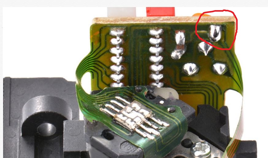

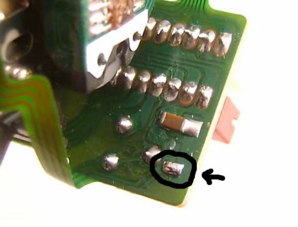

WTH would I do without you guys? So when you say mains I think you mean both need to be unplugged from the wall, correct?
It appears I will need to disassemble to get access to the dot, which is no problem.
Once it's hot, what do I use to remove it or will it stick to the point of the solder gun?
Fixed!!!! Sort of...
The soldering iron worked!!!
Then I dropped the top white plastic gear that drives the pickup on the soldering iron and melted it!!!!!
Now it plays perfectly until it gets to the damaged portion of the gear. I'll need to find a replacement online or eBay.
Being a newbie sucks. But I'm learning.
