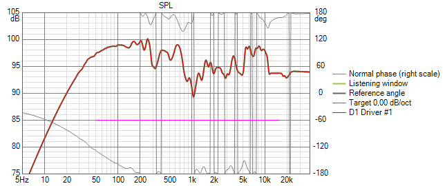

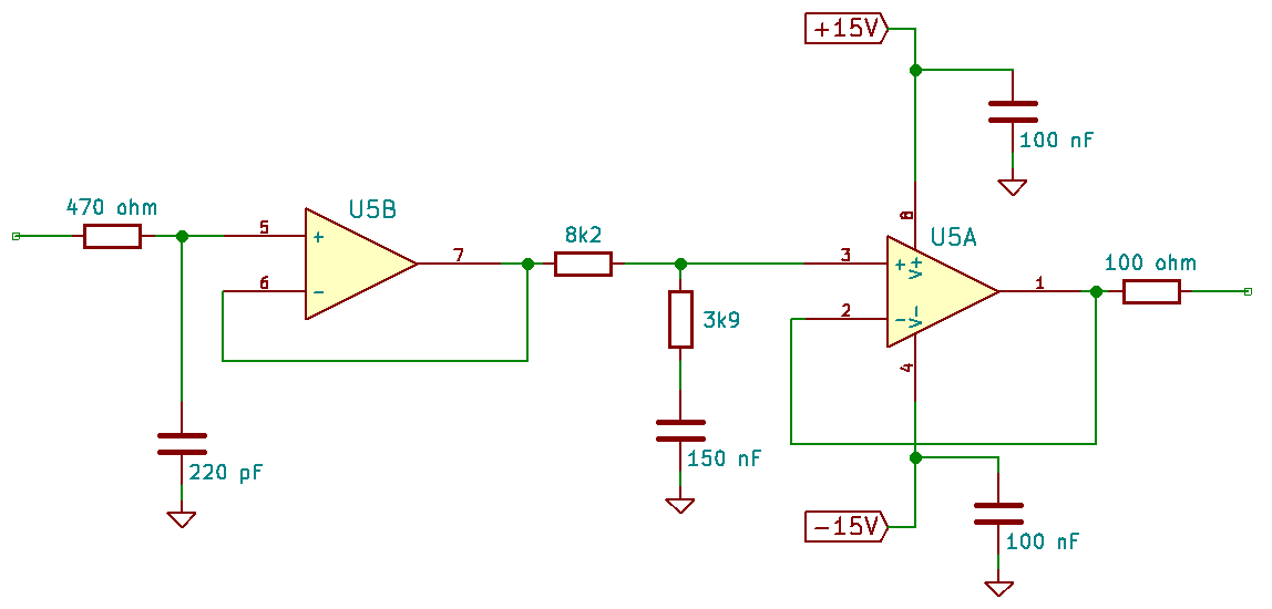

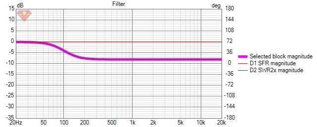

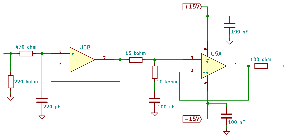

Resistive voltage divider seems like a rather simple solution, is there any ''catch'' to it? I haven't seen it in use in active filters. First order might be too shallow to counter the rising LF response, and it might require to move the crossover point somewhat lower. No need of signal inversion, at least that I know of.
Your purple trace actually requires a biquad rather than a first-order filter. With a biquad, you can make this:

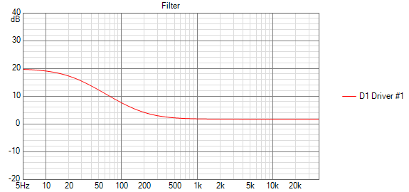

When you design a Linkwitz transform circuit (popular type of biquad) for Q = 0.7071068 and cut-off frequencies of 79.43282347 Hz and 125.8925412 Hz, this is what you get. See also the attachment.

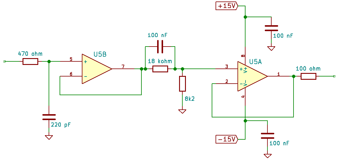

Marcel was a bit quicker than me.Quick and dirt, but it gives you some idea what can be done .View attachment 1060451View attachment 1060452
Thanks for answering. I didn't know that such a ''sharp'' FR correction was possible with a single op amp circuit. If so, I could perhaps correct for the whole LF cancelation issue, without further corrections in digital domain.
I've managed to tweak a Linkwitz transform filter within Vituix and extend the frequency response all the way to 40-50Hz. However, with a biquad, I only see the option of boosting the low frequency response (Unlike the example in Marcel's graph).

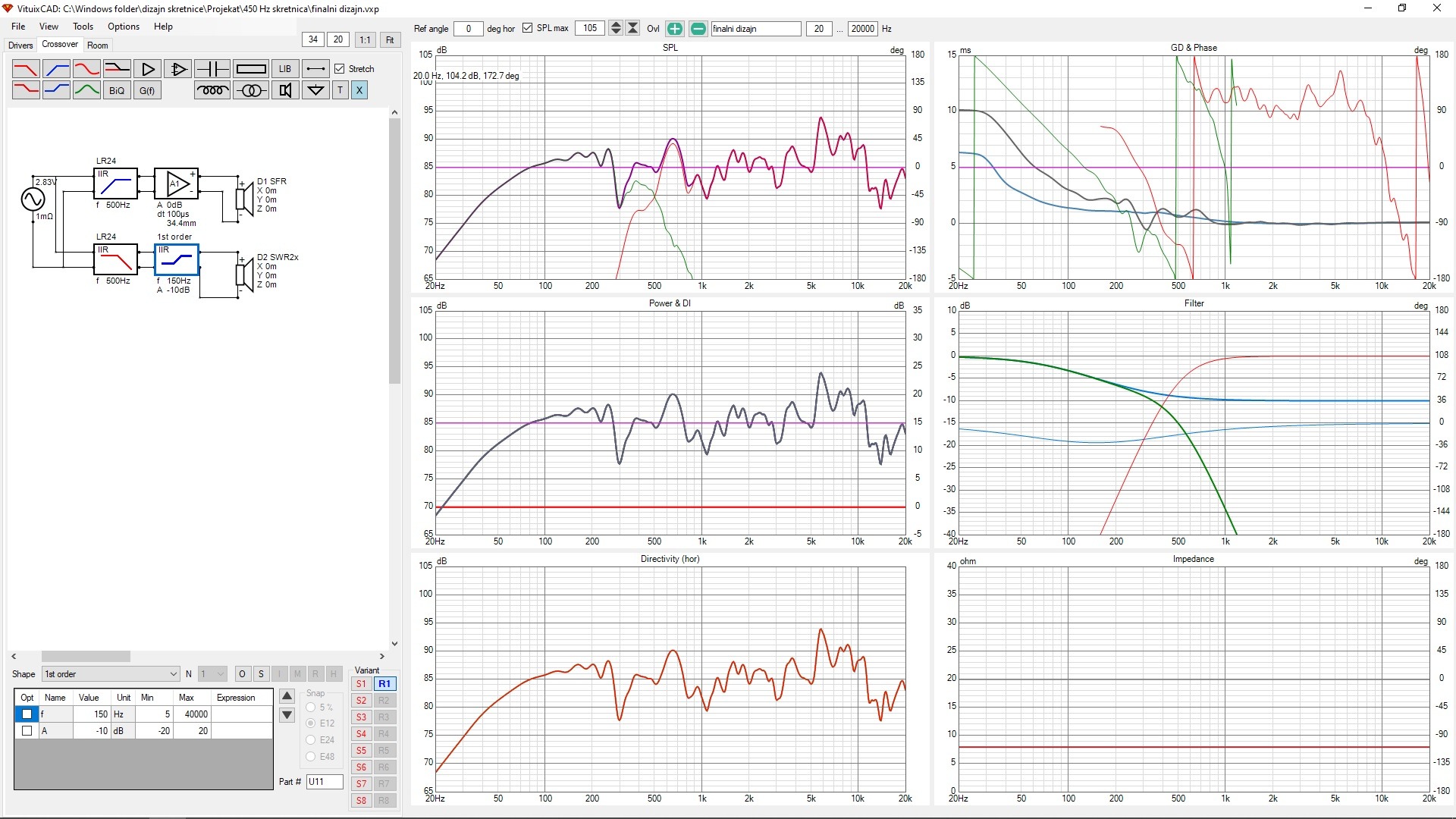

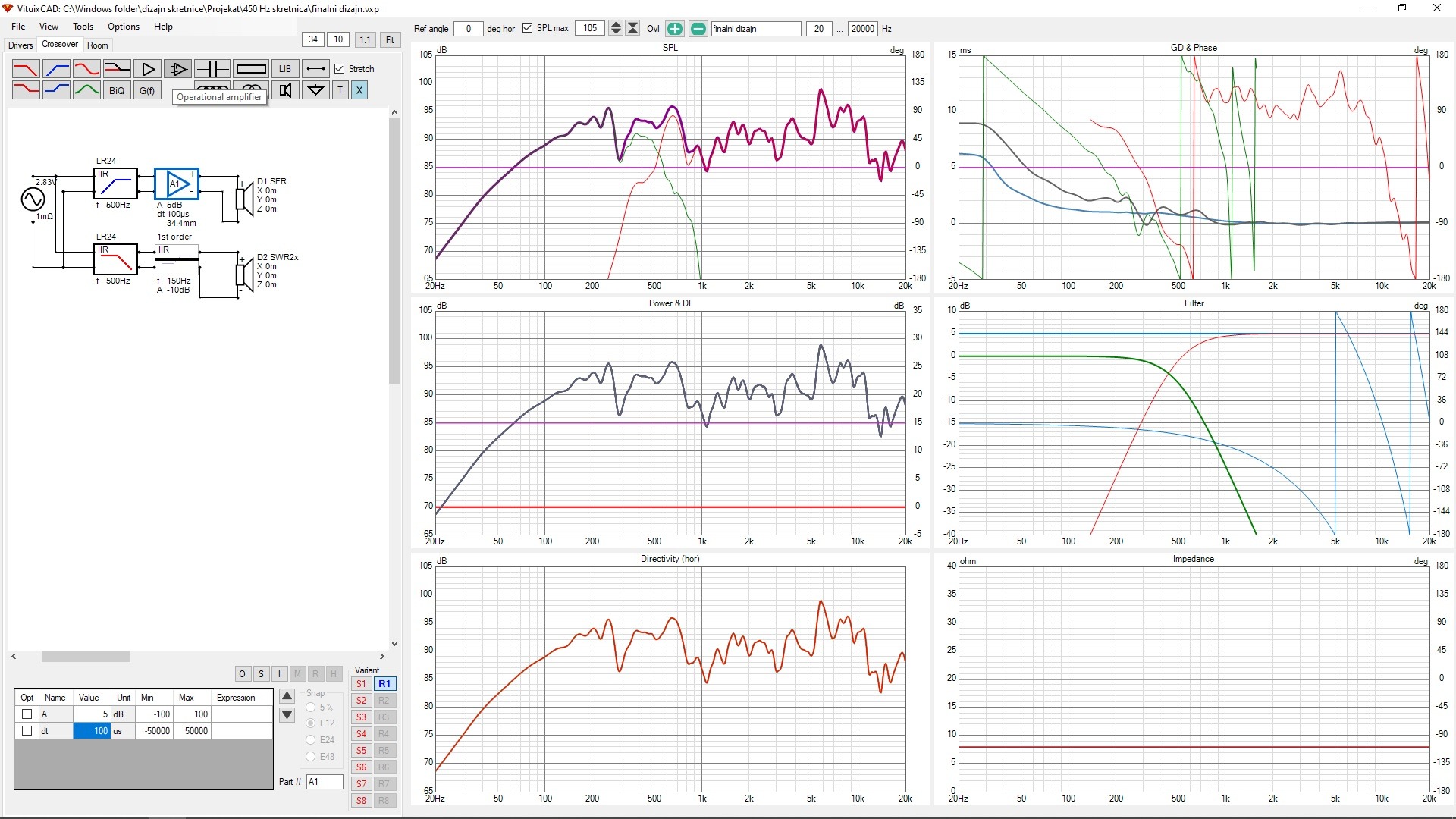

If you simply build/draw the Linkwitz Transform schematic in VituixCad, and set the desired transfer function of the LT in the Optimizer, you can have the VCad Optimizer do the work for you and optimize the component values.

Probably I was not clear: you simply build the LT in Vituixcad with Opamps, resistors and capacitors, starting with the R and C values Linkwitz gives on his website. Then you define a target, that is a desired transfer function of the filter and let the Optimizer optimize the R and C values in the schematic. It is not necessary to work with filter coefficients.
By toggling/playing with the values of the capacitors and resistors in Vituixcad you can experiment and taylor the circuit. The filter andf SPL displays will immediately show the effects.
I must say, that's one wonderful piece of a software. Thanks for being persistent, I managed to get the filter fine tuned it. 🙂
One other thing that poped out - phase change, due to linkwitz transform circuit, totally messed up the phase response of a LR 24 dB/Oct crossover. It was in phase right at the crossover frequency, but just 20 Hz up/down, there was a significant cancellation between drivers. Changing the polarity of one of drivers did make response somewhat better. I guess the crossover point might be too close to the biquad filter. Either way, I'll put it together and give it a try.

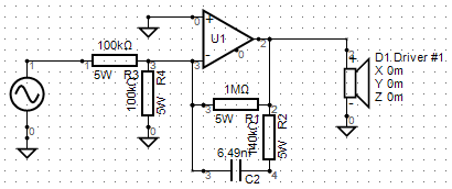

For bass extension, you can also use this circuit. It has the advantage that it needs only two capacitors of standard values, and the disadvantage that the calculations are more complicated than those for Linkwitz's circuit. The values given are for extending a loudspeaker with 80 Hz, second-order Butterworth response to 40 Hz. Of course the op-amp supply pins need to be connected to something.
Thanks for recommending it. I will input it in VituixCad with those exact values and start changing one at a time.

If you know the desired pole and zero positions, you can calculate the values for the filter of post #31 with the method in the attachment. I intended to do the calculation for the transfer of post #21, but the desired transfer function had changed before I got a chance to do the calculation. In any case, numerical optimization should also do the trick.
