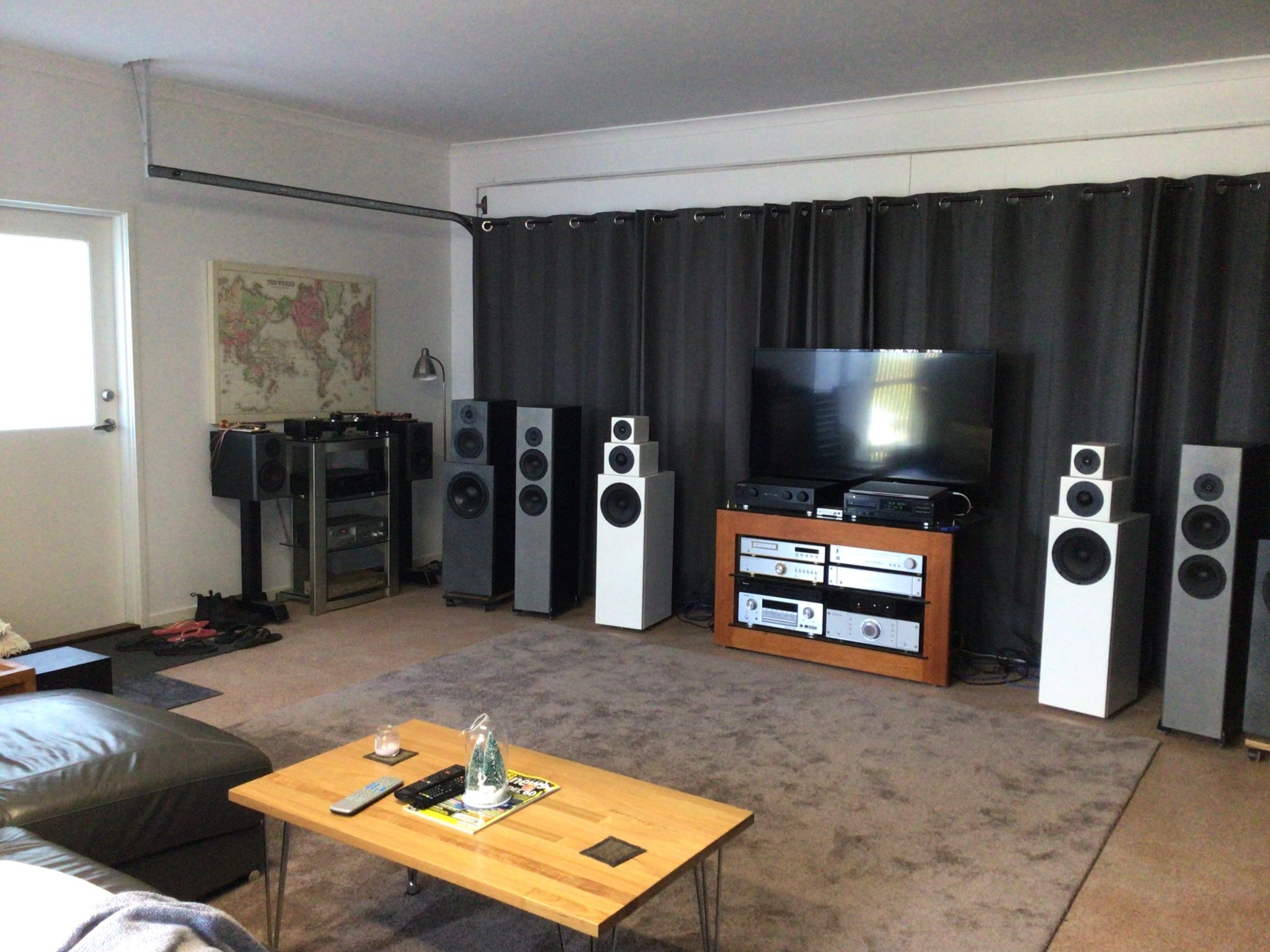

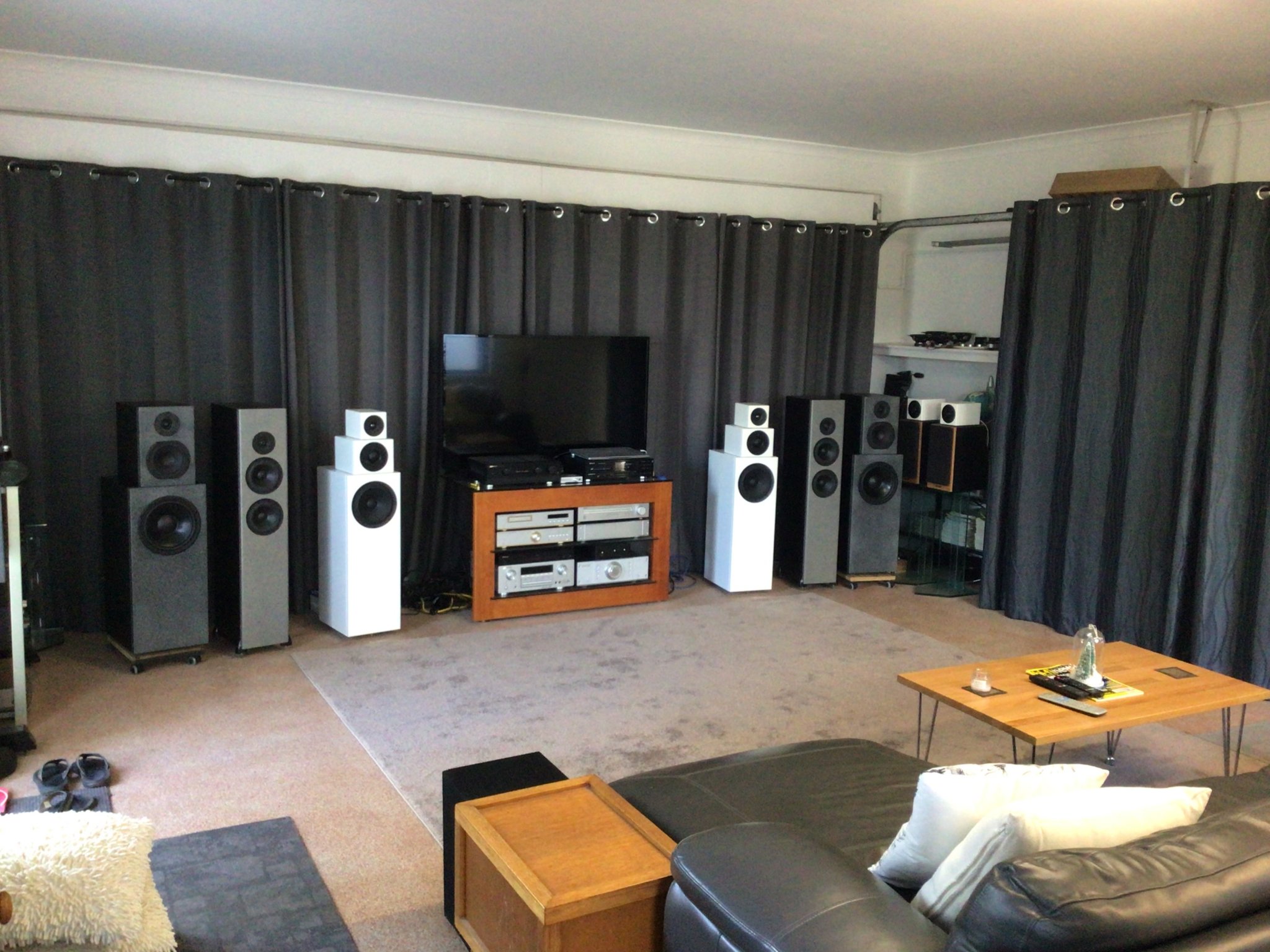

Normal gyprock walls with gyprock and curtains behind the speakersThat doesn't tell us much, but rooms are a significant factor in general... By the way, this usually means in regards to room modes, which you should look at for taking control. However there is the possibility your new room is more highly damped. Are the walls flexible?
ill post a pic of the room but something is defiantly amis
Sure. Do you remember what it was like before.. is it broadband absorption or do you have peaks and dips, or both? Do they change much as you move around?
I have attached a couple of photo angles of the room
It is 6 x 6 meters with normal gyprock walls.
