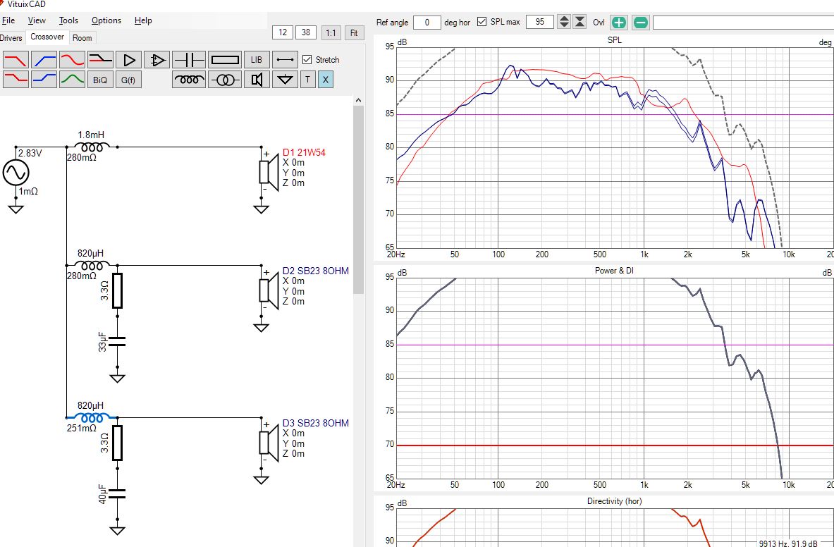

40uf would work fine. It's shown in the lowest navy row.I have the 3.3 ohm resistor but would a 40 uf bennic cap be ok instead of the the 33 uf one you suggest as i have it on hand

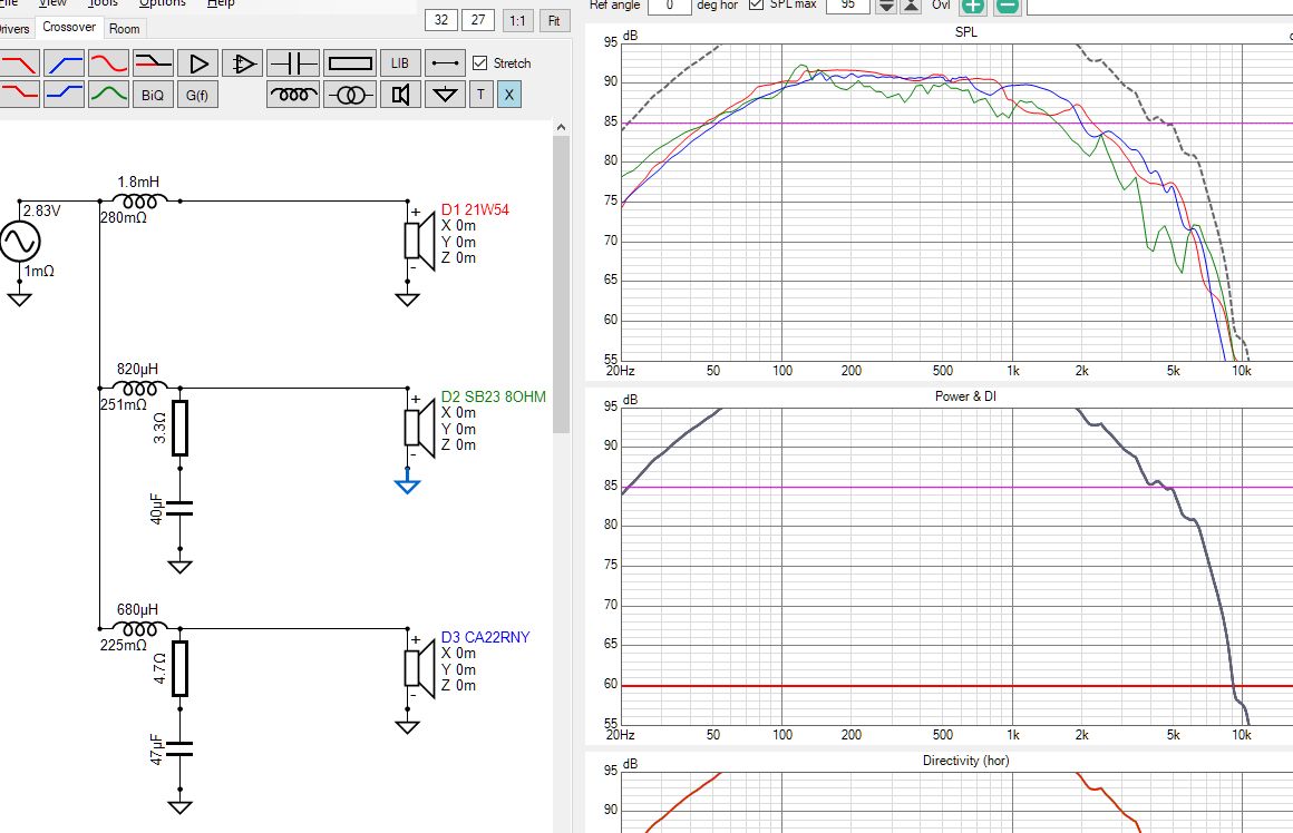

Out of curiosity, I tried @profiguy's suggestion of CA22RNY. It seems a great fit, with a more linear response 1-2khz than the Dyn, which shows a dip. It also has closer sensitivity to the Dyn than the SB23 8ohm, and its impedance plot copying this transfer response is ruler flat in the passband. 👍
Red=Dynaudio, Green=SB23, Blue = CA22RNY
p.s. did also look at Seas U22, but it's not as good a fit as CA22RNY (sensitivity too low 100hz-500hz).

Well that SEAS Driver really does seem like a great fit !.

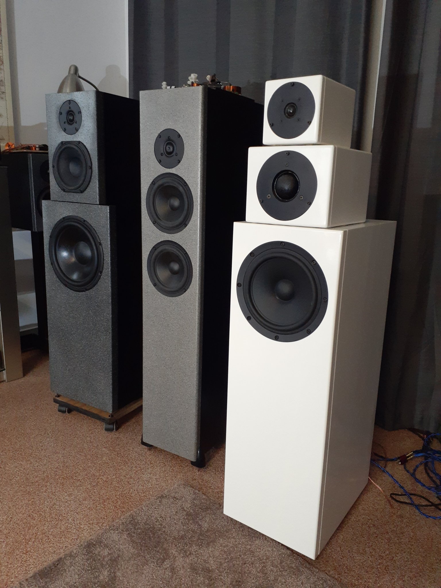

I wish i had known that before i purchased the SB 23 ( 4 Actually as i need 4 for my next project ) and have already made the front baffle to suit the SB 23 on the original DYN Cabs ( have posted a pic the white ones).

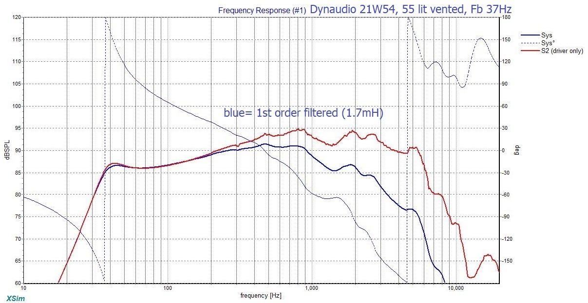

lojzek thanks for looking into this,That 700 hz xover point is just from there the supplied info i had but your modelling does obviously suggests otherwise. It seems even Dynaudio use simple 1st order xovers

Don't know the origin of this speaker/crossover design, but as @Lojzek indicates, even though it uses simple electrical elements, the acoustic response of each of these networks is not seeming to be truly 1st order. But if the speaker sounds good, then that's good.

V= square root of (impedance * power) here square root of (8 x 60) = 21.9v
Sim shows the driver can drop to 4ohm in the circuit. Put in whatever your amp is.
