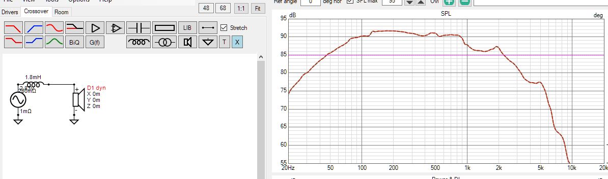

Hi. This reminds me of an exercise we worked on some time ago, where the frequency response of a known crossover was replicated with a substitute driver.
I did a quick and dirty from an old 21W54 datasheet and the SB23 datasheet.
This is roughly what the 1.8mh coil does to the 21W54 - very easy compared to modern drivers.
Editing for 8ohm version of SB23.
Reactions: AllenB

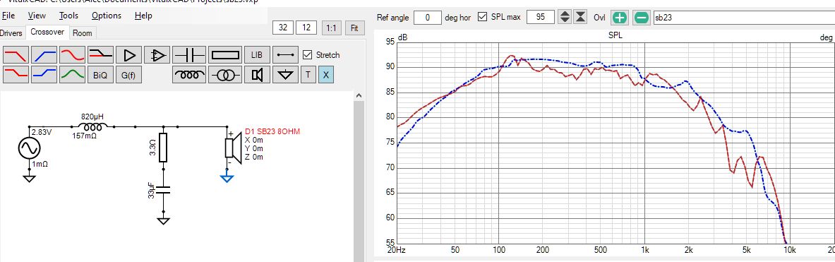

Sorry my internet went down.
Here's best I could do quickly with the SB23 8OHM. It is not as sensitive vs the Dynaudio and the 4ohm version. Can't do anything about that.
The cap and resistor both knock down the 1k spike as well as roughly tracking the original rolloff (navy colored line).
Maybe the Seas U22 would allow a closer 1st order rolloff, but hey.

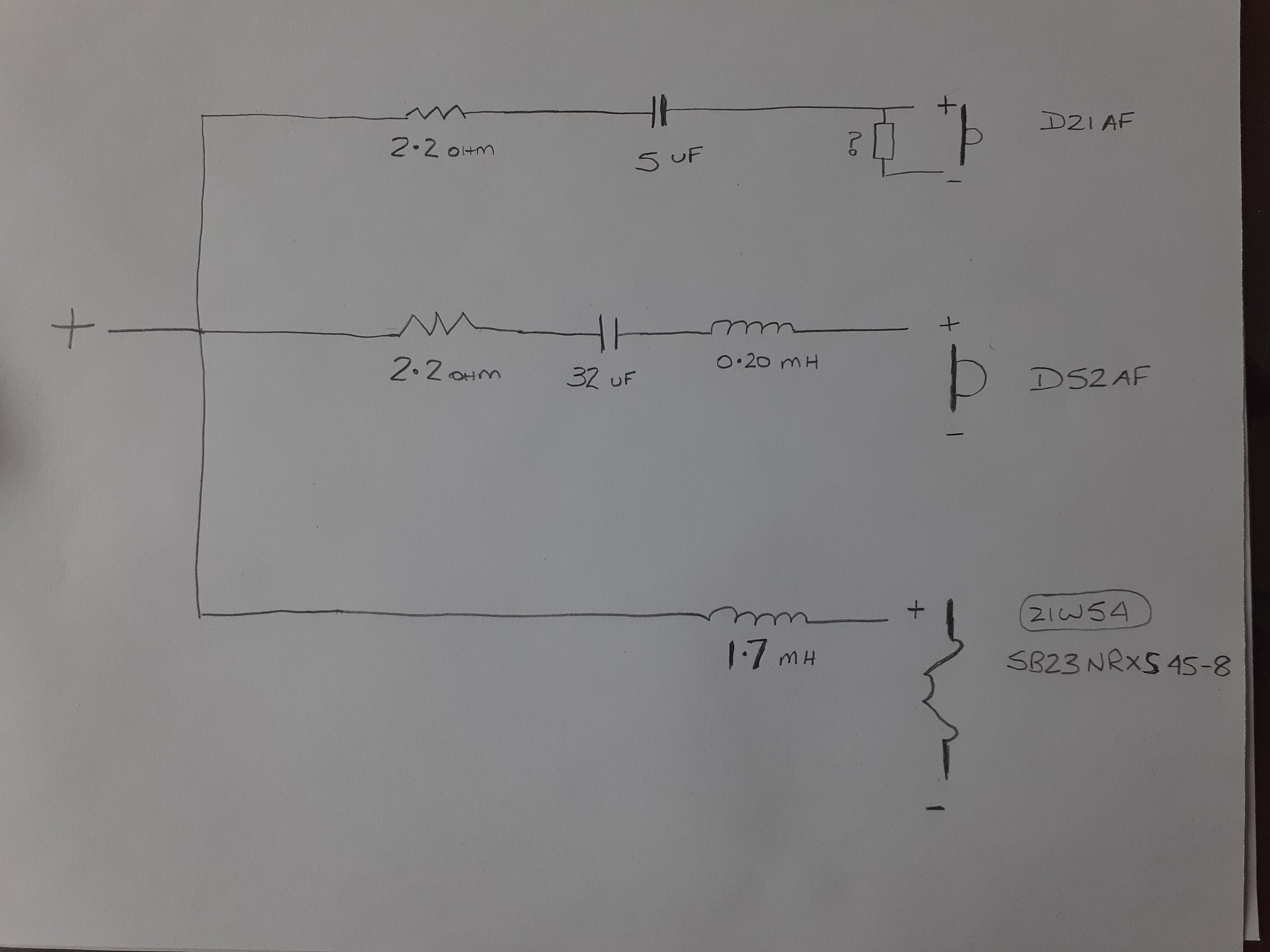

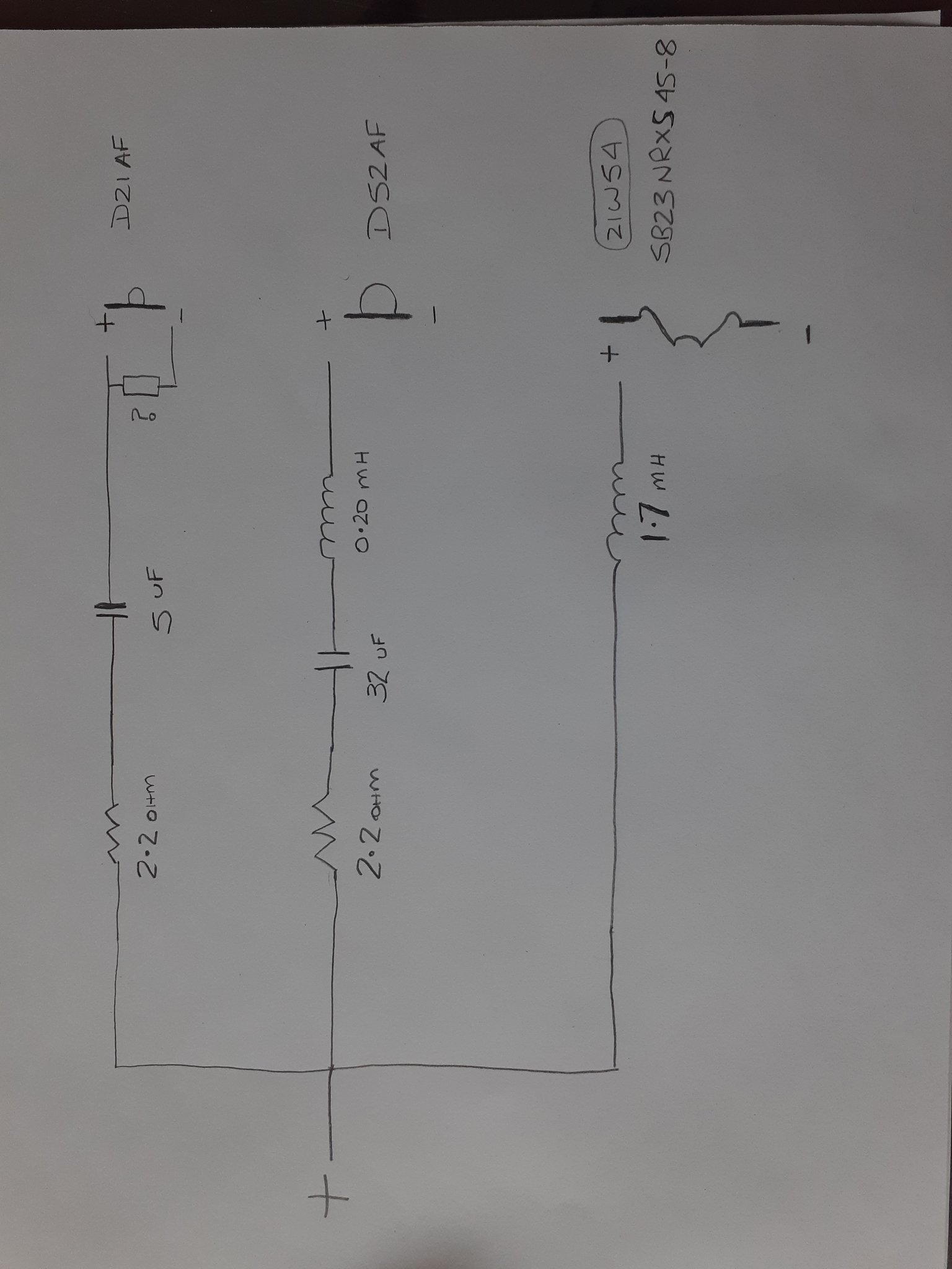

I am trying to find the schematic from the original paperwork other than that i will draw it and then post
One of the the 21W54 Bass drivers has a scraping sound now which sounds like distortion when playing ( Id say voicecoil )
As they are nearly 30 years i have refoamed them twice
Have taken x over values and and posted it

Hey motokok.
That simulation looks great
I have the 3.3 ohm resistor but would a 40 uf bennic cap be ok instead of the the 33 uf one you suggest as i have it on hand
