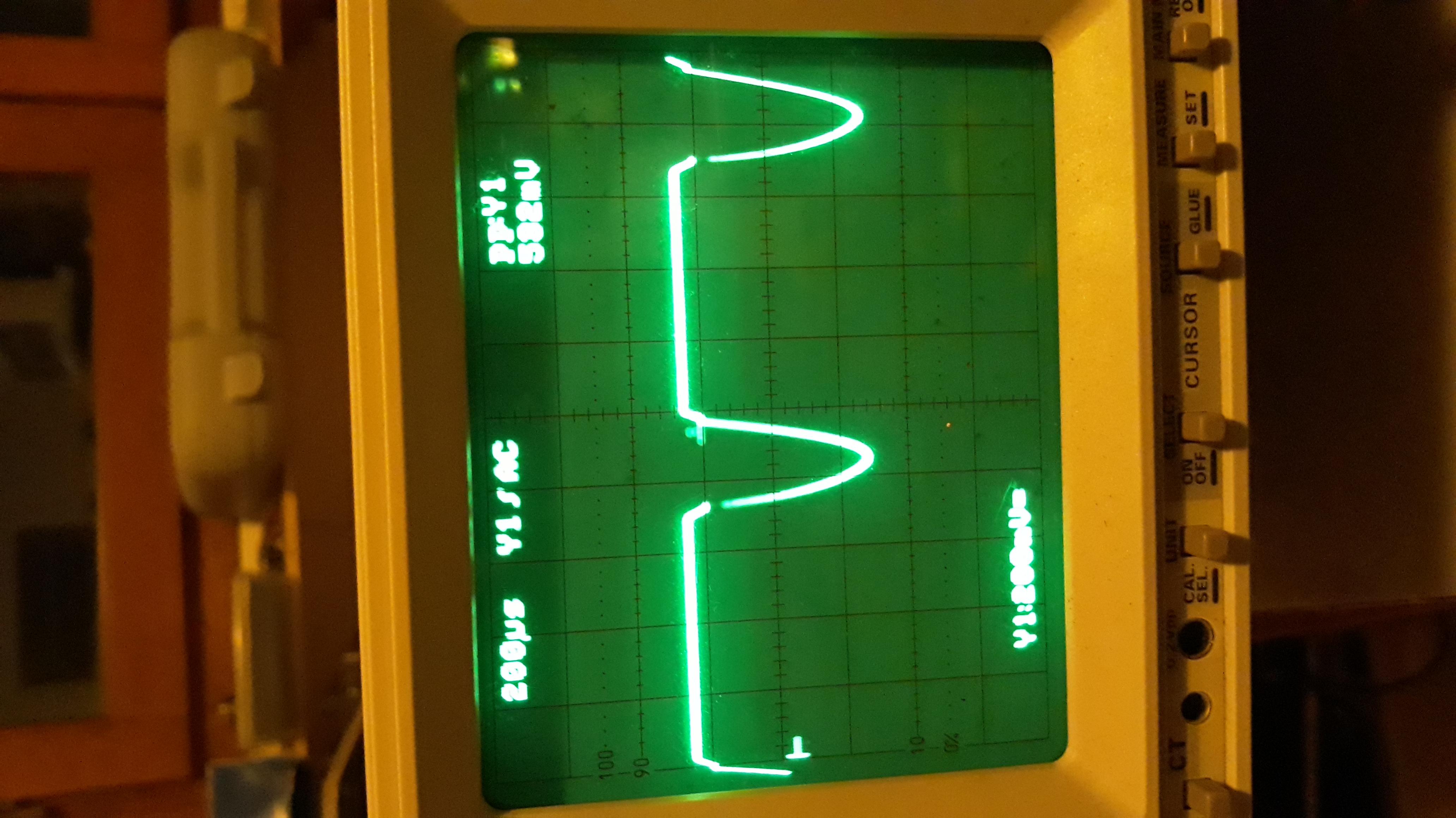

Yes I've tried turning VR201 (bias adjusting trimmmer) in both ways, and the voltage goes lower and higher than the preset bias voltage at power on ; on the left board as on the right one.
I've checked the signal going at Q211 and Q212 bases in each amp : on the left board, I can see a nice sine wave, and a something like a square wave on the right amp.

Concentrating on the bias issue for the moment, if you can raise the voltage across Q208 by altering the preset then you should be seeing the output transistors conduct and pass current. That increase in current will show as a voltage drop across the 0.47 ohm resistors.
The bias is a pure DC adjustment and as far as we are concerned does not depend on the stages before it. If you have sufficient voltage to bias those four B-E junctions into conduction then current should flow in the 0.47 ohms.
If this is not happening then you have a problem around the driver and output stage. There may or may not be other issues, but this lack of bias is something tangible that will respond to basic troubleshooting.

C201 & C206 have been replaced, and boths are the same quality as in the left amp : Nichicon muse and Panasonic FC. I've have double checked them and they are good.
I've checked the output when turning VR201 to have more than 2.4V : there is no change, whatever I turn it down to 2.1V or up to 2.6V ; ie I have something "troncated" at the output, and weaker than the input signal, PP. There is a pic joined showing the output taken at the load. Sorry, I don't know why the pic has turned, its correctly orientated on my computer.
The signal take at Q206 & Q 207 collectors looks troncated too

That looks like the upper driver/output isn't conducting, a problem that would give no bias and also still maintain a low DC offset like you have. It would also allow the vbe multiplier to generate a normal voltage.
