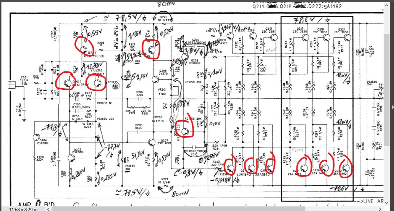

I'm an tube guy, quite old now. And I have some problems to understand complex SS circuitry (for me), as in DC coupled amps.
I have an old InterM Powered mixer (from 1985, 1635 model), which needed a power supply & amp board recap.
Once the cap job done, every preamp channel in the mixer worked fine. The left channel amp was OK too, but the right one sounded weak with a lot of distorsion. For me the sound is like earing a tube amp with a bad tube preamp's cathode decoupling capacitor.
I need some help to understand how this amp works, and where to look in order to repair it. I join boths schematics, with measured voltages.
I've checked every small transistors (desoldered) with a cheap chinese LCR meter, and they seem to be good. There is no blown fuse at power up, and no protection mode ie : the output relay closes on each channel.
A quick diode test on each power transistor (2SC3856 / 2SA1942) give the same results on each board, so I assume that they are not bad.
There is also the same output voltage on each board : 12 mV.
Every resistor tested OK, as with the capacitors, exept two on the right board : C202 100pF, Silver mica, and C208 50p, SM too. I replaced them, but the right amp is still weak and distorded. the diodes are all good too.
I'm not sure about the problem : a bias problem, a driver problem ? The voltages seems to be bad around this stages, and I don't see the +/- 0.5V bias voltage on the base of the output transistors.
I am able to repair simples SS amps, as soon as I familiar with the circuitry, but this one is a bit too complex for me ; I can't understand how the pnp differential amp works, for example...

Hmm... those diagrams are full of errors.
Many of the transistors are drawn incorrectly orientated. For example, Q201 and Q206 have the emitter and collector reversed. The same applies to all the PNP output devices. Emitter and collector are drawn incorrectly.
You can check the Vbe multiplier (bias generator) by seeing if the voltage across Q208 varies as the preset VR201 is turned.
Compare the voltage with the good channel. I would expect around 2.6 to 2.8 volts or so to be needed before the output stage conducts.
Low bias alone though would not give weak and distorted sound.
All the ones I have marked are incorrect.

As I said previously, small signal transistors in amps do not fail frequently. Television horizontal driver transistors run at 90% of rated power all the time, and the thermal cycles tend to cause those to fail after a defined number of years. Music has a crest factor of about 5%, amp transistors do not thermally cycle that hard, and except for output transistors that are damaged by speaker shorted turns ,shorted wiring or clogged fans, amp transistors don't fail much. Some designs have inadequate heat sinks on the output transistors for the rated wattage. Defective welds do happen about 1 in 10000000000, but resistors diodes & film capacitors have about the same failure rate from the same defect. I've small signal transistors from 1970 happily performing for 18 hours a day in my main amp. The hundreds of small signal transistors and signal diodes in my 1968 Hammond and 1966 Wurlitzer organs are all fine. Every key has 4 diodes in some transistor organs with 122 keys, and I know of ONE that a diode opened up after 40 years: Due probably to a bad weld. Exception little white Japanese transistors from about 1970, those were known dogs. So take data on where the failure is to find the defective part, don't shotgun replace transistors, diodes, resistors, or film capacitors. Output transistors are suspicious in amps that are set up and torn down at every gig, due to the many wiring problems, especially if 1/4 phone plugs are used for the speakers. Those get pulled out a lot, which causes a short. In amps, the b-e junction should be plus or minus 0.6 v depending on polarity, and the c-e voltage should be somewhere between 1/4 and 3/4 of the rail voltage. Frankly solder joints made by humans are more suspicious than the small signal transistors. There are always brands that exceed power current or SOA ratings on transistors, those design faults can cause failure. Drivers transistors are frequent candidates because the vendor is too cheap to install a heat sink.Anyway, I'm thinking of changing all the transistors, it will be quicker to repair, but I will not understand how this amp works.
I've taken & compared the Vbe of each transistor in boths amps.
I Join the schematic with measured voltages in the left amp (good one) ; above the schematic you'll find the measurements for the defective unit (right amp).
I'm not sure, but I suppose that the transistors Q209 / Q2010 & Q211 / Q212 are at least bad. Does they compose the driver's unit ?
And what to think about the output transistors ? Is it correct to suppose that their Vbe = 0V is due to the driver stage , or are they also defectives ?
Q209/210 are part of the protection circuit and can be removed from the circuit as a test. A good amp will function without them.
Q211 and Q212 are the drivers.
Power transistors usually fail by going short circuit and the fact you have got no DC offset at the output suggests they are OK.
Did you test the Vbe multiplier as I suggested in post #6?

If you have 400mv across the B-E junction of Q209/210 then you appear to have a very high bias current flowing. So something doesn't add up there. I suspect they may be another error in the circuit and that a couple of resistors biasing those protection transistors have been omitted.
Check the DC voltage across each of those 0.47 ohm resistors. There should only be a few millivolts across each.
No it's an error : the Q209 & Q210 voltages are both 40 mV and not 400mV.
I mean at the left & good amp. At right amp, Vbe for Q209 & Q210 is 0mV
And I've not testet yet Q208, the Vbe multiplier, because if the problem comes from another stage, I don't want to modify the bias voltage.
For the 0.47 Ohm resistors :
- on the left side there is something like 3.8 mV across each
- on the right side : 0mV ; so there is no current flowing through the output transistors on this side.
The Vbe multiplier is good on boths amps : as soon as I move VR201, there is a Vce change.
Vce of Q208 are : 2.35V on the left amp, and 2.325V on the right, at power on
