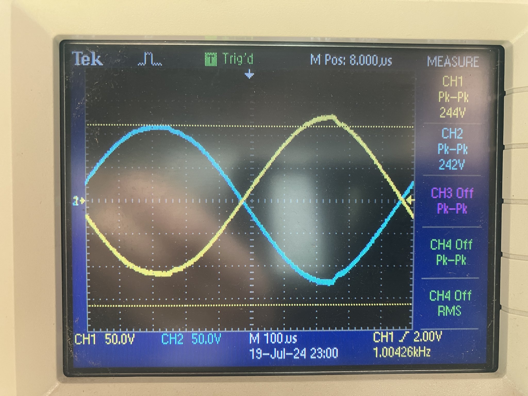

At the crest of the sine wave:
One tube's plate voltage is Much Lower versus the screen voltage;
While the Other tubes plate voltage is Much Higher.
Then for the opposite polarity at the crest of the sine wave:
The tubes change which plate is Lower, and which plate is Higher than their respective screens.
Interesting. I noticed that the step voltage on the plate aligned at the peak of the grid drive signal. I decided to try driving the amp with a square wave signal. All is revealed. See attached. Blue is grid drive Yellow is plate voltage. There is massive ringing on both the rising and falling edges.

Wow!
Are both plates giving the same large overshoot?
That is important to know.
You disconnected the negative feedback, Yes or No?
During testing, you are using a Non-Inductive resistor across the 8 Ohm secondary tap, Right? . . . Not a wirewound 8 Ohm resistor.
Perhaps a couple of series RC Snubbers will overcome the large overshoots. Plate 1 to center tap, plate 2 to center tap.
I do not normally care for snubbers. Usually a Band-Aid at best, with additional tradeoffs.
Perhaps a different output transformer will give a better response, you need one to try it on one channel, just to verify the possible cause of the problem.
First I changed the grid stoppers to 10K, soldered with short leads to the tube socket. No change, still the ringing on square wave and step at the peak of the sin. I dug out the schematic from the RCA Victor V301 radio phonograph and found in the original design they have 0.0025 MFD from the plate of each output tube to gnd. I am attaching the schematic. These guys were near genius back then I figure. Everything was practically new territory. I suspect it may have something to do with the design of the OPT. I did the same and the problem is solved. Everyone - thanks for your assistance.
Not so fast. Snubbers problematic. I had really bad ringing when I tested the amp with square wave input. Initially I tried snubber capacitors from plate to ground on the output tubes. It didn't work very well. Sensitive to input frequency and loading with 'scope probes. What did work was changing the feedback from pure resistance to an parallel R-C network, such that feedback increases with rising frequency. I may have been a bit heavy handed, the rolloff starts at about 10kHz, but the square wave response is now just slightly underdamped with a very small overshoot that recovers nicely. I'll post a photo later. At my age I don't hear much above 10K !

Find out if the full kink happens when the Plate is reaching maximum voltage or when the Plate is reaching minimum voltage. Maybe the Plate is getting too low and hitting Ground?
This is a key test.
If the kink occurrence is at minimum plate voltage....
Watch the output tubes G1 voltage relative to the cathode voltage when the kink happens. If G1 has stopped being negative relative the the cathode voltage when the kink happens then the output tube is full saturated and has no more current to give. Clipping is now happening.

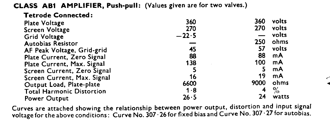

Just to make that visually clear, please take a look at the second graph of the following 6L6GC data sheet:
6L6GC.pdf
I hope that is enlightening.

Since ARTA is free download, I thought it would be interesting to see how this amp performs, 1) given that the OPT is very limiting, and 2) seeing that the ringing problem with square wave input has been resolved. I ran two frequency response and distortion tests. First test at 1 watt and second test at 5-3/4 watt. The I/O "sound card" was one of these $5 USB dongles about as big as your thumb with a 1/8 in headphone and microphone jack. I should have run the test "loopback", to see the performance of the dongle itself. Next time. Results attached. Distortion is significant at the higher power test, especially below 100 Hz. I didn't try to calibrate the I/O. I just made sure that ARTA's meters did not indicate an overload on the microphone input.
The transformer does look to limit the low frequency power a lot as 5.75 watts from basically a pair of 6L6 with a 440 volt rail is a little low on power.
Good it is self bias to help protect the output tubes as the peak current in the transformer will be very high at low frequencies as the transformer saturates.
If you are still getting about 18 watts at 1Khz then over all considering the transformer used you seem to have done well for your efforts.
