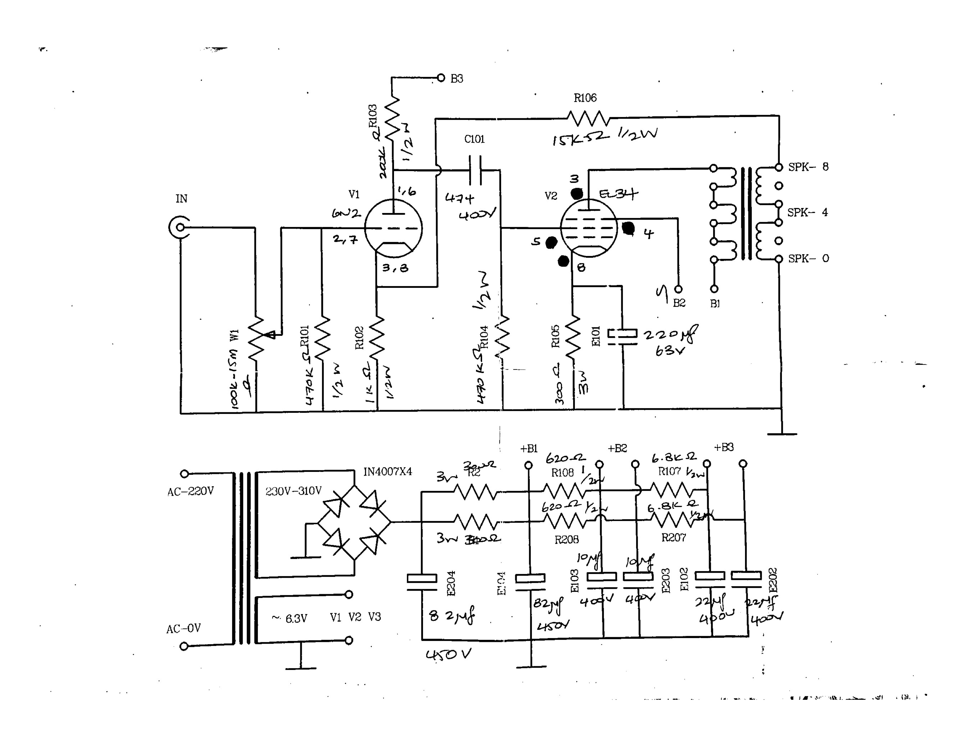

I recently purchased a douk audio 6N2/EL34 tube amp kit to dip my toes in the world of tube power amplifiers. It arrived, and I built the kit, however there was absolutely no sound from either of the output transformers. I (probably retrospectively should have looked through the schematic and tested the PCB, but waiting nearly a month for shipping and my eagerness got the better of me). When I did sit down to crunch the schematic, it seems like there are some unusual things happening around the power stage for a single ended amp (in comparison to the other SE EL34 schematics I was referencing). I was hoping you good folks could take a look and see if there are any major errors in the design of this. I tested all of the resistors and capacitors before building the PCB and they were in spec. Just wanted to verify that there were no design errors before I went ahead and bought some replacement tubes.
Quick note: on the schematic, I have written in pen what connections to the tube sockets the PCB traces had using a multimeter set to continuity, but comparing it to a normal EL34 data sheet it looks like the socket may not be wired correctly.

Check the voltages on points B1-B2-B3 + and indicate the values.
check EL34 pin 6 ... if B1 is missing you must make two jumpers on the primary also check the voltage on pin 1 and indicate the value
Indicates the voltage present on points 1-6 + 3-8 of 6N2 ...
On the secondary it checks if there is no jumper between 4 and 8 ohm.
Take a photo of the assembly and the transformer TU

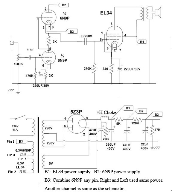

Thank you all for responding. I thought it looked a little off from the datasheet as well. Gheo23, was that a successful amplifier design? I might just take all of the components that were shipped with this kit and follow another schematic if someone can attest to it working well for an SE amp.

<<Gheo23, was that a successful amplifier design?>>
Not necessarly.The internet is full of different schematics and this is one of them, a good one I presume, but my advice, pay atention on output transformers.This is a real problem in SE amplifiers.
Wrong wiring is found in the power stage:
EL34's Pin 1 is for the suppressor grid and Pin 8 is for the cathode.
Pin 6 is for nothing. The plate is actually Pin 3.
In this circuit you've used grid 2 as the grid 1, which requires driving current and cannot be driven by a single 6N2.

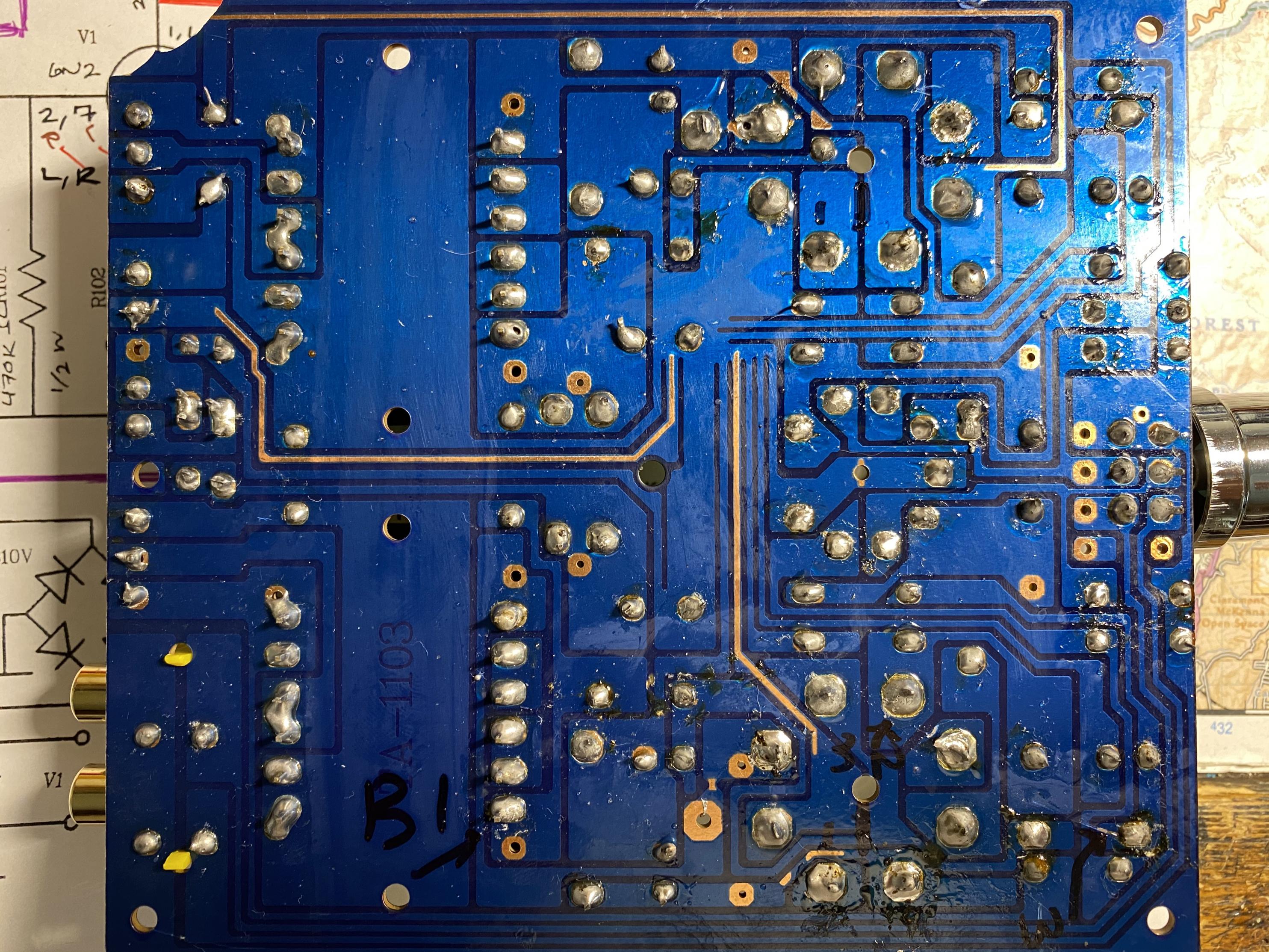

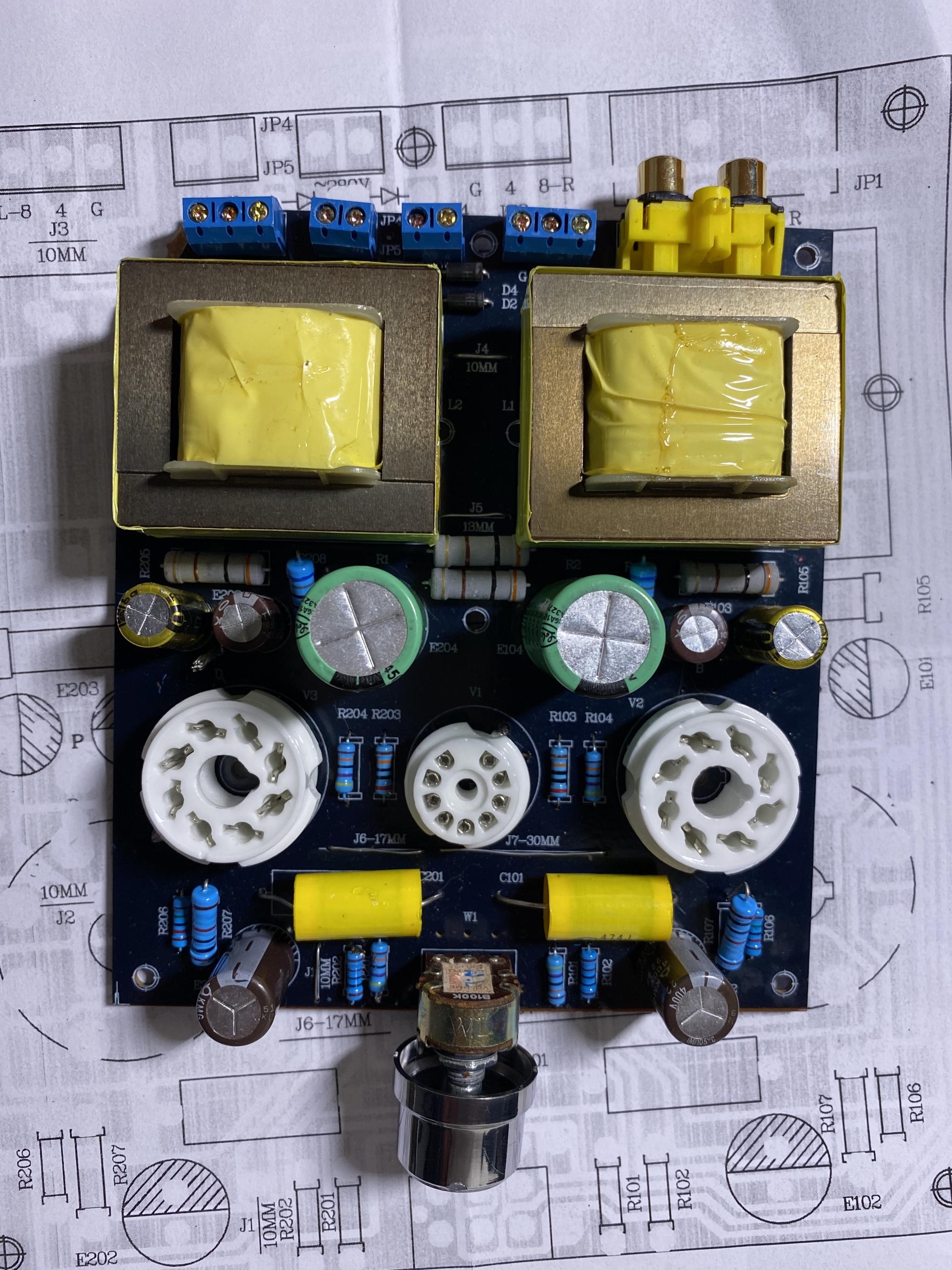

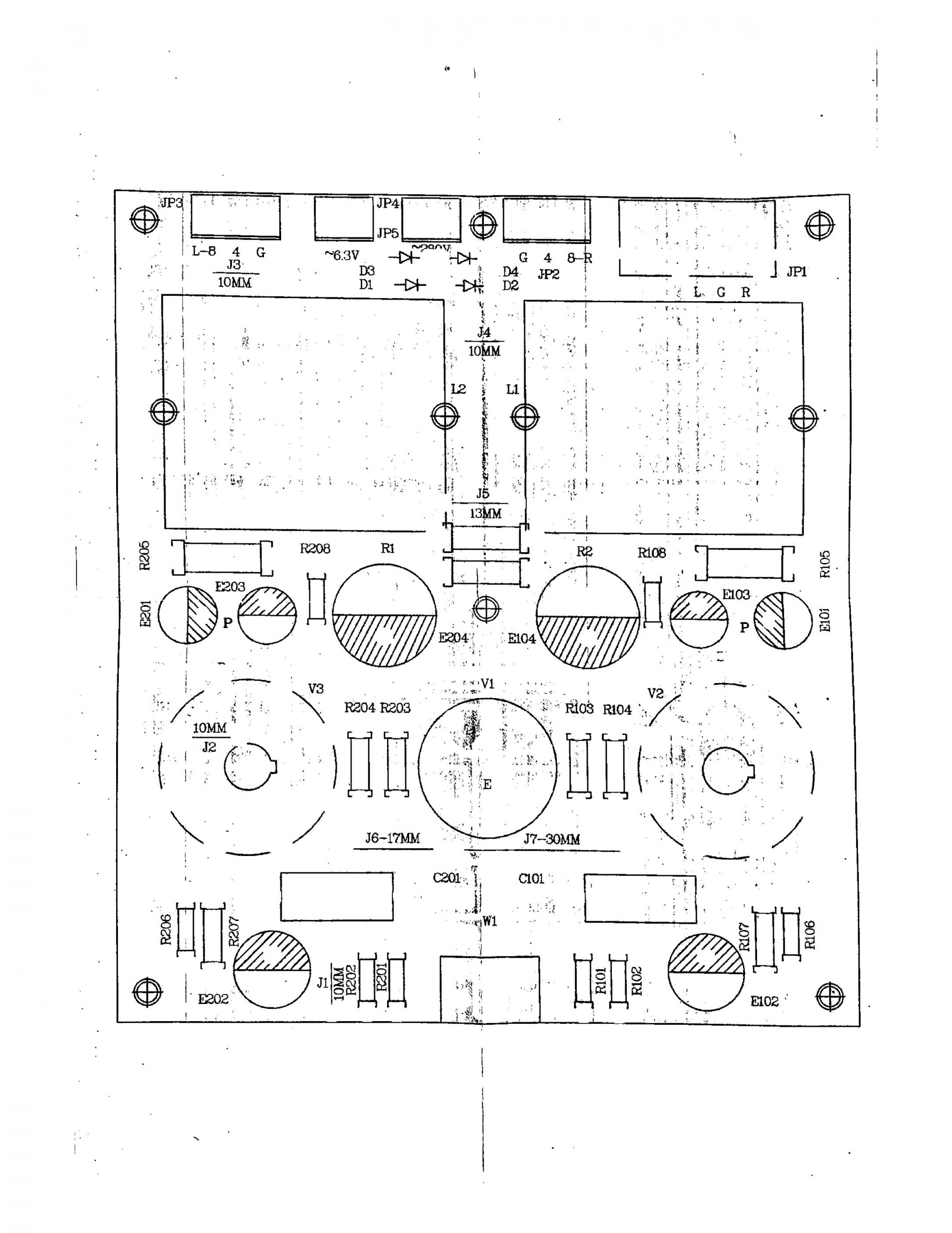

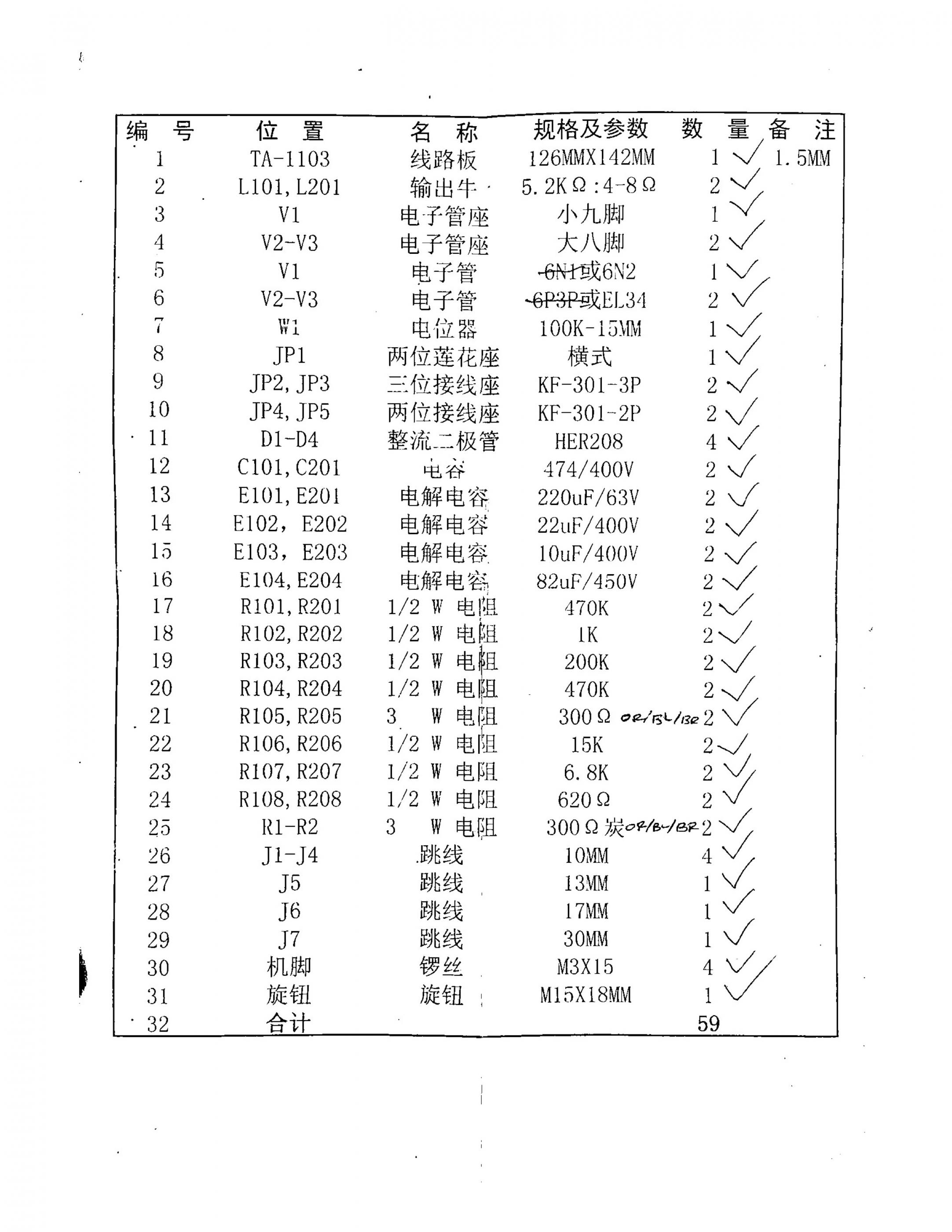

I finally got a chance to start testing my board. First of all, I'd like to mention that I did count the EL34 sockets wrong and they are wired up correctly on the PCB. I've got pin 3 as the anode, pin 8 as the cathode, pin 5 is audio in from the preamp tube and pin 4 is connected to the B2 power supply. The power transformer that shipped with the kit has two taps on the HV side, I measured 330VAC and 262VAC with 120VAC wall current. The heater supply voltages both hovered around 7.1V. I went ahead and connected the 330V side to the board without the tubes installed in the sockets to test the B1/B2/B3 voltages and found something interesting - there were 428VDC flowing across E104/E204 for the B1 supply, 413VDC flowing across E103/E203 for the B2 supply and just over 400VDC flowing through E102/E202 for the B3 supply. I connected the 262VAC transformer tap and got the following voltages through the supply points - B1 at 357.2VDC, B2 at 356.2VDC and B3 at 354VDC.
I'm not quite sure I understand how the voltages can increase like that, as the diodes are arranged as a rectifier on the schematic and not a voltage doubler. 400-440V seems to be at the upper limit of the caps that were supplied in the kit.
I attached a picture of the PCB and the other papers that came in the kit, along with a copy of the schematic with updated socket pin numbers.
