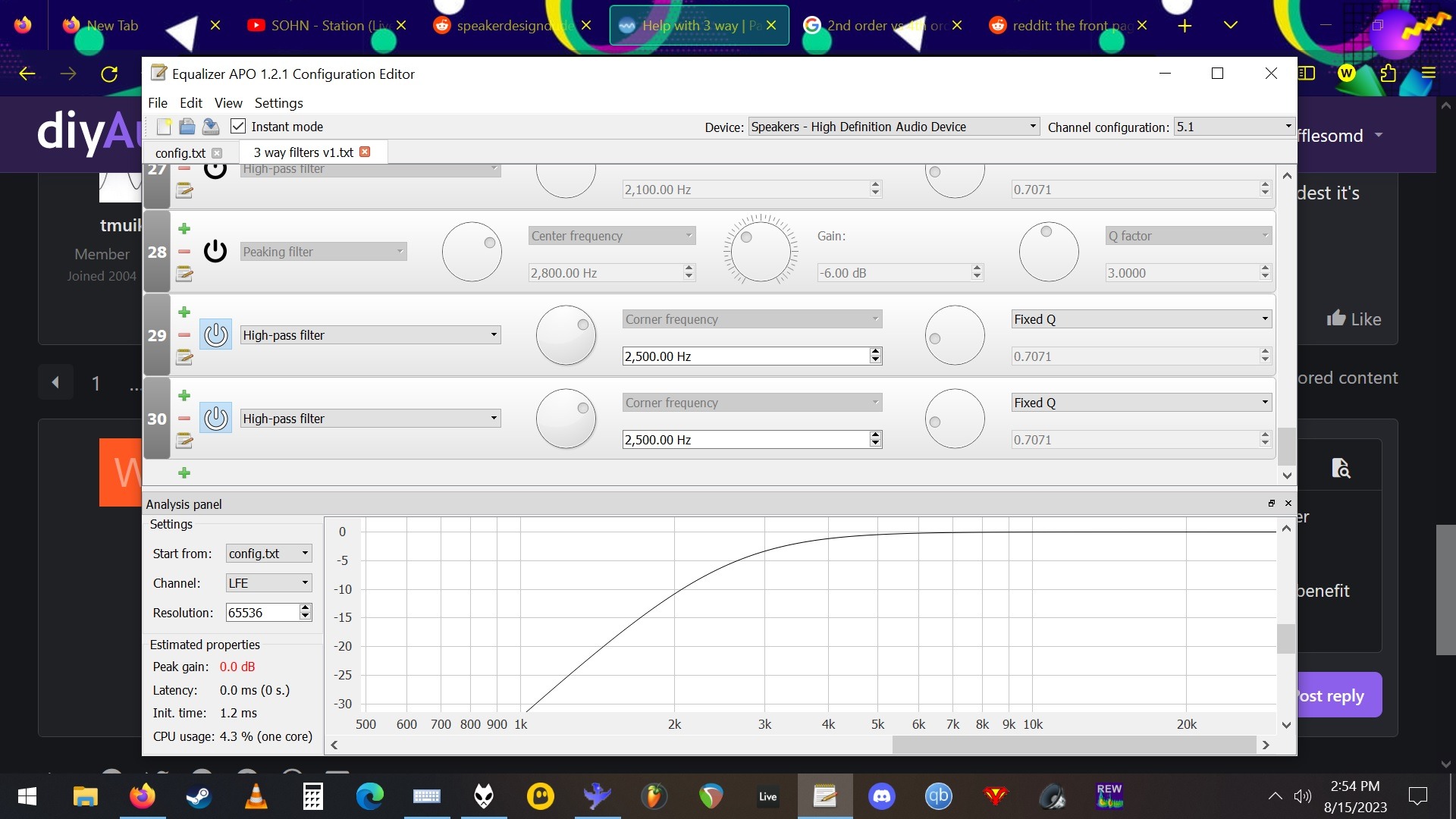

Been looking around but does anyone know the filter orders for EQ APO's high and low pass filters? To my eyes it looks like one filter results in first order 6db slope, and stacking another gives you 12, but not entirely sure.
Using two filters per HP and LP task seems to give me pretty good looking response in the real world, but curious if there would be benefit to using fourth order filters. The ND25FW doesn't seem to be complaining with two filters.
This is what the slope looks like with two 2500hz hi pass filters in EQ APO

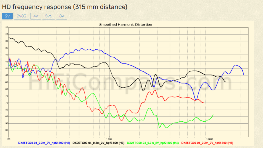

You may need to upgrade your tweeter. The DX25 has quite a high odd order distortion profile:
Courtesy / credit to hificompass:
https://hificompass.com/en/speakers/measurements/vifa/vifa-dx25tg09-04
compare with my current experiment (SB Acoustics SB26ADC) - which has similar T/S params. This is at a slightly higher voltage to offset the nominal 2dB sensitivity difference to try and be fair:
