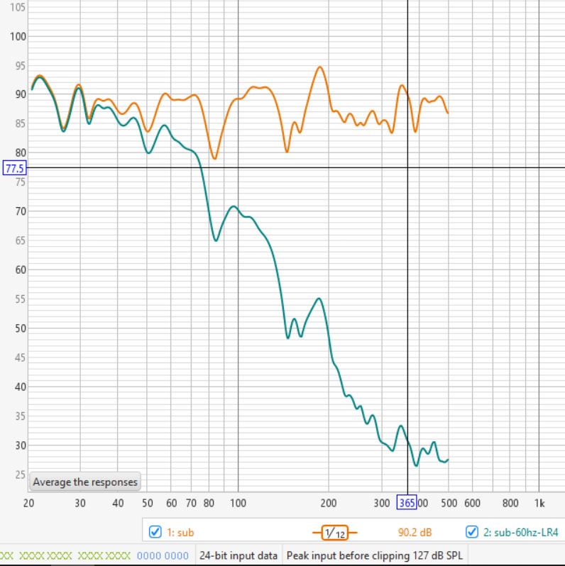

Had some time today to work on PEQ of the subs.
I decided to try positioning the mic 9' from the midpoint between the speakers which are 8' apart. Front baffle of 521 clones are 5' from wall behind. The sub baffle is 4' from wall,1' behind the 521 baffles, in between the 2.
Signal to the sub is L+R
Sub EQ (in miniDSP 4x10HD):
1. 35Hz peak, 2.2Q, +15 dB
2. 58Hz peak, 3Q, -7 dB
3. X-over: 60Hz LR4
4. Level: -4 dB
The graph below shows sub and sub w/ 60Hz LR4 (green)

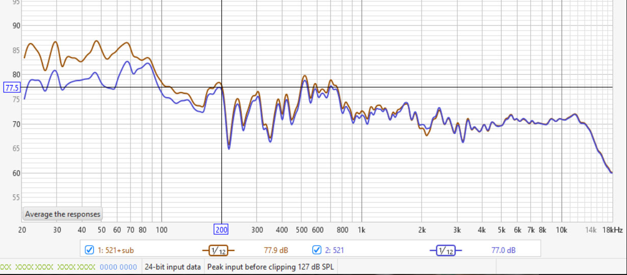

As mentioned before, using the single sub as true sub with the LX521 clones (LR4 low pass to sub, LR4 high pass to main) is not beneficial. Instead, LR4 low pass was applied to the sub & run concurrently with the LX521 with its level reduced by -4 dB.
The curves below shows LX521 and LX521+sub. The latter ends up with the bass level too high. I need to reduce the LX521 bass level below 60-70Hz by 4-5 dB to get a better total balance so it better shares the bass load with the sub to reduce distortion.
