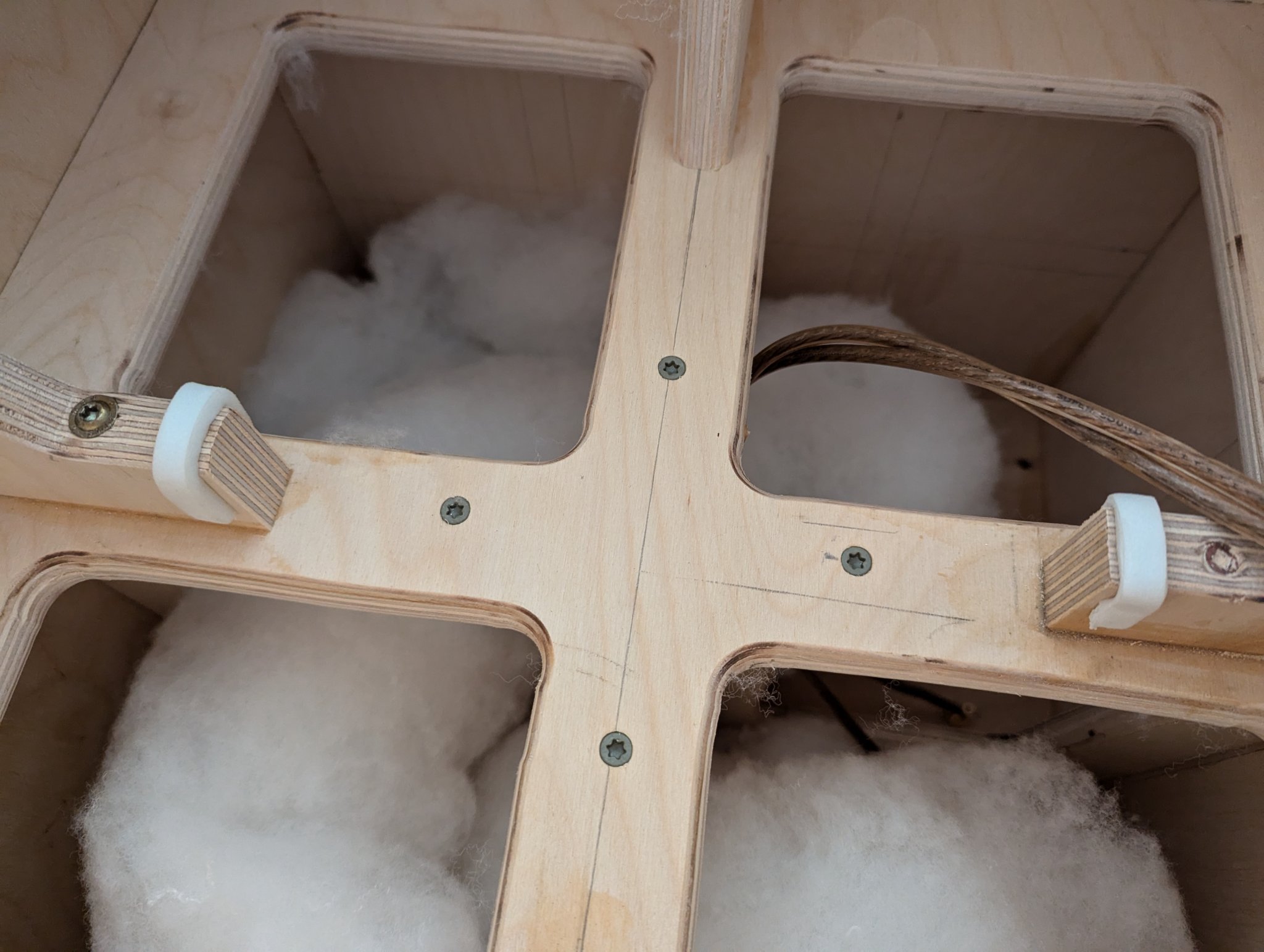

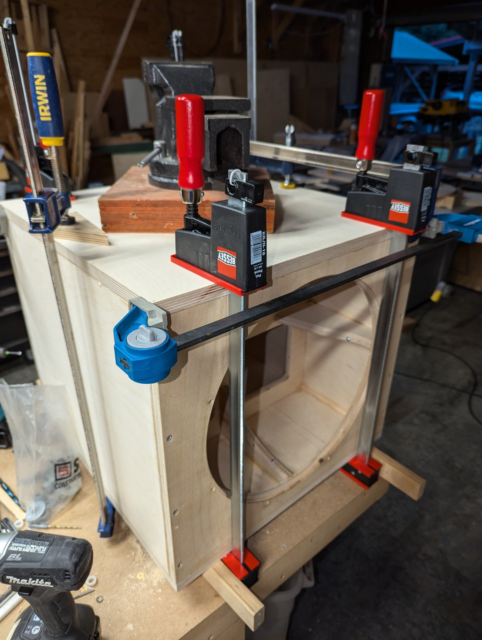

Does anyone have a different opinion on whether/what/how much acoustic damping should go into a subwoofer box? About to seal this one up & would rather not open/close again. Only opening is through the driver hole.
Last 2 panels glued, screwed, clamped. Glue was a bit dry, but I used lots. Should be ok if I leave it long enough.

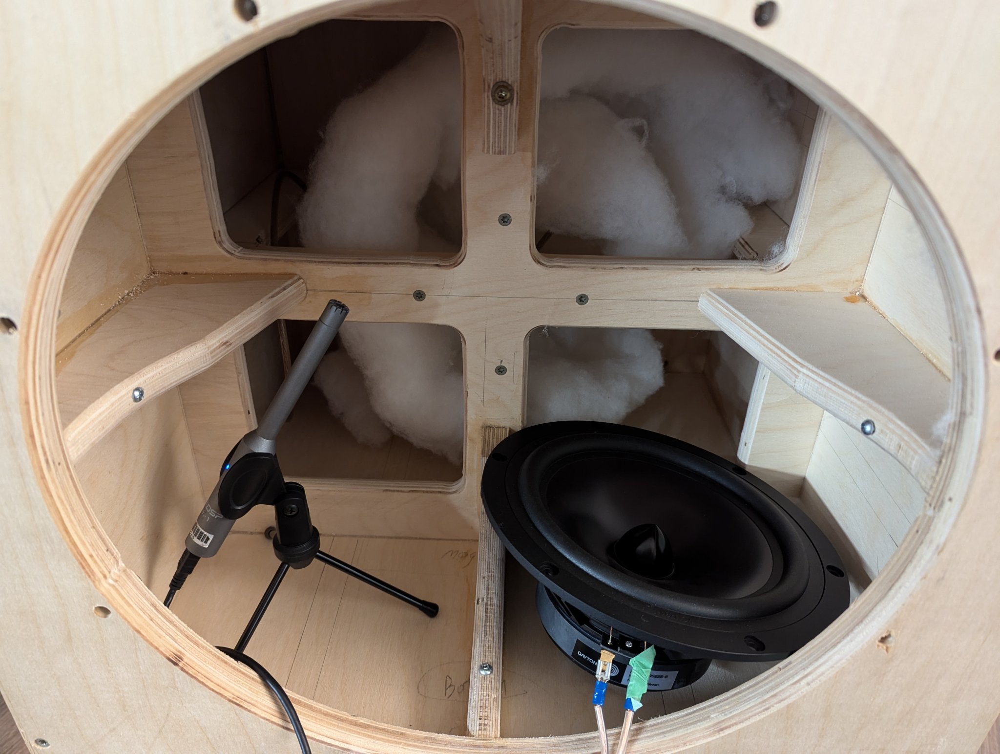

Will measure air resonance of the box tomorrow and try a bit of lambs wool, see if the amplitude lowers. If not, empty it will remain.

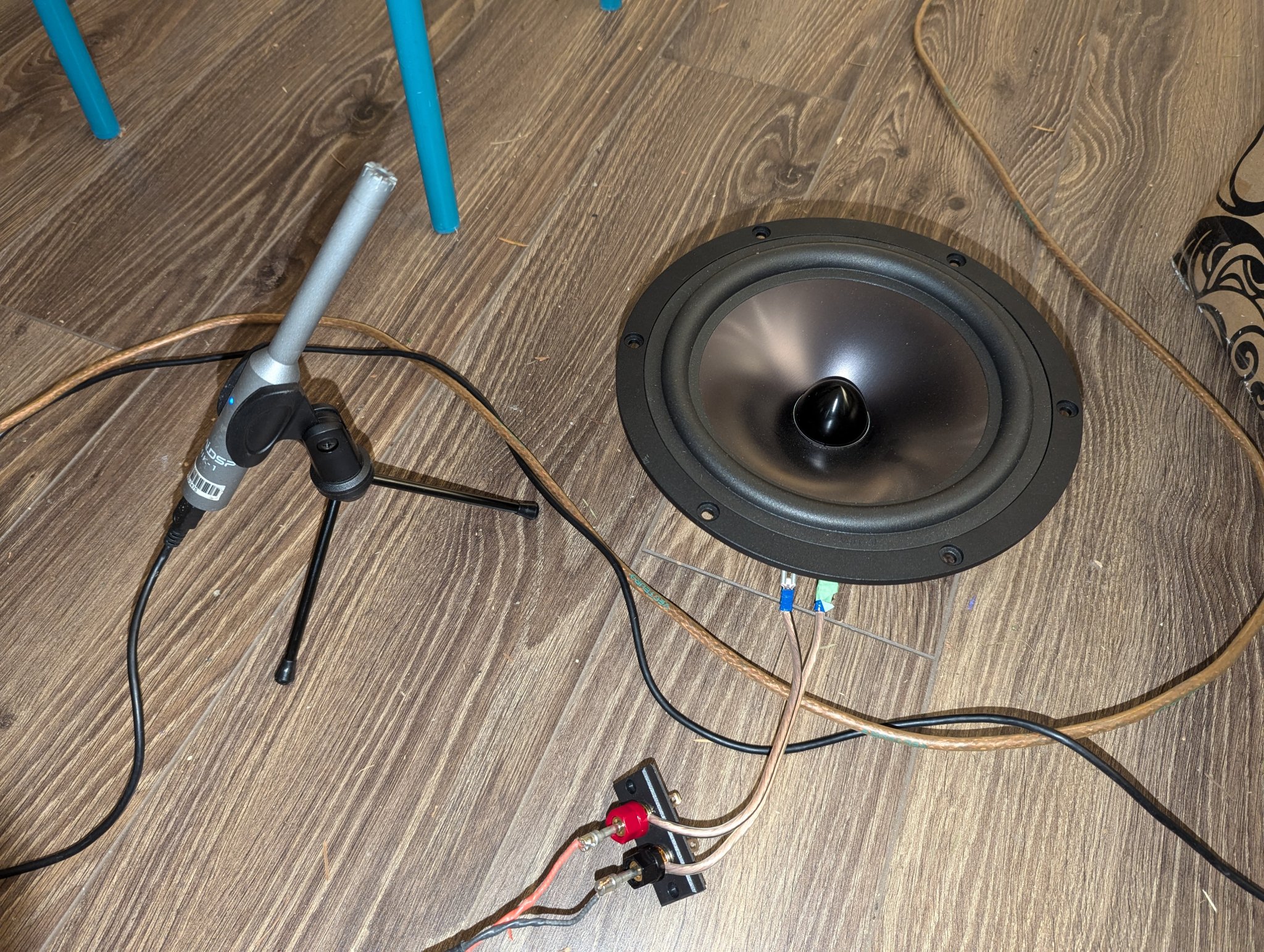

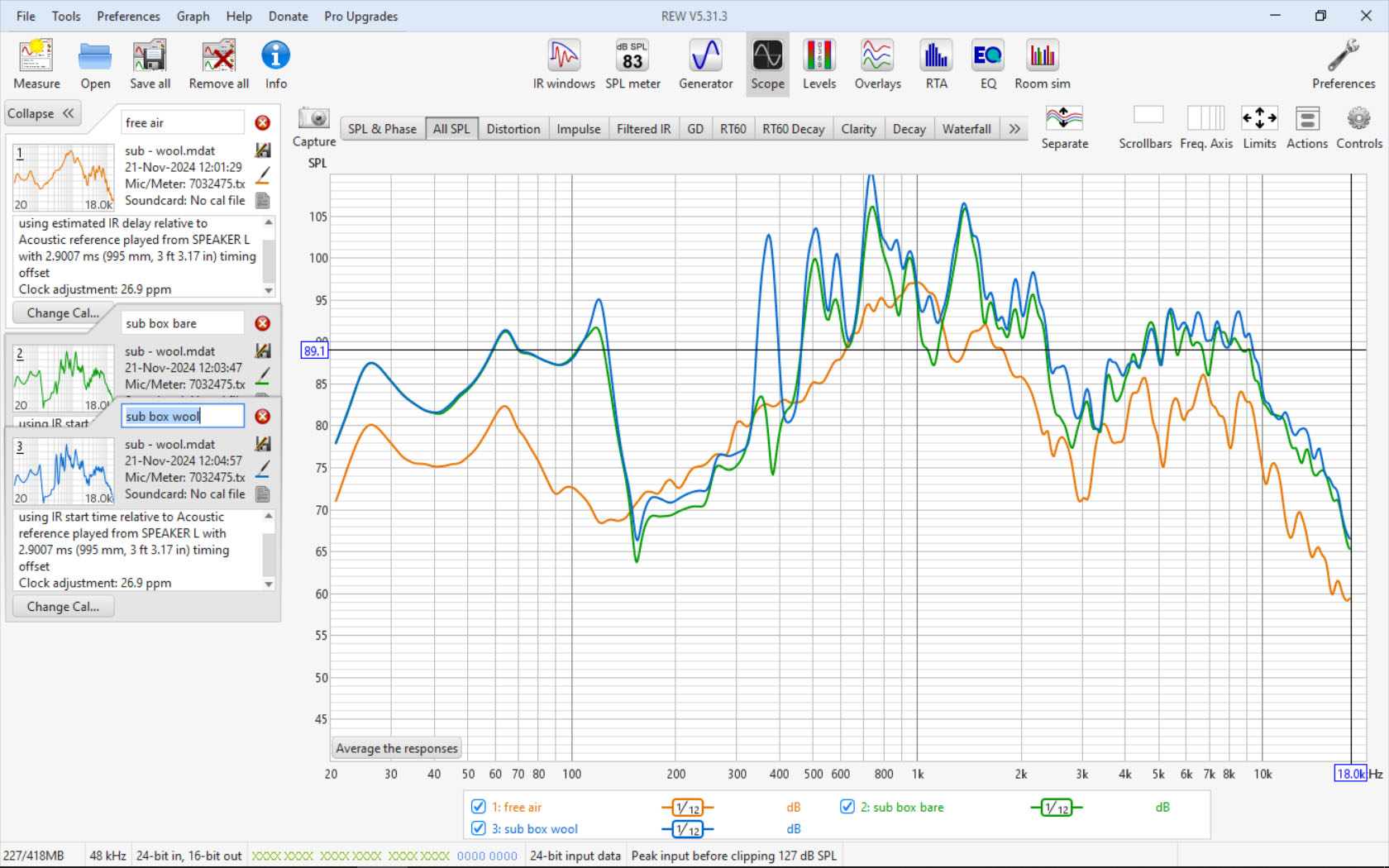

So I made an attempt at checking the air resonance in the sub box. Stuck an 8" driver in with UMIK mic, ran sweeps with & without half the box filled with a light wad of wool.
There seemed to be some reduction of spikes, including one around 120Hz, so I just left the wool in there for now.
I was too impatient to add any more wedges to go between the back of the speaker & the braces. I did add a strip of foam to damp the mechanical contact.

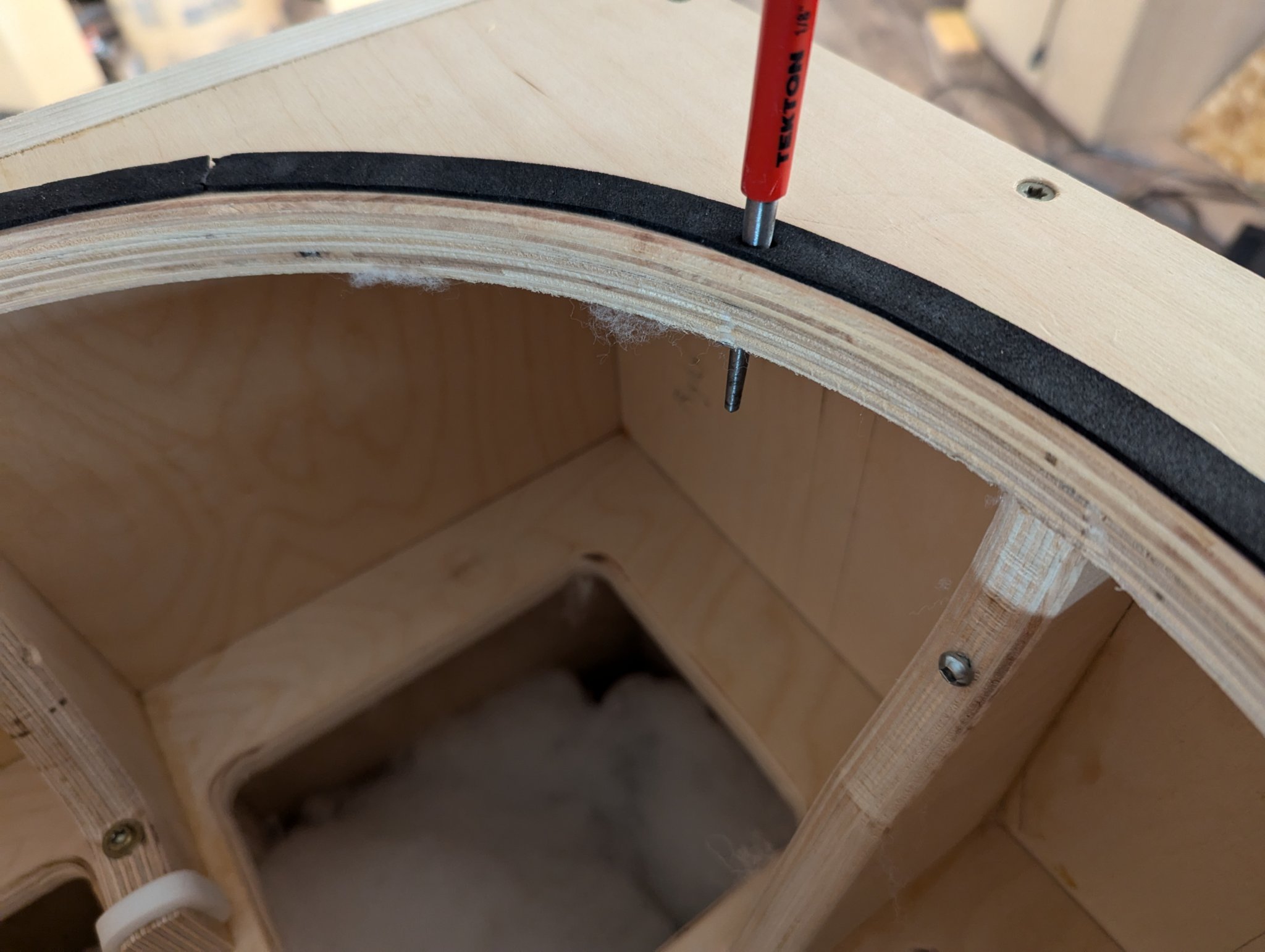

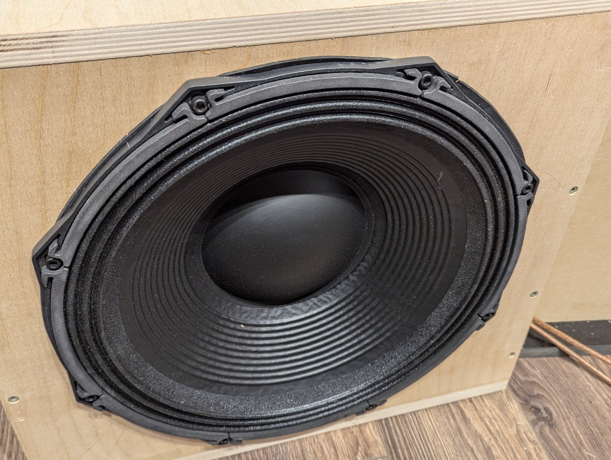

The thin rather dense gasket strip provided with the SBA 15SW800 was applied. Holes poked for the bolts. Some of the gasket foam caught in the threads of the bolts & T-nuts, but it wasn't a problem. Bolts tighten by hand to a bit beyond finger-tight.
yellow line: 8" driver (Dayton RSS225) on floor
blue line: 8" driver in bare box
green line: 8" driver in wool box

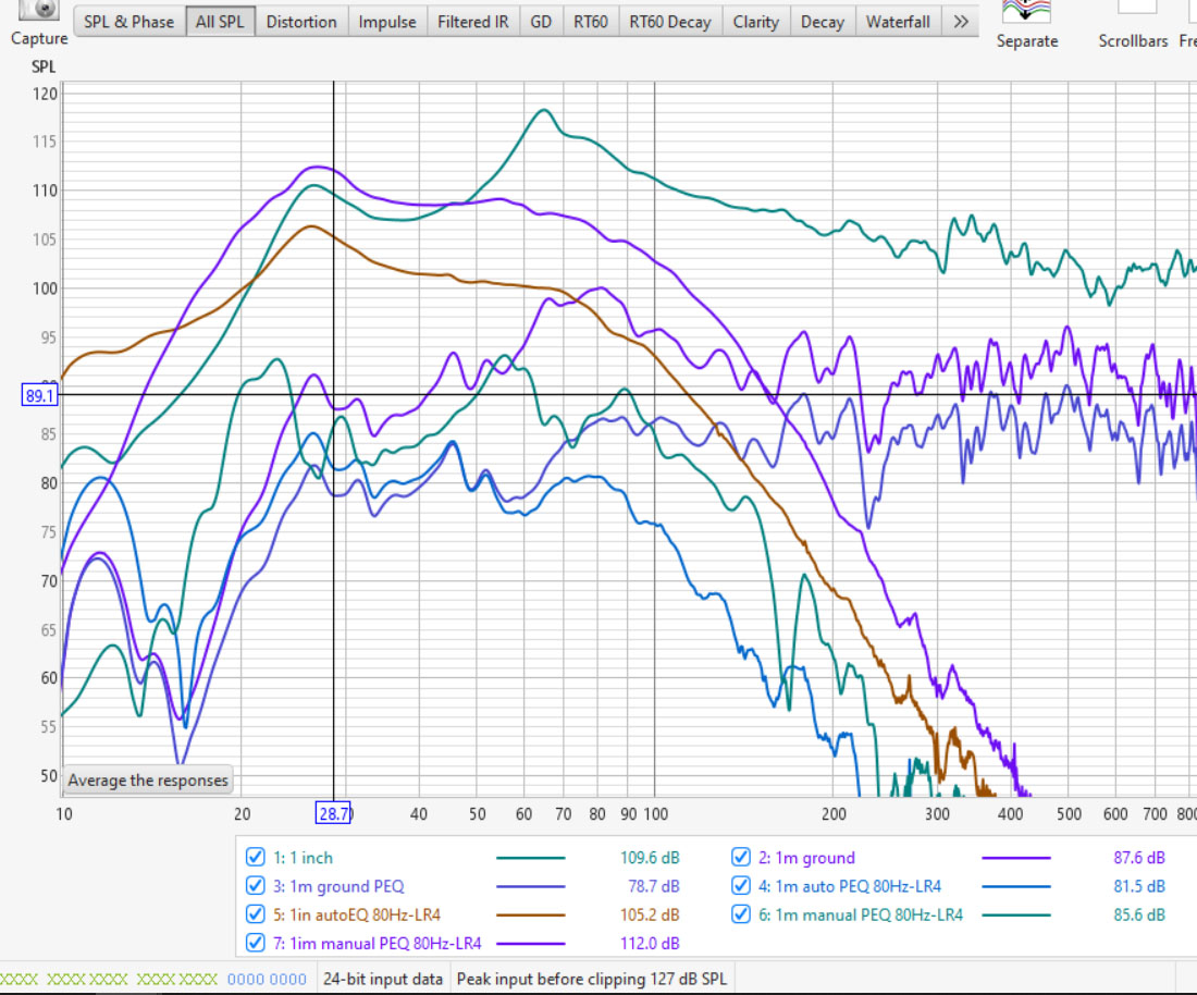

Test with Dayton DATS v3 showed the Qts dropped about 0.1 compared to when the driver was enclosed by the sonotube. It's now 0.45 compared to 0.54. This probably means the box is bigger; maybe it's the bit of wool inside. Fs is virtually unchanged -- 54Hz.
REW sweeps --
The first sweep was 20-2K with the mic an inch from the dust cap.
2nd sweep 20-2K 1m away with mic on the floor.
3rd sweeo 20-2K 1m, after PEQ (based on REW's auto-EQ) in miniDSP 4x10HD
4th sweep 20-2K 1m, after auto EQ with 80Hz LR4 on miniDSP 4x10HD
5th sweep 20-2K 1 inch, after auto PEQ with 80Hz LR4 on miniDSP 4x10HD
6th sweep 20-2K 1 inch, after manual EQ with 80Hz LR4 on miniDSP 4x10HD

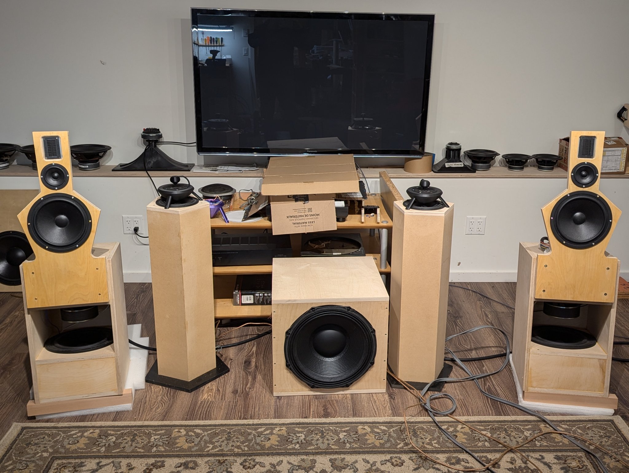

Listening confirmed that my LX521-clones have bass about as deep & extended & powerful as the single SBA Nero-15SW800 in the 2.8cf box. There was an audible benefit with selected heavy bass/drum tracks when the sub was run parallel with 70Hz LR4 low pass.

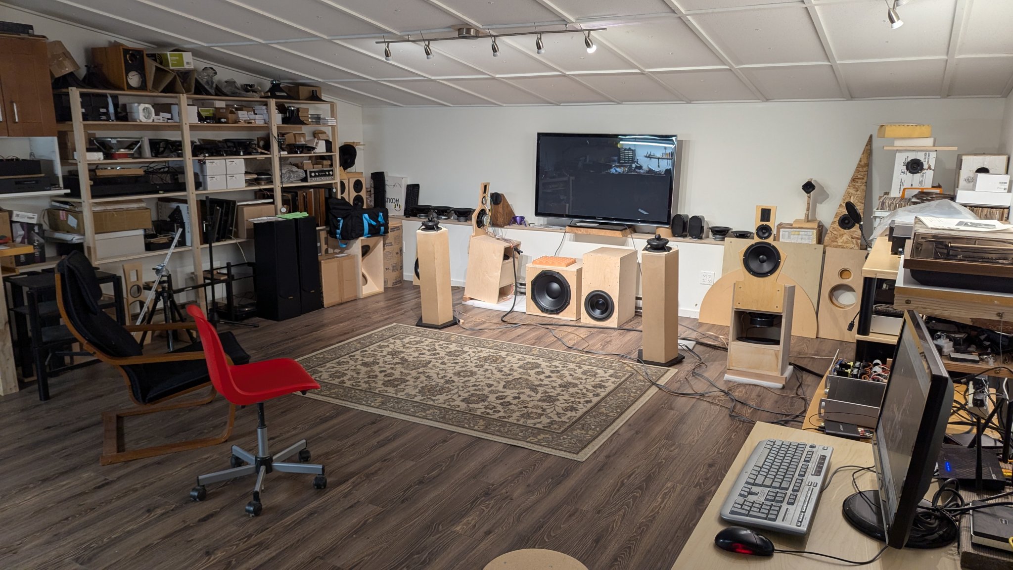

By far the best speakers I've built, but never heard them outside my studio.

A couple days ago, several friend came over to see & hear creations that they hadn't heard yet. Their reaction was that the LX521 by itself has great balance & presentation & bass, and switching to the sub w/o the LX521 bass was not better, probably worse. We tried the sub as an addon coming in at 60Hz LR4, and that made no difference except on tracks where there was bass down low. Then it made a subtle & powerful difference, adding drama and more ambience.
The sub's best showing was when it was brought in at 80Hz to a pair of omnidirectional speakers using 6.5" woofers which are surprisingly good to ~40Hz, even at fairly high volume, say 95 dB. The omnis were well received by themselves, it's really easy to accept their presentation, which seems unusually "natural" for many listeners. But adding the sub totally filled out the sound.
I cleaned up the studio for the first time in who knows how long. One benefit of having guests over, even friends. 😉

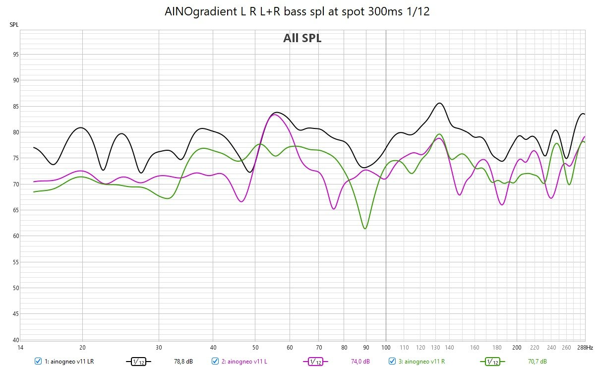

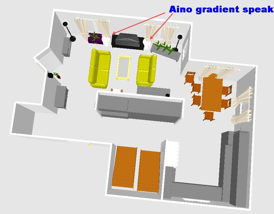

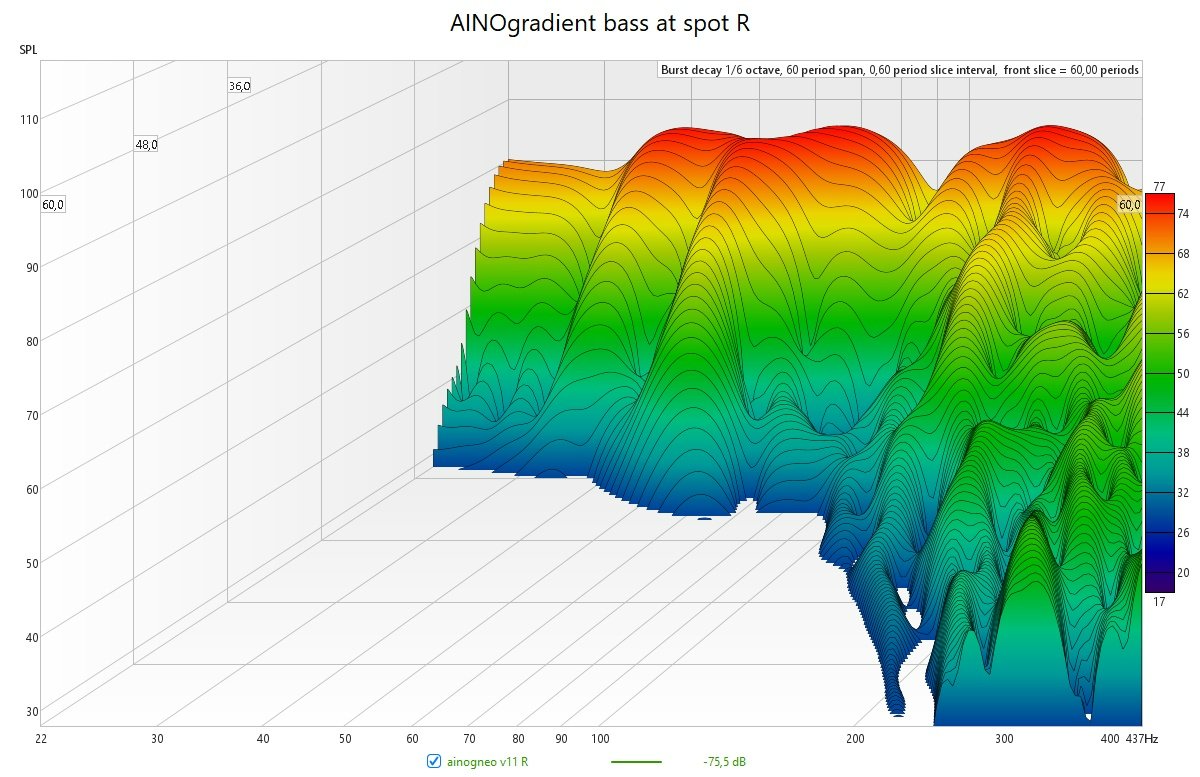

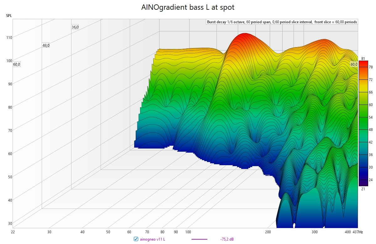

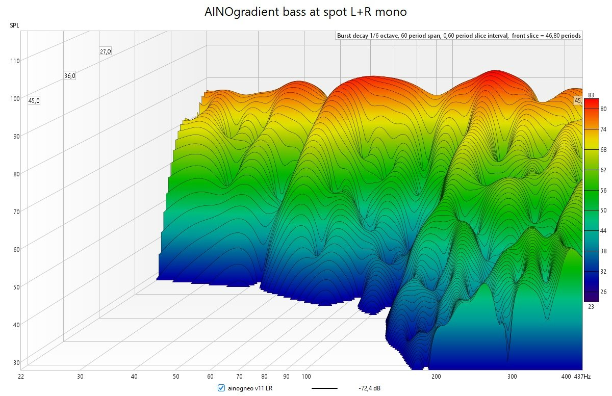

My main setup is at our living room, so separate sub(s) are not practical. This was one point for making 4-way stereo speakers with sealed subwoofers. I had to go back ten years to find measurements with both speakers playing at same time (mono test sweep) Speaker placement is dictated by esthetic and practical reasons, not by measurements and the room is asymmetrical. Speakers are along the long wall.
ainog bass burst L.jpgainog bass burst LR.jpgainog bass burst R.jpg Olohuone 1.jpg
