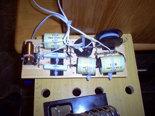

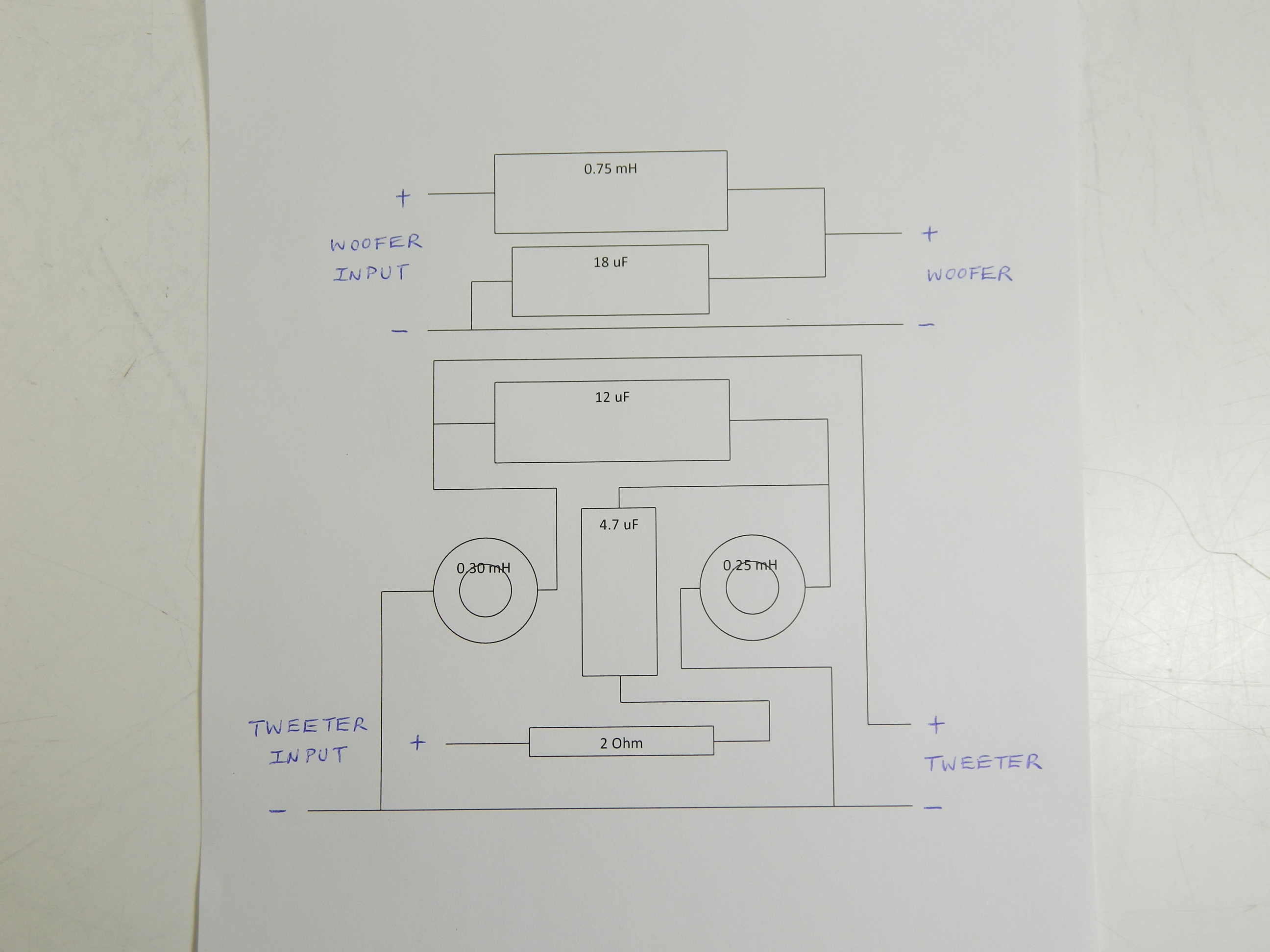

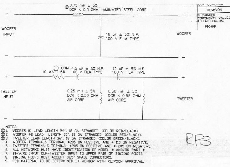

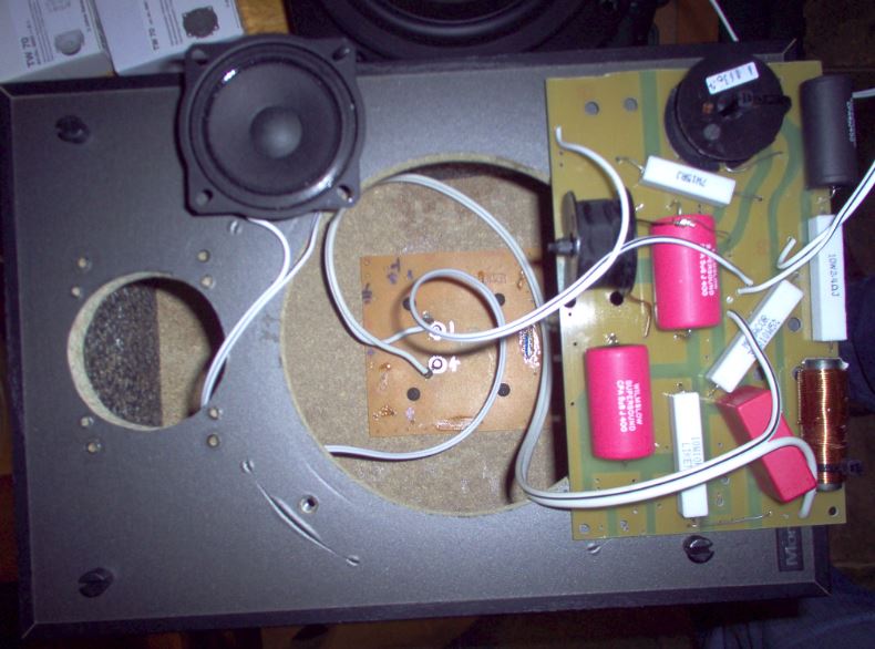

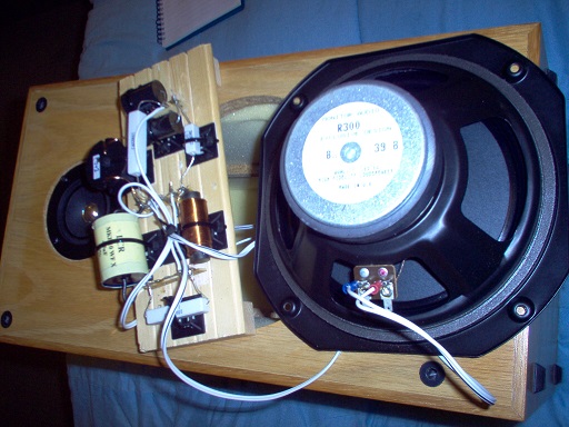

Help wiring my Klipsch RF-3 ii crossover
So I upgraded all the caps to some nice Dayton caps, the resistors are Mills high quality ones. Should I upgrade the inductor and coils?
Changing coils makes a larger difference than changing caps but you need to have a lot of room and a lot of money. So the simple answer is no for now. there is great debate about this with proponents on both sides. Take small steps so you know what you have done sounds like.
How it works, blake, is that baked (non-vibrational) air coils are about as good as it gets. 🙂
Once you add high inductance values and ferrite cores, they get a bit less than ideal. It's to do with magnetic hysteresis. Which is a non-linear effect.
Your tweeter coils are really just fine. 0.75 mH ferrite bass coils would probably work better as air coils. That's not a high value or particularly non-linear. So give it a go anyway. I woudn't expect too many problems.
You could doubtless find a 0.75mH air coil easily enough. But that's perfectionism. 🙂

So I wouldn't notice a big difference by replacing them?

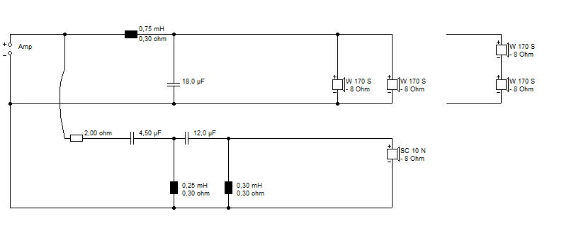

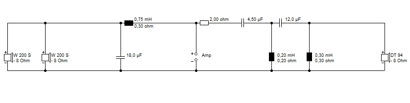

The bass coil would best be a 0.75mH baked air coil IMO. Especially if you use more complex tank notches, the 15R and 0.47uF which knocks out some cone breakup at 7kHz here, which have a tuned effect and highish Q. But it's small. And a bit of coil resistance is accounted for in the crossover and cabinet.

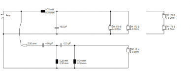

I do these sort of 4th order LR4 filters myself on occasion. TBH, the weaknesses are more in the cheap drivers (Visaton W200S bass and mylar DT94 tweeter) and the vaguely tuned port here. That's where I would throw more cash down the road.

So I have finished the RF-3 II towers and the RS-3 ii surrounds so far. (Just gotta do the center now) My god... The difference is just incredible! They are entirely different speakers now!! Now I'm really excited about changing out those tiny little inductors!
