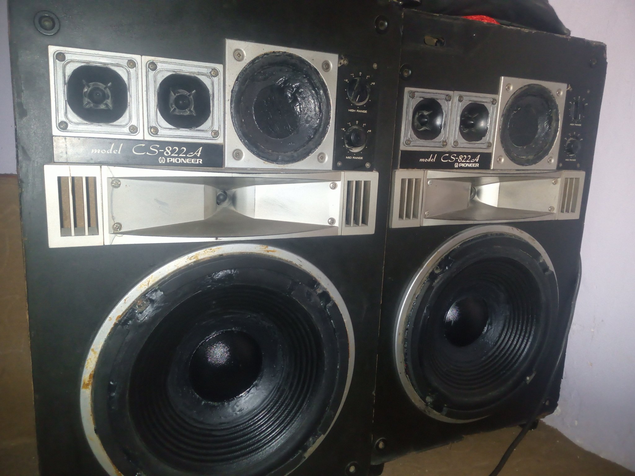

But I Use 12inch Speaker pair In my room I Made The Vintage Amplifier My Self And Design a Active Op Amp Tl072 Bass Treble Circuit for It It Sounds Good
But Bass Is Too Low I Just Want to
Increase Bass for shaking speakers

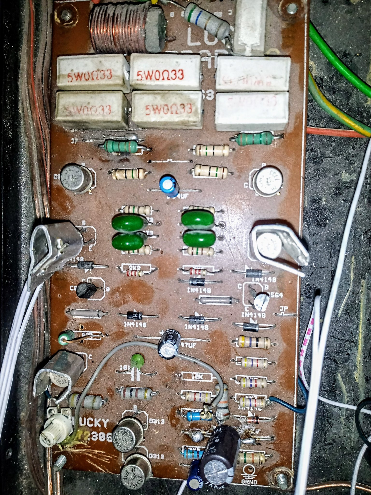

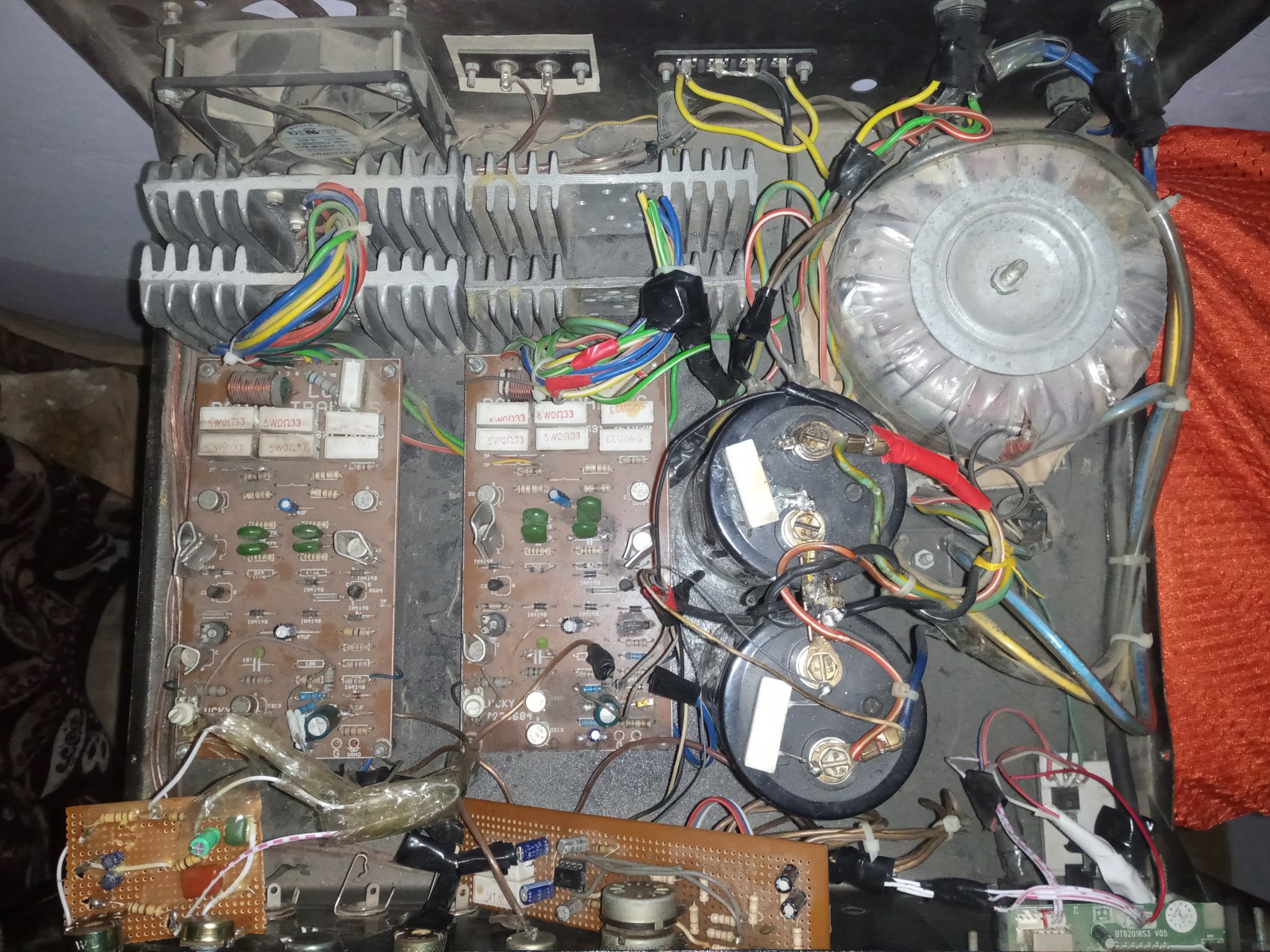

Thanks And I Am Using Tpa 100d Amplifier with tone controller based on op amp I send you some pictures of my amp..
