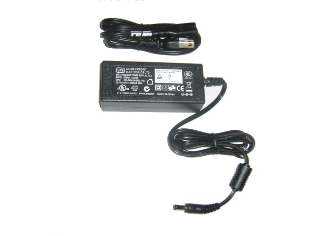

Um, isn't the supply that stand alone pictured above?

Now you've shown us the PSU is a switcher I'm going to stick my neck out and say that's probably your limiting factor as regards sound quality. There's no sign of any passive filtering of its output (beyond a couple of bog-standard electrolytics) whereas I'd have liked to see chokes. There's also no CM choke on the DC input, just a couple of small Ls which could just be ferrite beads. The Linear Tech datasheet says the LT1370 is a 500kHz switcher - electrolytic caps as used in the picture don't have great ESRs at such high frequencies - ceramics would be called for. Are there any components on the reverse side?

From reading through the LT datasheet for that part, its very much a design for high efficiency. For that it needs fast edges, and fast edges mean a filtering nightmare. Its quite the opposite of what we'd want for audio - LT has some great app notes detailing low noise switching supplies. At the very least it needs serious output filtering and potentially re-regulating with linear regs. At best it should be totally replaced with a linear supply - after all the power demand is not high based on your pic of the PSU brick.

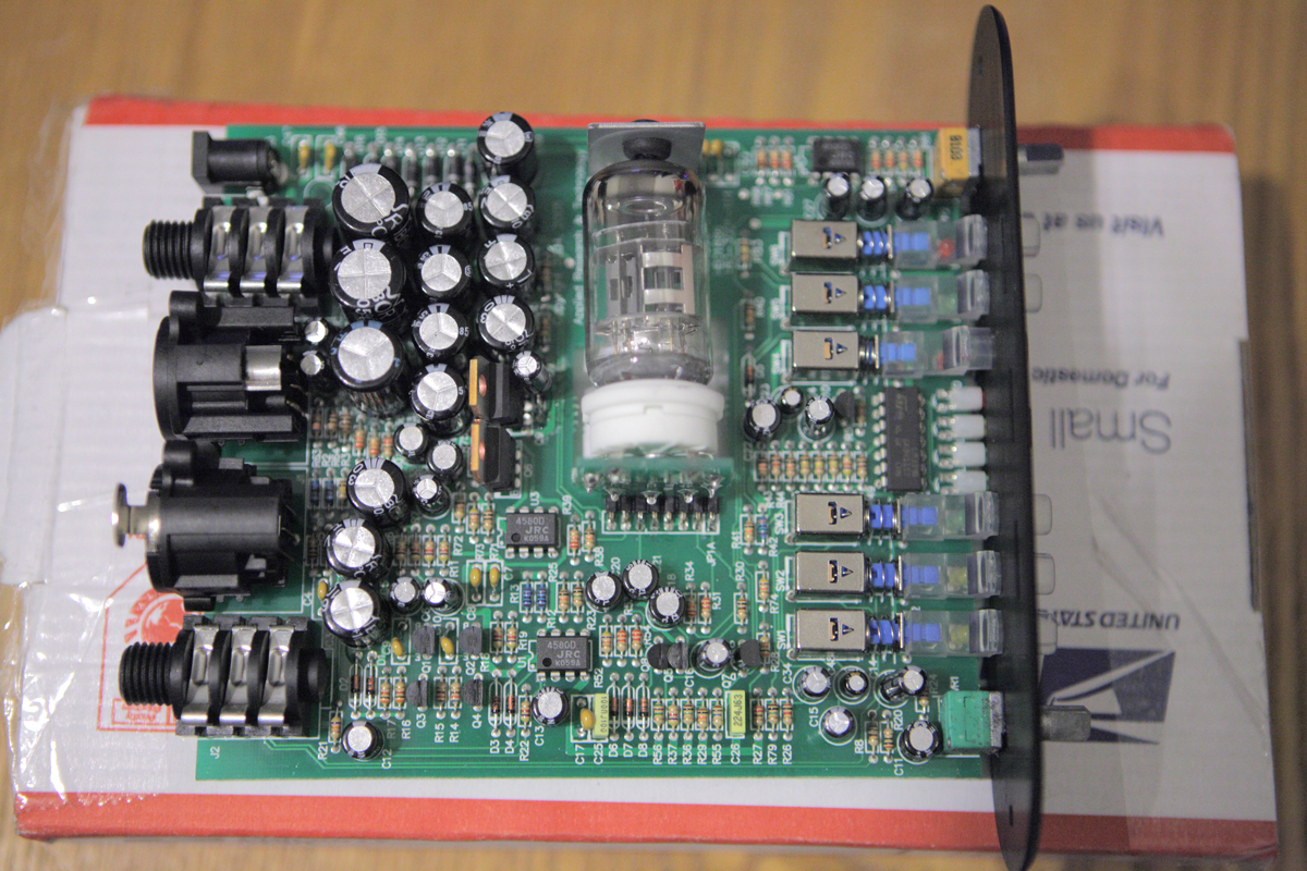

I purchased an external Behringer SRC2496 AD/DA, an ART tube Mp Project Series preamp and a Rode NT1A mic. Got this stuff so that I could bypass the mixer completely by using S/Pdif.. got a much better sound for vocals. Now I am thinking of modding these items instead, since they cost way less. Ordered a different tube for the preamp (that's a start), from my measurements the tube actually only gets 30v so it is definitely a starved plate design. I may try the opamp switch in the Behringer because the signal from the preamp is a bit hot for the ins of the Beh. Other than that the unit is very clean and sounds good. The Rode literally has 4 caps inside and a pretty decent Capsule, but may be looking into a quick mod similar to the Oktavamod stuff.
Attached is the Black Lion Mod for the original Art tube mp...and a pic of the ART tube mp project series.

On this preamp, I was wondering if it is possible to use a transformer to load the tube to atleaste 100v and then drop it back down to 30v to not blow the output opamp. The tube is ofcourse under powered at 30v, so I guess it isn't getting its full sound in the circuit. I got the new tube in the mail today and put it in...it is a Tung Sol 12AX7 which is much quieter than the stock tube so poo.. it's always something.
