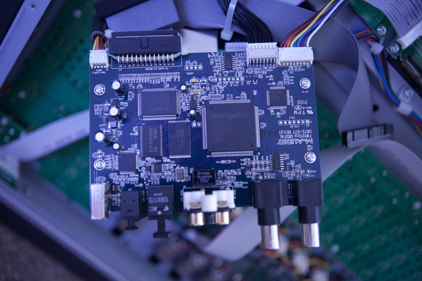

I see on the back of the main input/output pcb (first pic in your first post) a row of 8-soic op amps where access to tools and iron is very good (unlike the front of that pcb where access is blocked by all the connectors). It appears you could choose one of those to swap and experiment on (along with accepting that IF you make a mess, perhaps only that input is lost -- or needs repairing)? (Did that make sense?)
If you could look at a service manual (or just figure it out by eye), I'll bet there are some DC blocking caps that could be swapped...?
Yeah I will do one of those ics first...easier access...guess it will be sometime later... waiting on shipments.

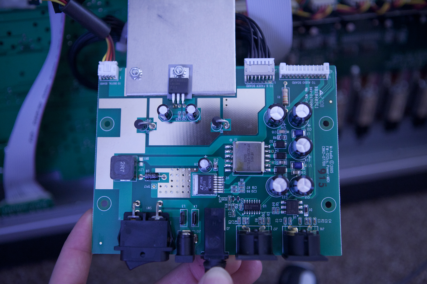

Your M-audio power supply doesn't seem to be in a ferous steel box. It doesn't appear to have any chokes in or out, either toroid or E-core. Is there something you are not showing us? Ishida Scales packaging machines that use Low voltage strain gauges and op amps are full of this stuff. In fact the Ishida power supplies are around the corner of a 6 gauge square frame from any measuring electronics, with toroids in the input from the AC lines. RF may be acceptable, but I don't like it in strain gauges or audio either. .
