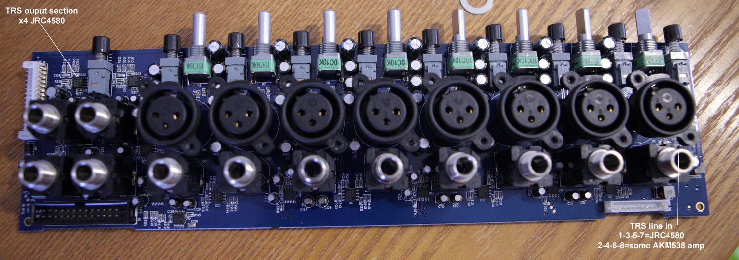

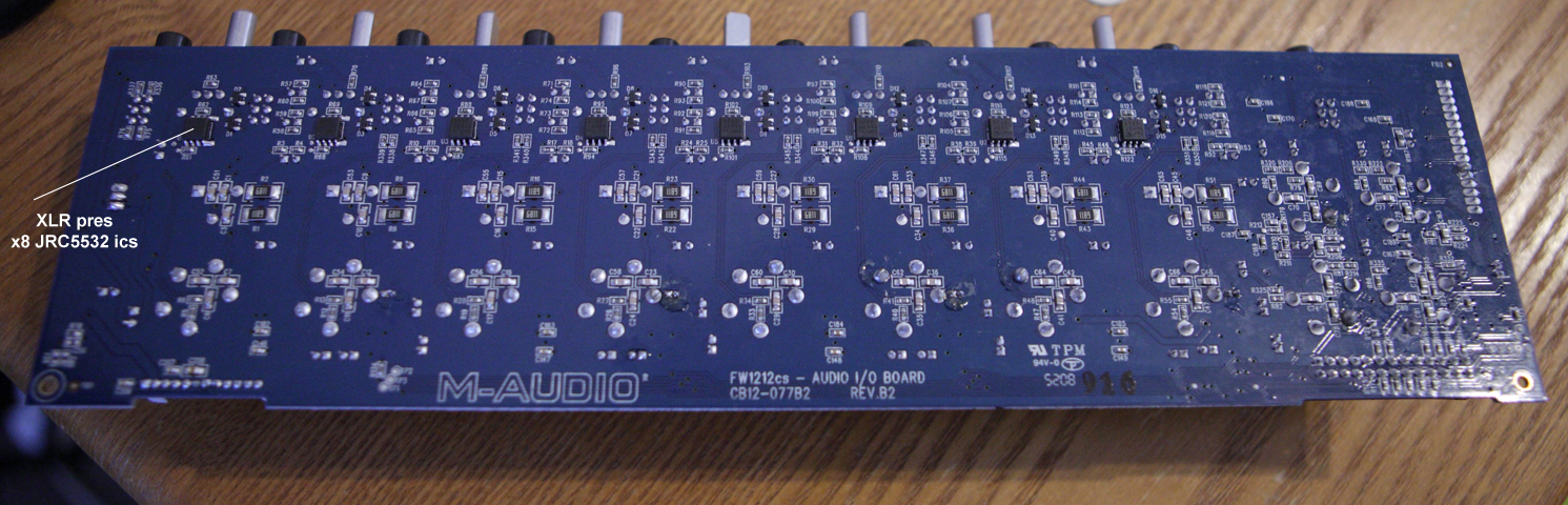

I'm Brandon,
I have a M-audio projectmix i/o 8 channel mixer (M-AUDIO - ProjectMix I/O - Control Surface with Motorized Faders and 18 x 14 Audio Interface). I have recently taken it apart to see if there are any mods I can do. I found that there are 8x JRC5532 opamps on the XLRs inputs. These I want to replace first. There are JRC4580 opamps on the TRS inputs and 4 JRC4580 opamps on the 4 main speaker outputs. Money being no option for this project, I am looking to replace all opamps with the BEST opamps as far as specs go... highest frequecsy response 20hz-20khz and so forth. I am not an engineer by any means but am very handy with a soldering iron and can follow schematics decently. This mixer cost me $1200, so I just want a drop in chip. I do not want to have to change the circuit at all. However, I will also be replacing the caps with top end caps-I can easily look at the specs on those so.. do not need help with that. I do not have schematics for the Projectmix, but can provide some photos inside. Any one who can help my e-mail is warsleyer@aol.com.

Regarding op-amps, there is no such thing as a universal 'best' op-amp - different opamps are good at different things. For input line-level buffering, filtering, etc. you can take a look at the NatSemi LME49720 or similar. For output signal buffering and headphone drivers, you can take a look at the THS4032 (SMD only) or LM6172 (DIP and SMD).
Is there something wrong with the sound of your mixer that makes you want to roll opamps? All opamps pretty much have the same frequency response 20-20kHz. There's nothing much wrong with the NE5532 provided its treated well (input filtering, power supplies and decoupling) and as you don't want to make circuit changes there will be pretty much no chance of improving the overall sound from changing these opamps. Swapping them out might well make some aspects better but others worse, depending on the particular design.
Thanks for the response. I am generally looking to get the best sound quality as possible. I know there is no perfect or best answer, but I know I could get better sound by modding this unit. A days worth of research has put me looking into OPA1612, OPA2604, or OPA2134. Are the ic's you mentioned direct drop ins? Are they comparable to the opas? Would there be any harm in just putting random chips in to test, as long as the pin-outs match (and of course the voltages and etc.)? Just want to push the unit to its limits.
The unit sounds good, but not shiny on the top end. Somewhat dull. After reading about the Black Lion Mods for this unit (that are now discontinued), I figured why couldn't I operate a bit and get a better sound out of this thing. Obviously, there is more to the sound than the opamps, but I was under the impression that this would be a cheap but effective upgrade.

It might be cheap to swap opamps. It is likely to take many weeks of circuit board modifications just to get performance back to where you were. It could take many more weeks of experimentation to actually improve the performance. In the meantime you have used dozens of cheap components that are now binned and you have probably lifted at least a couple of traces and implemented botched repairs just to get some sound out of your heavily modified gear.
Simply swapping one opamp for another proves only you are gullible to audiofools' suggestions.
Taking a piece of gear that has been optimised for the opamps the designer selected is virtually guaranteed to perform less well with 90% of the alternative opamps you might select as possible. If you are really lucky the other 9% will make the performance the same. Finding the 1% that improve the performance without optimising the gear to suit that "perfect" replacement is not an easy nor cheap modification.

All that has been said is correct... and I have said the same in the too so don't want to sound hypocritical suggesting otherwise...
however, I would say that if you want to experiment then do so. Many on here know I like the OPA2604, and that would be my choice I think to replace all. The LM4562 is the successor to the 5532 but one I haven't tried as yet. Of all the opamps I have used the 2604 is the most "coloured" but to me it's also the most musical. So try it!
Assuming single sided print why not fit sockets and try several. Even the ancient TL072 can sound darned good over the 5532 in many applications as long as the application is within the more limited drive capability of the TL072.

Sorry guys, not trying to ignore great advice, but I am definitely a hard head. As long as I can test things out, I will. It's in my nature. My way of learning is to disassemble and tamper (Hands on). For me to fully understand the effects, I must hear or try it myself to make my own conclusions. That being said I was definitely going to use a socket so that I will only have to solder once. I will likely test a few ics, since I already have some samples coming (OPA1612, OPA1642.) I am definitely looking for something that is a little more colored (musical). Mooly, you kinda hit the nail for me. I was looking for this type of answer. So now I know I could theoretically replace all the ics with the OPA2604 and no harm is done, cool! Love the help folks, exactly why I joined diyaudio!
Sweet or "rich" sounding opamps might produce muddy sound eventually while mixing multiply channels together. That is why pro stuff has purist opamps inside from the beginning despite the fact that prices for pro equipment would allow manufacture use juicy🙂 ones instead.
NS LME ICs claimed to be clean sounding might be right choice for a mixer upgrade.
I do have M-AUDIO 2496 with AD8620 that replaced original JRC IC playing right now. It's sounding OK for home playback but I would hesitate use its output for monitoring purposes since to my taste it does have its own sonic signature now.

Let me explain a bit better what my goal is. I am not completely oblivious to circuits and electronics, just not experienced. I love the mixer I have and it is awesome quality for the price ($1200). I am currently working on a home album, and want to get the best quality for the lowest price possible. I just don't have thousands of dollars to spend on top gear, or studio time. But.. with an external preamp, a good mic, and a good ad/da I am set. The problem with the Projectmix is it has no direct bypass for its Mic or TRS inputs, which means any gear that I run through this unit will pass through its internal opamps. If I have a $3000 NEVE, and run it through any channel, I will get coloring of the internal opamps (making the NEVE sound a bit sloppy). I don't mind the coloring if it is tasteful, but I find that the stock ics are a bit noisy and muddy (NOT LIVELY/CLEAN). I assume with better ics, caps, etc, I should be able to get better quality sound in general. Only other option is to go with a preamp with adat/spdif to bypass the internals of the mixer (costs rising into thousands). Suntechnik... I would love this board to have its own "sonic signature", that would make my sound unique. Might look into those ics... Main point is... I want the best mods on the cheap for a cleaner sound. -Thanks for the advice
You can try to get some samples of LM4562 (DIP and SMD, identical with LME49720) or AD8599 (SMD) - those sound very "clean" in my oppinion...
OPA2134 is another good one (maybe not that good, but very close) - you said already that will try that one.

You would be surprised as to how many very high end studio desks use 5532s and 4580s. Much more important are skills such as mic placement, correct gain structure and use of EQ and outboard, rather than op-amp brand. And they don't cost anything. 😉
:edit:, Oh, and I've also moved you to the correct forum.
If your mixer's PCB use SOIC8 (probably it is) I would add to the list THS4032 or AD8066 besides National Semiconductors opamps and OPA627 (it is mono so needs appropriate adapter use two OPA627 instead of single dual opamp).I would love this board to have its own "sonic signature", that would make my sound unique. Might look into those ics... Main point is... I want the best mods on the cheap for a cleaner sound. -Thanks for the advice
Electrolytic capacitors Nichicon Muse Bipolar or Elna Slimlic is a modern choice. Old days Black Gates considered to be the best but they out of production nowadays. I do no like film capacitors in sound path but many reviewers favor ones with Teflon dielectric especially. I am OK with electrolytic decoupling capacitors mentioned above if I cannot use foil ones like Jensen. Unfortunately foil capacitors are pretty expensive besides their huge size - the most limiting factor - so they are suit tube gear or speaker crossovers not modern PCBs. Imho film capacitors just a trade off they are not small like electrolytic ones and not as good sounding as foil ones.
partsconnexion.com is a good place to order capacitors and other audiophile related stuff newark.com - for ICs.
Probably moding mixer with a different OP AMP per every channel and see what channel works best for particular type of recording might reveal full potential of available ICs. It might be beneficial using not just one type of opamp in the mixer finally.
