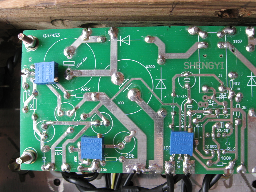

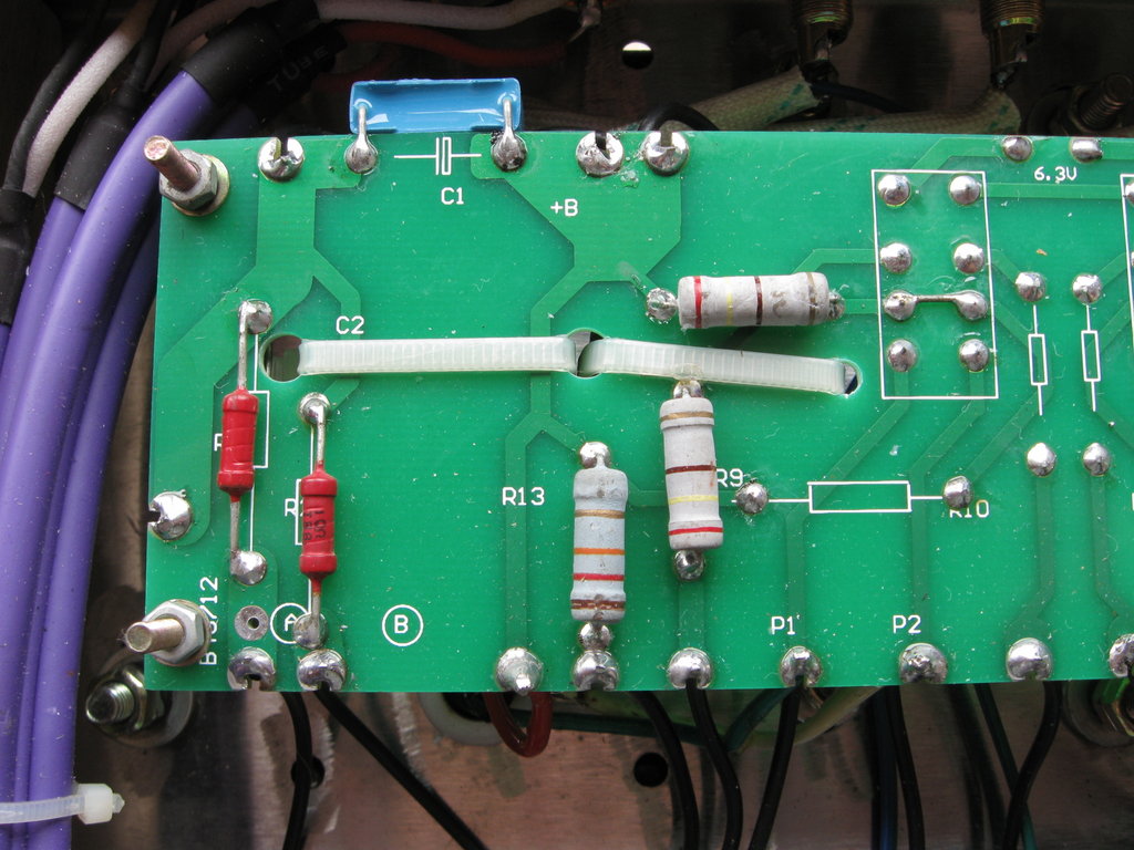

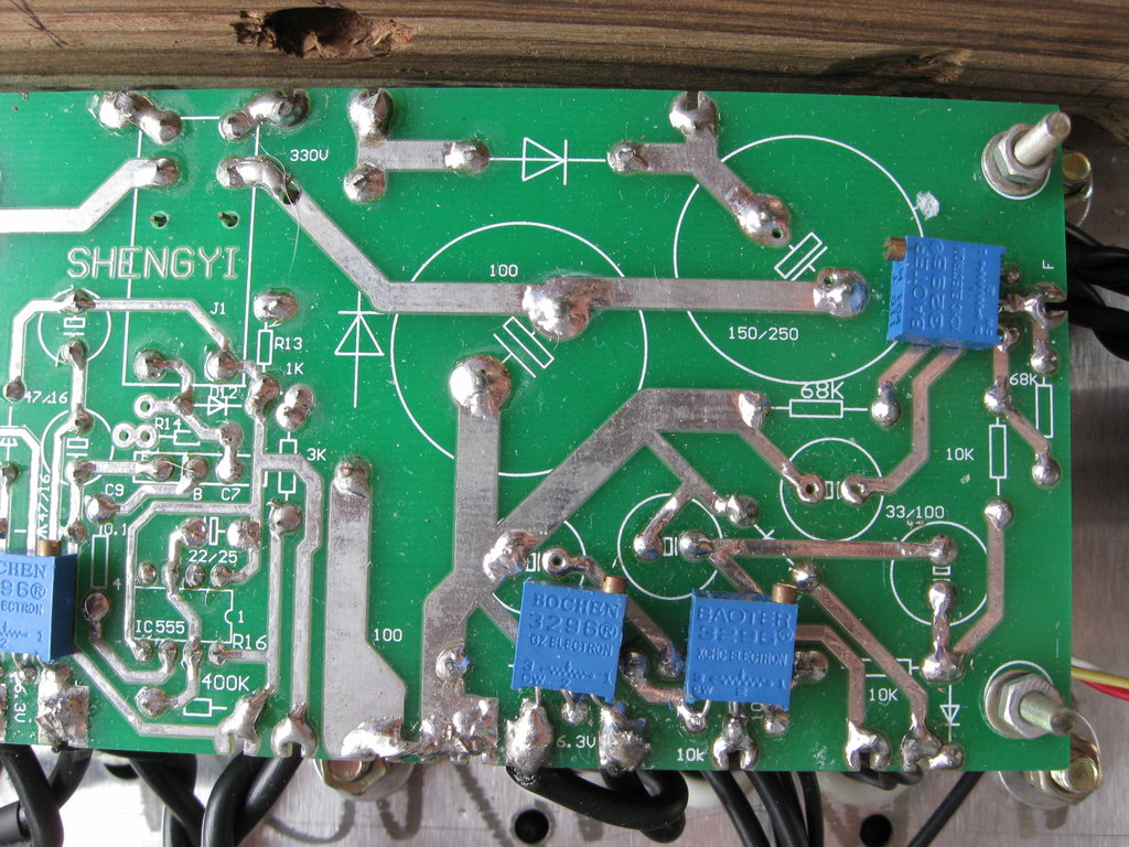

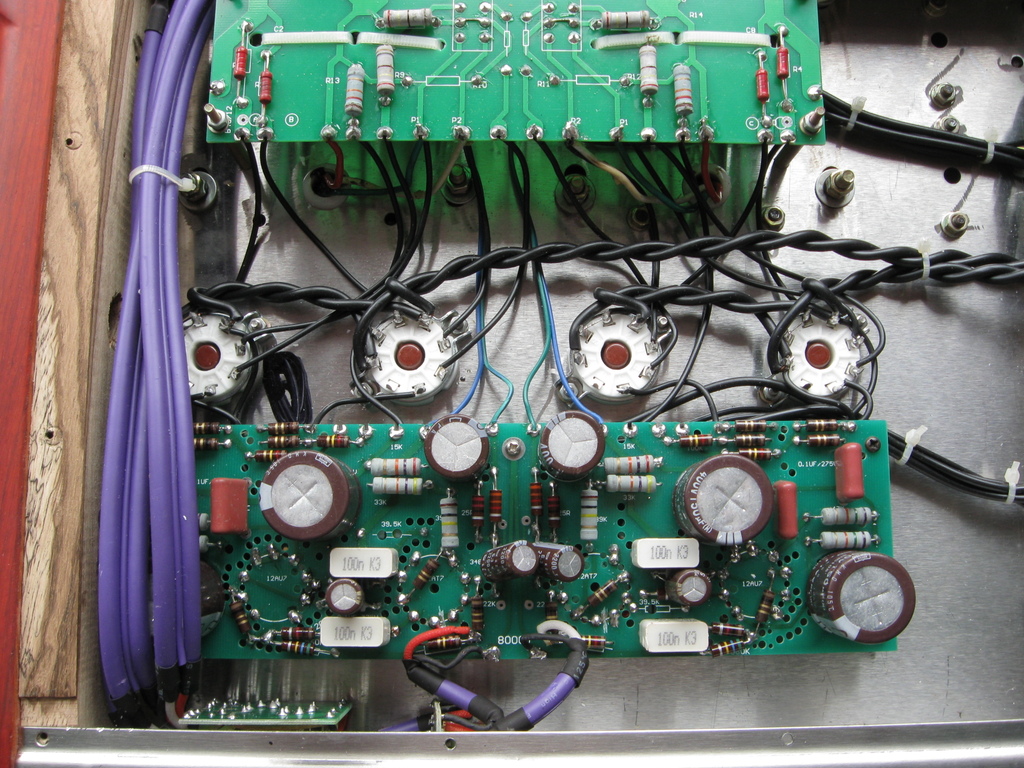

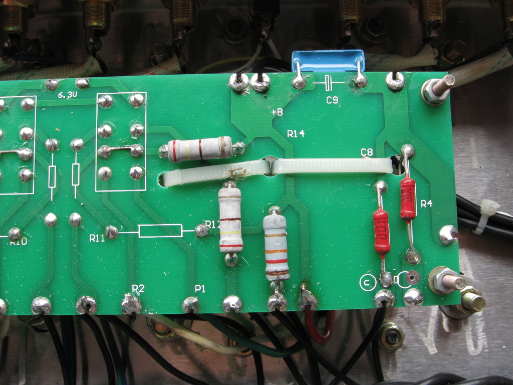

Power Supply part
Left pic:
var. resistor short side on pcb --> bias B
var. resistor left on long side pcb --> bias A
the other one ... filament hum removal
Right pic:
var. resistor short side pcb --> bias C
var. resistor right on long side pcb --> bias D
the other one ... the other filament hum remover
Left pic:
Right pic:

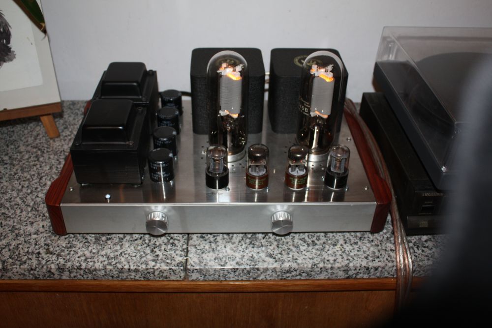

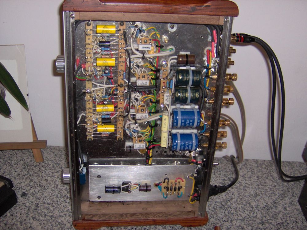

Hi, recently my friend from Scotland asked me thoroughly reworked its amplifier MA800. It worked perfectly! The input stage operates in SRPP / ECC83 /. Phase inverter operates in parallel with a common cathode / ECC81 / and final stage of AutoBias / EL34 /. UPS is operating in a bridge configuration / no-voltage Doubler / - transformers connected in series. The effect is excellent. Yours Dinkers
Music Angel
Hi Gary, I adjusted all the Chinese amplifiers. Gladly will put diagrams, but I have to find them and draw. Another amp I made the 6SL7 and 6SN7 tubes. Beautifully played by me MA845 modified. This is worth doing, because they have excellent output transformers / core /. In drawing this week will put MA800. Regards Dinkers
