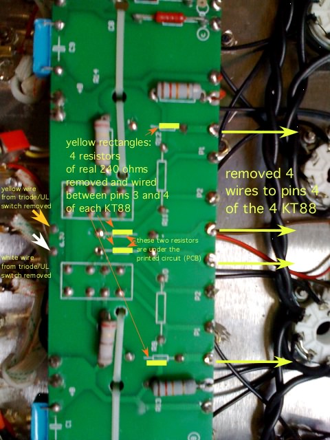

I think I got the response for my question about disabling the UL/triode switch on the Music Angel KT88 on this diyaudio thread
"remove the wire(s) from pin 4 (1 wire per tube). Connect pin 3 and 4 with a 100 ohm resistor (or with the resistor on the way from relay to pin 4). Also remove the 2 power connections to the relays".

An additionnal picture of the modifications I made.

Hi guys .... I'm new here and I too have an Music Angel KT88 which I'm modifying.
things I did;
- disconnected the switch at the back
- done the hardwired triode mod between pins 3 and 4 on all KT88's
- set the bias on all 4 to 35mA as a test but now I notice that the power-supply transformers are getting a bit too warm .... and I don't like it really.
before the bias was set to 25mA ... everything stayed a lot cooler.

Why not throwing out the PCBs and see it as a punched and finished chassis, fully fitted with mains and output transformers and valve sockets, knobs, binding posts, etc. so to wire a compatible proven circuit of choice for KT88 p2p with good components? It can be less, clean, & predictable work.
X-ploder, You have one of the later models of the MA KT88 amp with 6N1P input tubes. This is roughly equivalent to the 12AT7, but with different heater wiring. The amp can easily be modified to 12AT7 if some good old tubes of this type should come your way.
ECC85 will work nicely instead of the Chinese, or Russian, 6N1P. An odd substitute would be PCC88 which is also said to work nice in this amp.
I have heard about others also having some noise problems with this amp. If tube substitution does not help, make an extra check for good connection in tube socket and other bad connections or poor soldering.
You have permanently rewired to triode mode, this make the amp less likely to oscillation, but if you have access to a scope, look for any odd waveforms on the output. If the noise is more of a buzzing sound it could be caused by noise on the heater supply. Adjust the heater balance pots for minimum noise with your ear to the speaker.
A bit odd that the PT gets to hot with 35mA per tube, are you sure you have measured and calculated correctly? It expect it should be able to supply 50mA/tube without problem, but lower current usually sound just as good, and increases tube life.

Hey Sven B,
thx. for al the helpfull tips and info 🙂
I do think to that I have a recent MA with KT88 tubes.
Lot's of things are not present or changed on my MA.
One of them is that I don't have al the resistors on the input of the amp.
The cathode capacitor on the input stages is also a lot bigger then what you see on most schematics. Mine's are 1000µF . Should be gooso I leave them in place.
The heater balanced is been done ... allthough I noticed ... when I did the adjustment before because of a 50Hz noise that I heard in the left channel ... that the variable resistors aren't in a very good shape. Lot's of cracks were hearable when I adjusted them but anyway ... those two are easy to replace.
Anyway .... that kind of noise, a very loud hum ... is gone and isn't the kind of noise which I was talking about earlier.
The noise is realy high in frequency ... big guess ... let's say above 10Khz.
The bias is measured and adjusted correctly.
It's easy .... the resistors where you measure the bias on are 100ohm resistors.
So 350mV is 35Ma ... easy.
But maybe you are right ... I think I am going to turn the bias back to 25mA ... it sounded good that way before so ....why not.
One thing ... the hardwire didn't change anything on the high noise that I hear. It was there before the triode mod.

I believe you mean 10 ohm. There may however be two in parallell, the otherr on the other side of the PCB, making the cathode resistors 5 ohm.
In that case 350 mV would be 70 mA, which would run a bit hot.

You're right Svein_B
I measure 5 ohm on each of the 4 cathode resistors ... oeps ... so indeed I'm running them now at 70mA .....
Gonna turn the bias voltage on the resistors .... which are indeed 10 Ohm ... back to 250mV right away.
That should correspond with a bias of 50mA.
I have a bias calculator here;
it shows me that with an anode voltage of 444Volt, and a WA max of 42Watt each KT88 .... I should be running now at a bias of 55% of what the tubes can handle.
This should be a nice Class A/B setting.

The grounding of the chassis which is missing on the MA.
I connected it ... grounded the chassis with the ground pin of the AC input ...
well ... I immediately noticed weired kind of noises in my speakers ... I even heard mediacenter PC activity in the speakers.
When I turned my mediacenter PC off .... gone was the noise.
The noise went also away when I switched input on the MA.
Defintely ground loops ..... so if you wonder why they didn't connect the chassis to the ground ....
