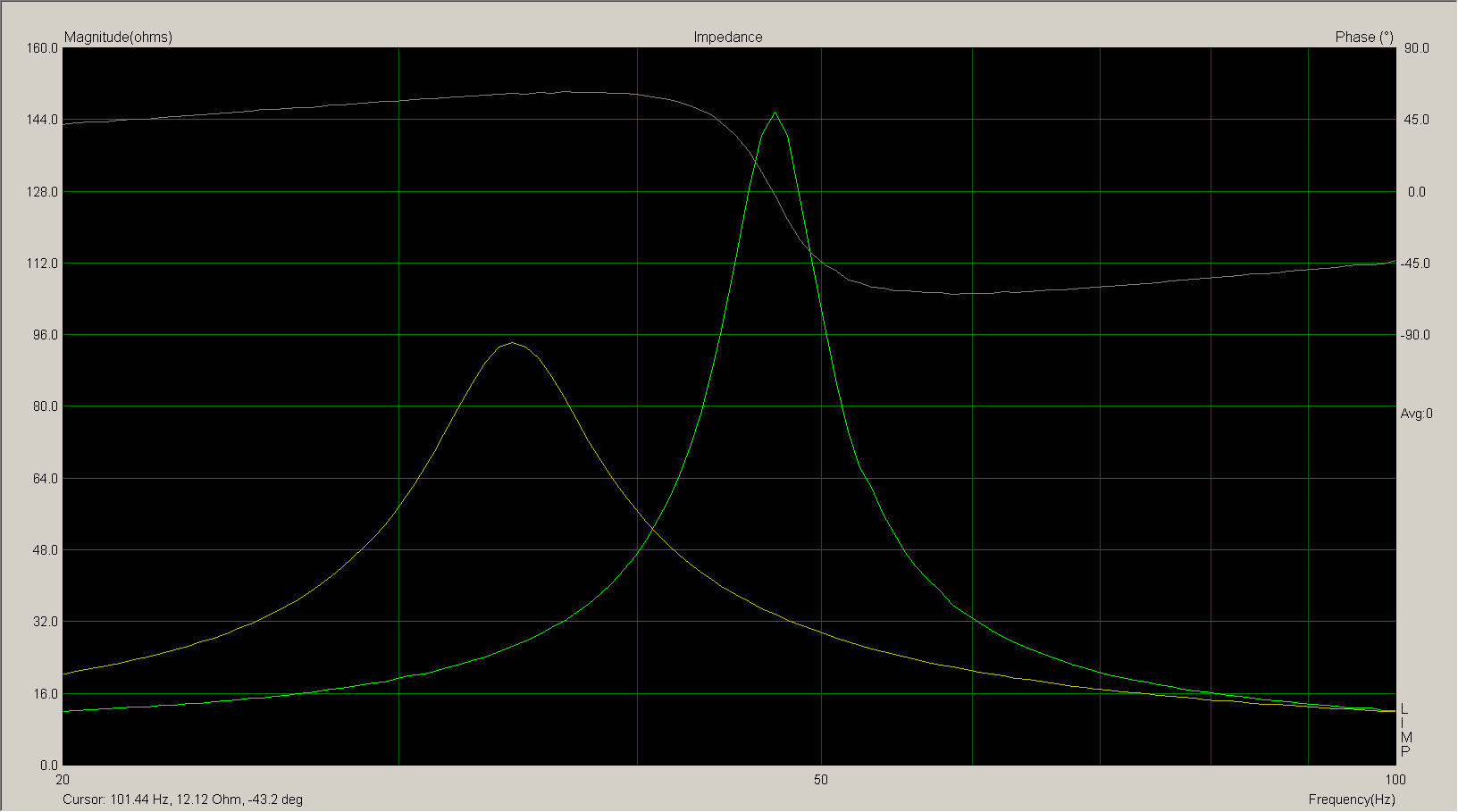

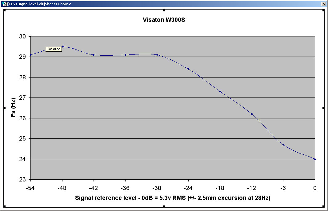

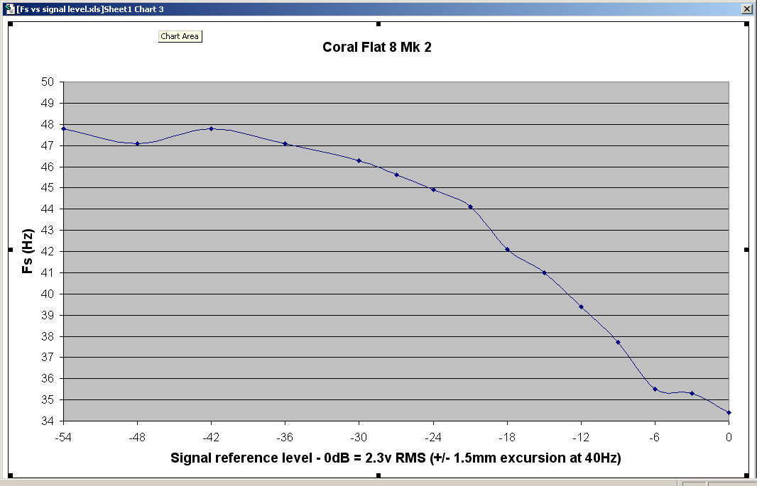

Well I've spent an interesting couple of hours measuring apparent Fs vs drive level for both drivers, and I've created a couple of Excel graphs. (See attachments below)
I tested both drivers from about half Xmax (0dB on the graph) all the way down to -54dB, where measurement noise started to impact the results - in fact there may be a small error in the -54dB and -48dB readings that is obscuring what is probably a plateau.
What is apparent is that there is a steady downward trend in Fs with increasing drive on both drivers, and contrary to what I had thought, it doesn't flatten out above a certain signal level. 😱 Although the fall in Fs does slow down a lot in both drivers (especially the small one) as you start approaching Xmax, it could hardly be considered to have plateaued.
On the Visaton driver there is a clear plateau below -30dB that could be considered to be "small signal" conditions. (The bump at -48dB is within measurement error) Therefore it's pretty clear at what level to measure this driver. (Although still keeping in mind it will change when driven with bass)
The situation with the Coral driver is far less clear, there is a huge change in Fs across the range from nearly 48 down to 34.5 with a steady and steep drop with no clear plateau at the small signal end. It's not at all clear to me at what level the measurement should be taken, because you're on a slope pretty much no matter where you measure, and the small signal reading is so dramatically different to the large signal reading I'm not sure that using the small signal results would provide a valid prediction of bass response.
The Qms also changes dramatically. The change in both Fs and Q is so dramatic I've attached an impedance plot - the yellow line is the 0dB response while the green was taken at -42dB. The impedance peaks at a staggering 145 ohms in the low drive scenario 😱 (For a nominal 8 ohm driver)
I think all I can really conclude from this exercise is that choosing the measurement level does matter if one wants to get repeatable consistent results, with the correct level being different for different drivers. (And it's possibly one of the big sources of error when comparing T/S specs taken under different test conditions)

For the impedance curve I attached in my post (you might have missed that one ?) I increased the measurement range to 20-100Hz, but otherwise settings were identical, so you can see the quality of curves that were being measured by that.
