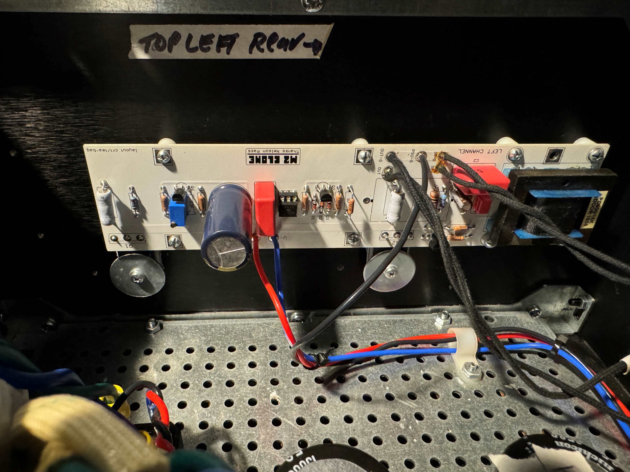

I have 2 M2 clones built with Tea Bags boards. I connected the first M2 I built which had been sitting unpowered for about one year and noticed a greatly diminished output from the left channel. Both Q1 and Q2 are heating up but I did notice that Q1 is running about 10F lower in temperature than the right channel which produces the correct output. I poked around on the board looking for a bad solder joint with no luck. I replaced the problem M2 with a second M2 and confirmed the issue is isolated to the left channel board. Power supply voltages are fine. The only thing that changed was I did remove the fender washers compressing Q1 and Q2 to verify the FETs make and model. Is it possible I damaged one of the FETs doing this? Any help isolating the problem is appreciated. Both of my amps have operated flawlessly since I built a few years ago.
Jim
pic of left channel board causing problems

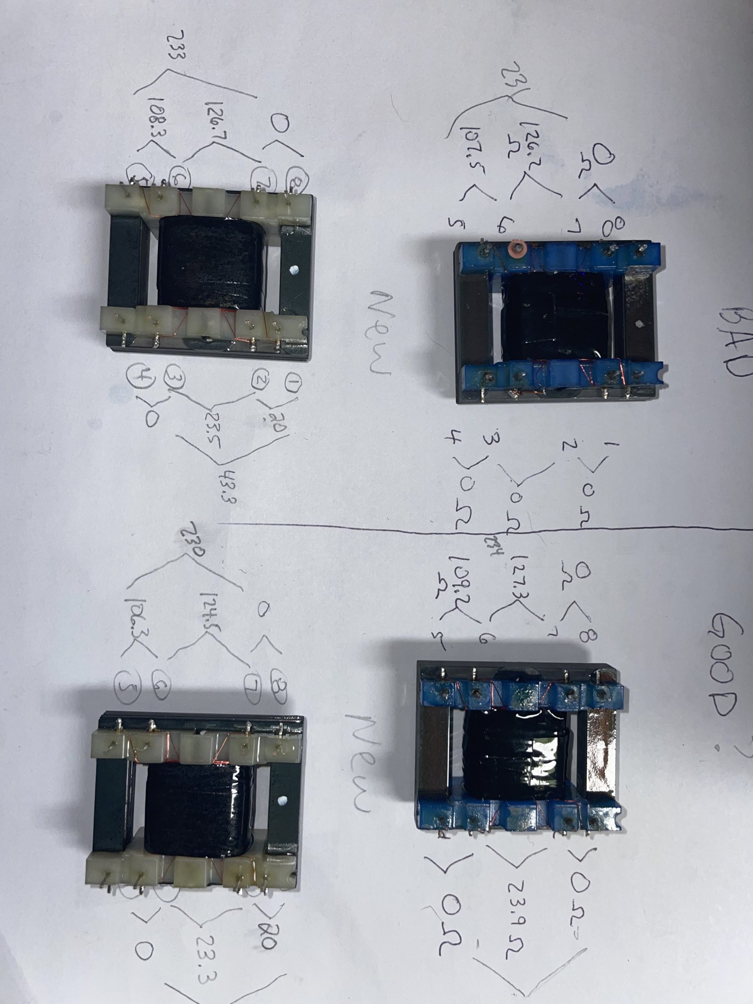

Were they working properly before they sat around for a year? I once had a bad Edcor input transformer that created low output. Check all readings on the pins of the Edcor transformer carefully. Good versus questionable channel.
This may be the issue. I took 3 measurements and the winding between pins 2 and 3 are different on the problem channel. Measurements below.
Pins on new unused Edcor iron:
1-3 45 ohms
1-2 20 ohms
2-3 24 ohms
Pins on good channel (right) climbs to approximately same values as new Edcor
Pins on problem channel (left):
1-3 95 ohms
1-2 20 ohms
2-3 110 ohms
Other side of Edcor transformer pins 5,6,7 measure about the same for all 3 cases.
Now to see if I can unsolder the 8 pins to save the board and parts!
I also measured the voltage drop across R13 and R14. Both channels measured about 400 mV and voltages across R3 and R4 measured about 200 mV on both channels with 10k resistor on input and dummy load on outputs.
Advice?

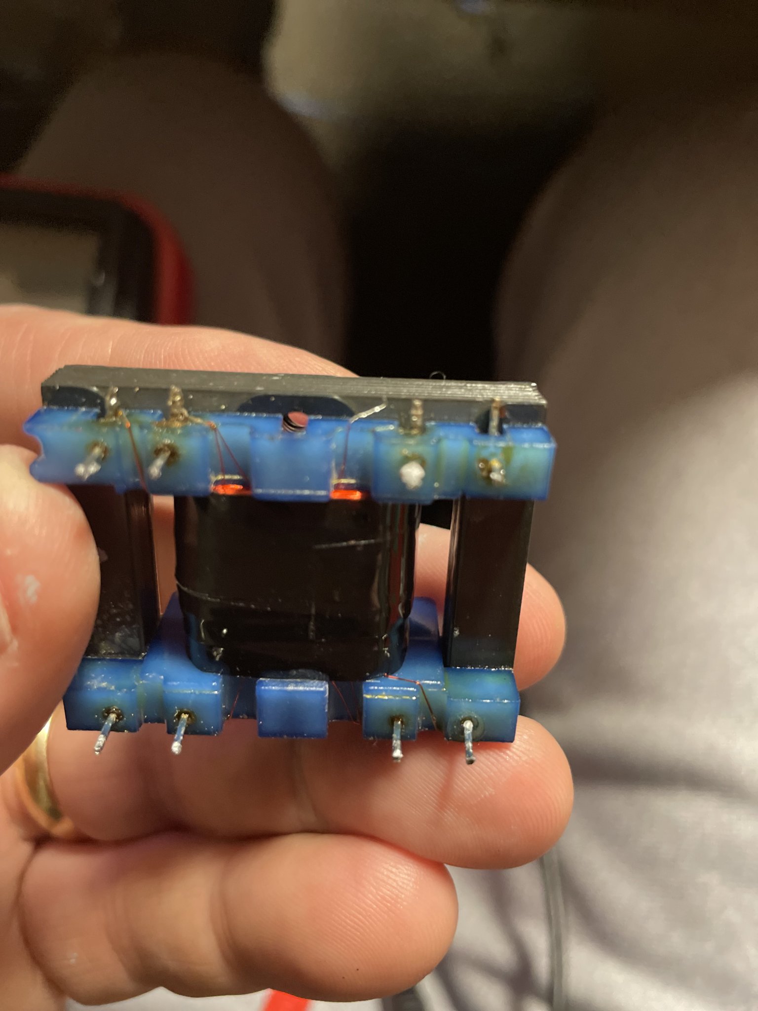

Now that you've removed the faulty Edcor, do you see any obvious damage (eg. broken wire)?
Unfortunately, the auto-former took a beating removing so measurements after removal were meaningless. I do know that the primary winding on the bad channel measured about 2 times the correct resistance when tested on the board. I guess that explains why I could still hear music from the bad channel. I was not getting any voltage gain. Those Edcor's do look fragile with very small wire. It would be nice if they were mounted remotely.
