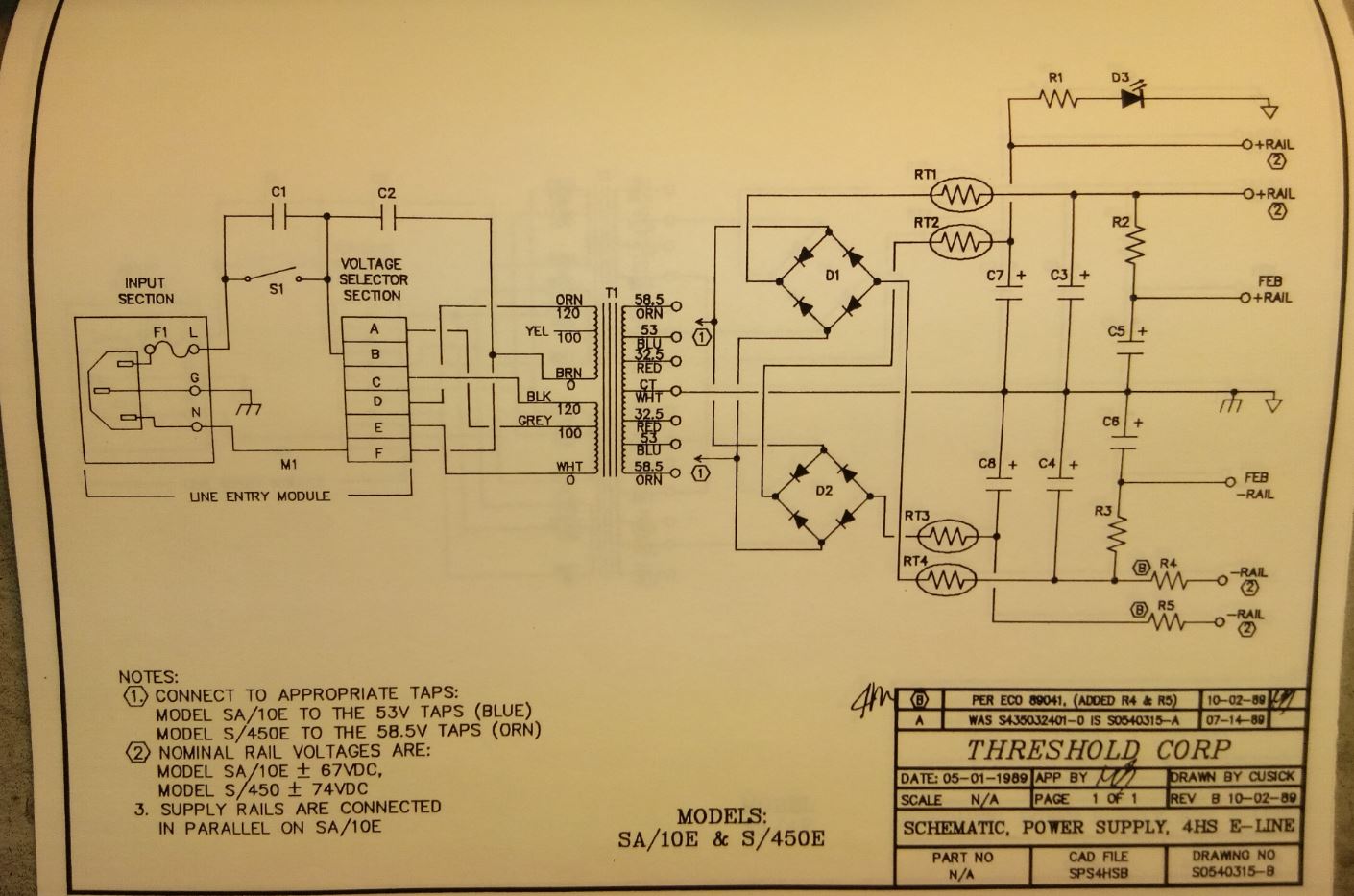

another people in internet send me the power supplat schema od s450 where is indicated that the nomial rail voltage shold be 74v dc
and i see that my s450 the vdc is 80 volts dc when i set to work to 220v ac
then i tried to set the s450 to work at 240v ac and vre s 73vdc
about the dc in otput with this operation ( set 240ac volts) is low anoher 0,1v dc
so i have 1.0 v dc on the right and -1.1v dc in the left
i wait yours comment

hello Zen
I did another test and would like your opinion.
precisely:
which is presents the DC component I have thought of to put a capacitor of electrolytic 6800UF in series with the loudspeakers to block the DC component so.
But as soon as I put the capacitor the sound is not coming out just croaked that if there were the final transistors burned.
as if for a moment I connected the speaker without consendatore the sound came.
I now wonder what the consensatore that causes abnormal operation so?
I did the same test with a s200 full working and all this did not happen.
so I assume that the problem is on the output transistors and not the card drivers.
waiting for your opinion.
I hope I was clear, conversely let me all appropriate questions.

well , from your post #1 , I get that you have simple problem , regarding output offset , and that amp is otherwise functional ;
now , define all problems you have - is amp working at all and what are specific problems for each channel
