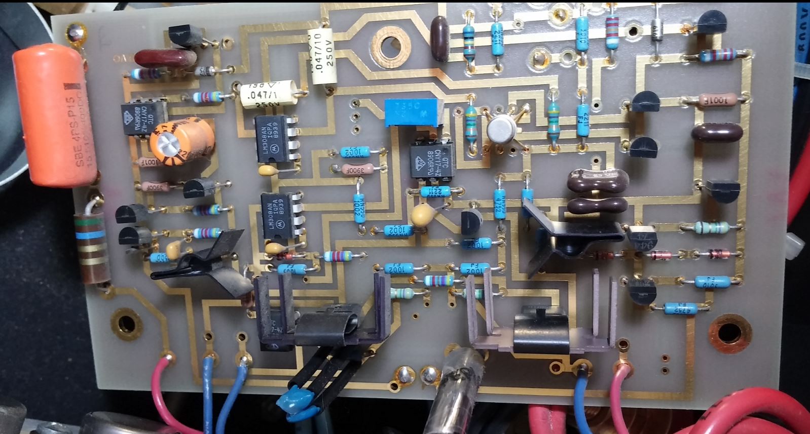

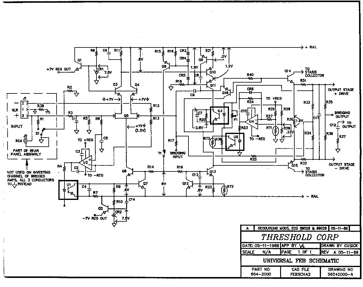

perhaps I have found the problem
hi Zen perhaps I have found the problem
i have dismount the output stage to check all 22 power transistor
and if i test whit the test in posistion test diode between the pont incicated B and EIi see an short circuit also if i change + and - tester tip, see folloging picture:
B shold be the base of transistor and
E shold be the emitter of transistor
but betwhen b end e i see an short
si i think the transitor is damaged confirm my idea ?
or i make an error ?
so it is true for all 20 thansistors indicated in the schemaindicated
q4 q6 q8 q10 q12 q14 q16 q18 q20 q22
and
q3 q5 q7 q9 q11 q13 q15 q17 q19 q21
i wait your answer

all upper ones are in parallel , same as all lower ones
so , you can't be sure which one is shorted , without unmounting them from pcb
in fact , for B-E and C-E measurement you can , desoldering emiter resistor of transistor you're measuring , but for B-C measurement , you need to pull out one by one
