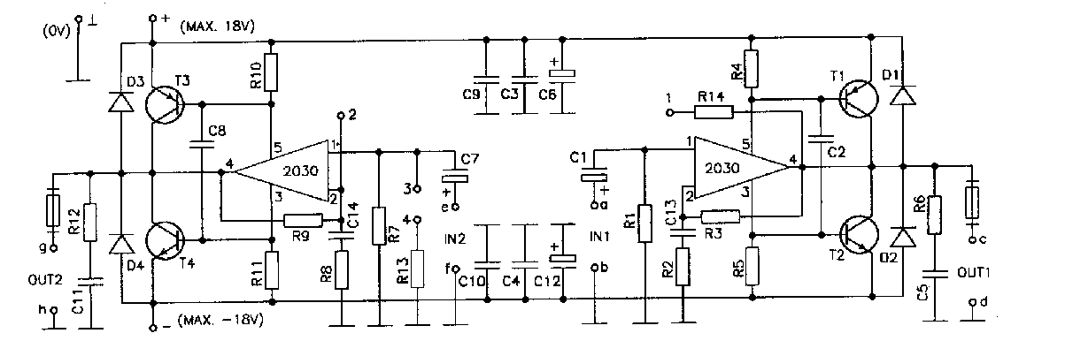

help to select and correct 400w TDA2030A OR 200WTDA2030

You can build the design for fun but if you need to spend much money on the parts or they are difficult to buy, there are better designs to spend that money on.
Just consider the linear qualities of the components like TIP35/36. They are not suited to audio. Yes, they work and the amplifier will work , but a cheap class D or chip amplifier will also sound much better IMO.
The design is 20 years out of date. It is cheap because the parts and design are (were) meant to be cheap. The audio is limited by the cost, so better parts will give better sound but then a whole new design is necessary. If you want to do all that, fine. It is your decision.
Frankly, a pair of bridged chip-amps would be easier, cheaper and much better. Since this is really a Chip amplifier application, why not read the Chip amplifier forum here for ideas?

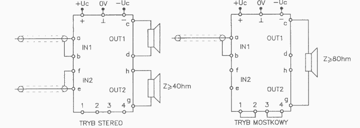

PDF FILE of MY PCB TDA2030A Bridge
say again :
PCB of TDA2030A BTL streeo(I Designing by ARES professional Labcenter Electronics Software) is complete.
my PCB IS GOOD for build my Amplifier... OR NOT GOOD Design .... Please See Attached files
(some Copper track in Pcb is not thin ??? )
SEE MY PCB
NEED any correction ?

helloe ....orginal ( polish web site) schematic is not working and very THD and my 50w transformer is quickly hot !!
i only cut pairs transistors and circit is now good worked.
but after removeing two 2R2 resistors between base of transistors and IC and removeing 220nF Cap between pin 3 and 5 IC my tda2030a is hot quickly but sound quality is good so.
