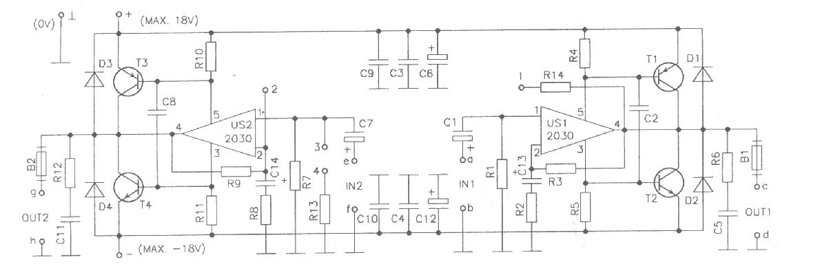

circuit is correct?
possible to replace BDX54C & BDX53C(hfe=750) WITH TIP36B & 2N3055 (hfe=20)
or not possile?
please help me to builde this project correct !!

Yes. Possible.
TIP35/36 or TIP3055/2955 (or 2N...)...
I made quite a similar bridge with LM1875 and TIP3055/2955.
Very stable very powerfull, very nice sound. Haven't measured the THD yet, but so far looks promising.

Is OK...
But i would use:
TIP35 (NPN) and TIP36 (PNP)
Or:
2N3055 (NPN) and 2N2955 (PNP)
And not lower power...
Depends on your input voltage.
You want more power, use LM1875 and close to +/-30V supply.
Or TDA2050 (max. +/- 25V).
Same circuit OK.

Don't guess what is necessary or how to design amplifiers unless you have more understanding. Use a straightforward design specified to do what you want and build it as designed. Play with parts and trying different components when you understand and have some experience, like after successfully building something that is known to work. (Unless you want a heap of burned parts, that is).
Something you should realise, is that you can't simply substitute industrial parts because they are all you can get. The specifications of TIP35/36 make them awful for audio and the SOA graphs say you can't get full power rating anyway. They are only 35 volt parts. If you want to get 100W/8R in class AB, you'll need to bridge two 2N3055 amplifiers, if all you can buy is these old parts. Often designs will fail because each substitute of a substitute part gets too far from the requirements of the original design. The amplifier may even work but while the original was a good design, what you may have after fitting poor substitutes, is only junk quality.

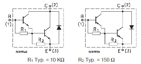

You also cannot simply substitute Darlingtons with non-Darlington transistors.
You may however make your own driver stage, similar to the internal structure of the BDX53C/BDX54C. This image shows the internal structure of the darlington. You may make this yourself, for example in place of the BDX53C, you may use a TIP31C + TIP35C together, and for the BDX54C you may use TIP32C + TIP36C.
However you will not safely get 100W with just a single pair of TIP35/TIP36 transistors. You would need at least two pairs to drive an 8 ohm speaker, at least 3 for safely driving 4 ohms.
Forget using the amplifier bridged to get more power - the quality will be poor and you will simply blow transistors.

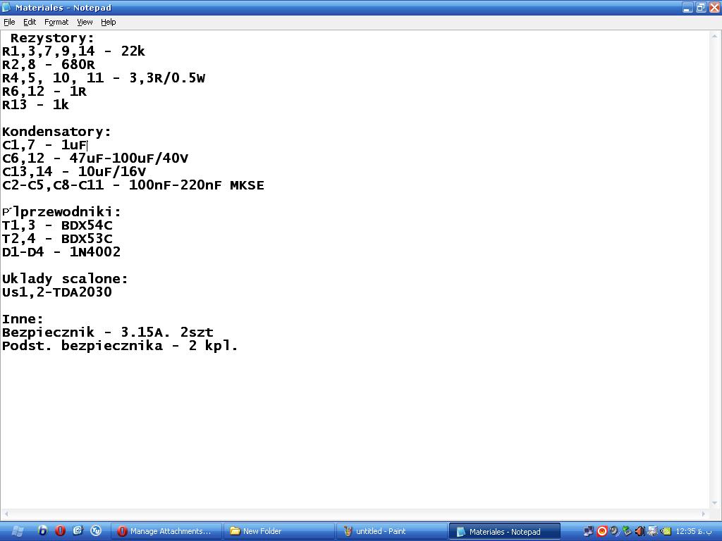

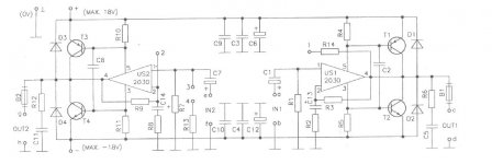

please see attached files ...
this doc file is translated by google (original spanish to englishAttachment 83330)
Iwant 100w +100w streeo or 200w mono(bridge)
my Qusetion:
1- this circuit is working with TIP36B together 2N3055 instead Drlingtons transistors (BDX54C BDX53C) ???
2- power of circuit ??? (TIP36B +2N3055)
1) Yes.
But use complementary pairs...
2) 80W to 4ohm, 40W to 8ohm.
Want more power, use LM1875 and +/- 30V supply.
Same circuit OK.
Output power with LM1875 = 200w into 4ohm. 100w to 8ohm (and bridged that is).
Want even more power - forget this circuit.
Posting these articles again won't make them any more believable. As you have been advised already, the amplifier cannot even produce 100W with the power supplies or parts specified. The translated Hobby Electronics article does not promise high power at all, and only specifies +/-17V power supply for 50W music power output. That is not the same as RMS power. Please read up these definitions, often used to mislead customers.
Maybe you should also consider the size of transformer and electrolytic capacitors you will need for 400W total. You will require > 600VA for this or > 300VA for 2x 100W.
My suggestion is that since you are so focused on this basic type of hybrid amplifier, why not build it exactly as the drawings show and maybe you will be quite happy with that. It probably does operate and make sound, but not as much as you have been led to believe. Perhaps that is just as well, knowing how many fake components will be cheaply available to you.
