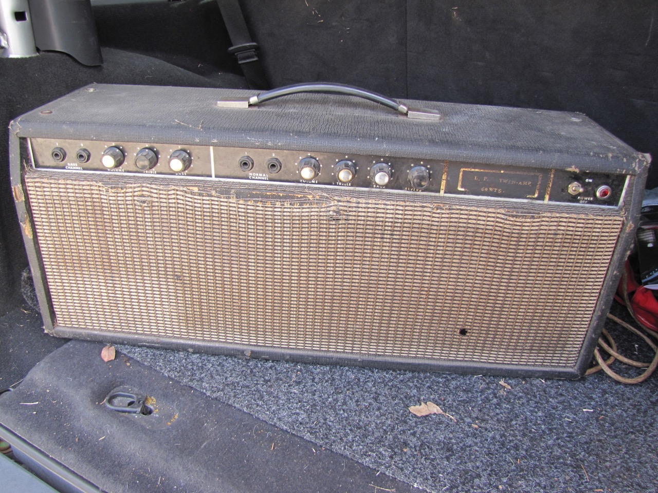

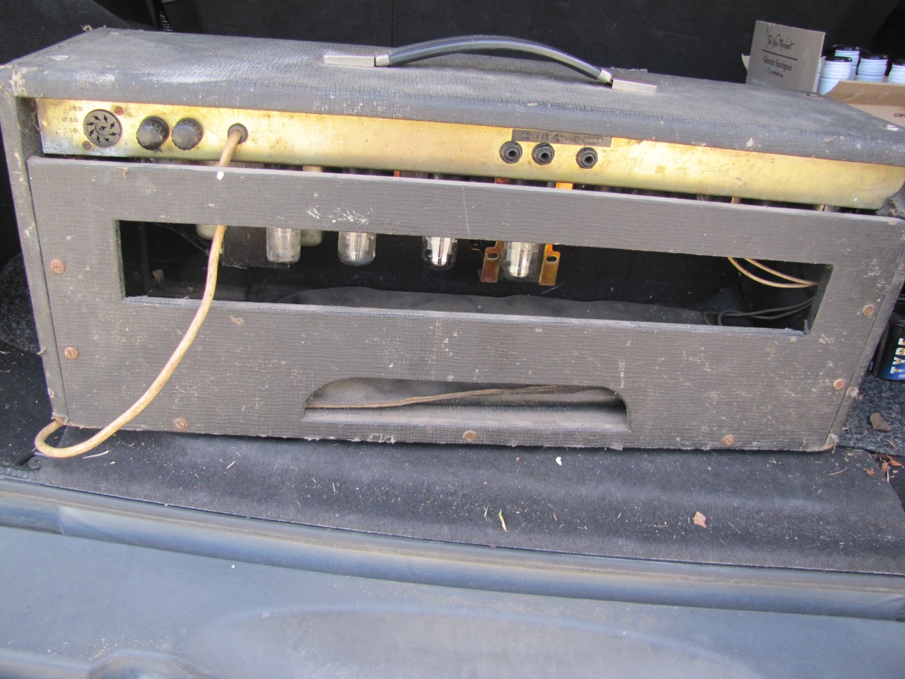

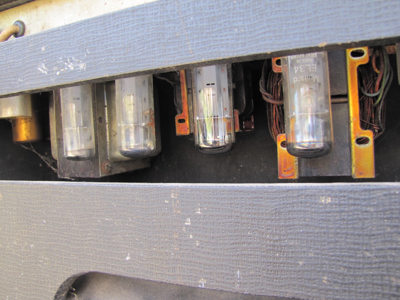

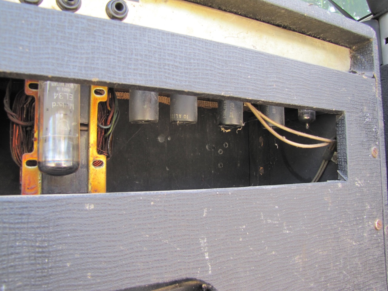

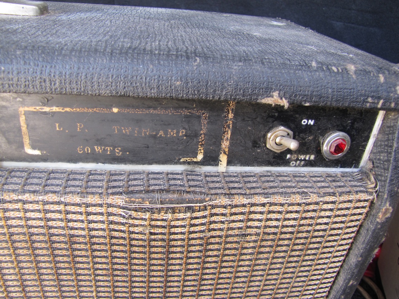

Hoping someone can identify an amp I have. It is obviously a guitar/band amp that has 4 EL34 output tubes and the letters LP on the front panel. I cannot find any reference to LP amps and don't think it is Les Paul but you never know. Images attached this time.

How is this "low power"? Four EL34 can meet or beat a quad of 6L6. The OT looks ample for two tube and not that shy for four.
The "L.P. ...." part looks crooked and yellowed, while the rest of the faceplate is well preserved.
Australia/NZ had dozens of small builders working on the margin between shipping and import taxes from NA/EUR.
This may be a "dropbear", an example of a species not seen outside Australia. :confused::rolleyes:
LP ... Twin Amp ... 60 Wts all lok yellowish crumbling but above all, hand applied, so mean NOTHING.
I used to make similar panels using hand applied Letraset rub-on letters and white tape in variousn widths, then spray varnished over.
40 y.o. varnish could look yellowed and cracked.
"Reverb" also looks hand applied and misaligned.
Transformer frames (2 out of 3) are typically British, as well as Vynide covering and Mullard EL34, so British or Australian locally made.
Forget using LP as identification, it might very well be Leonard Portnoy´s amp or some similar name.
It is NOT 60W but 100W because of visible tubes and iron, no labelling on the back (except homemade) show it´s a homemade amp.
The guts might offer more clues.
It might be one of ozvalveamps,check there, not by name but by picture.
FWIW LP Twins had TWO 6L6 and none had Reverb
Show some gut pictures, which could also show some signature, date, parts with date codes, etc.

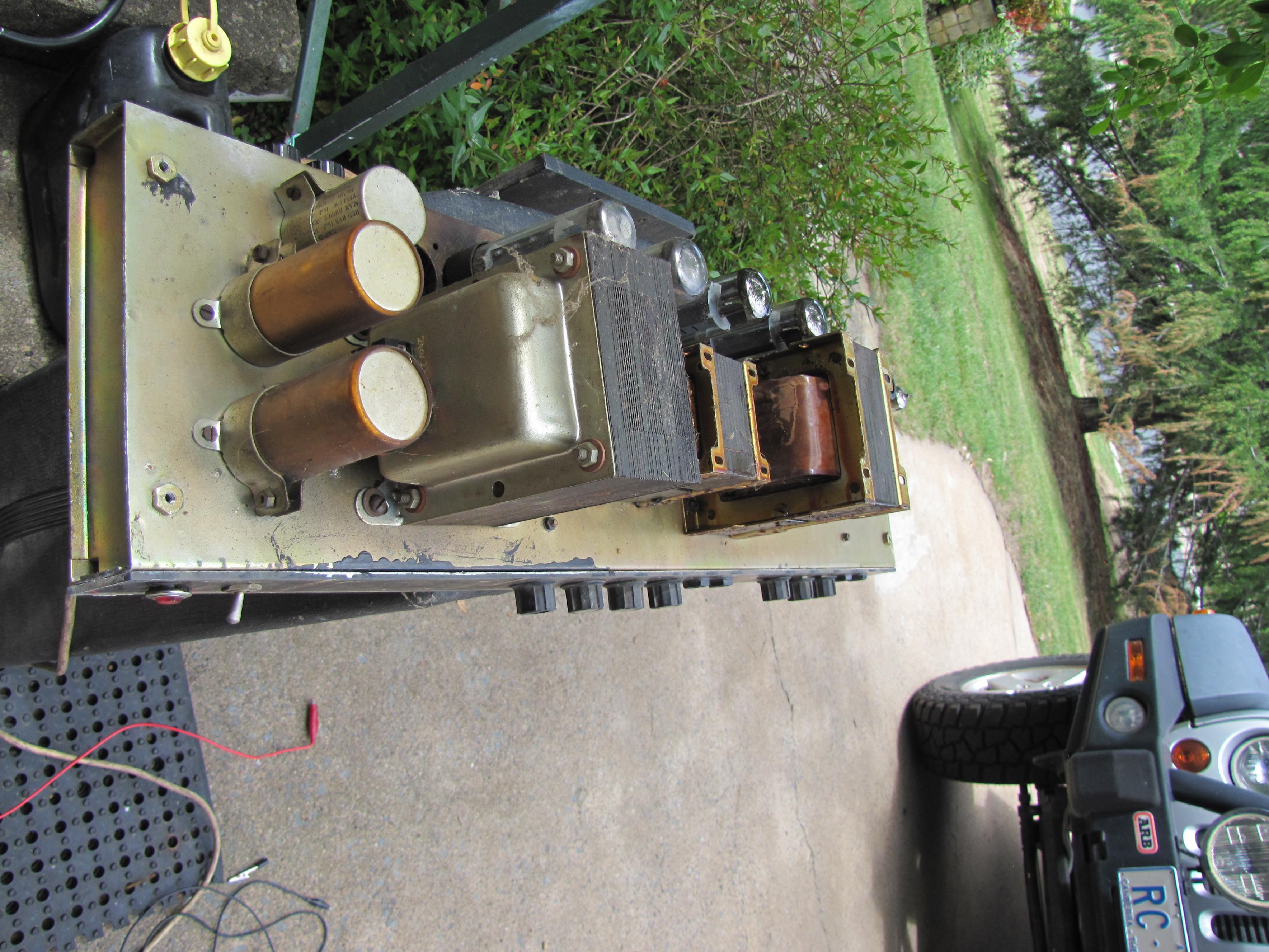

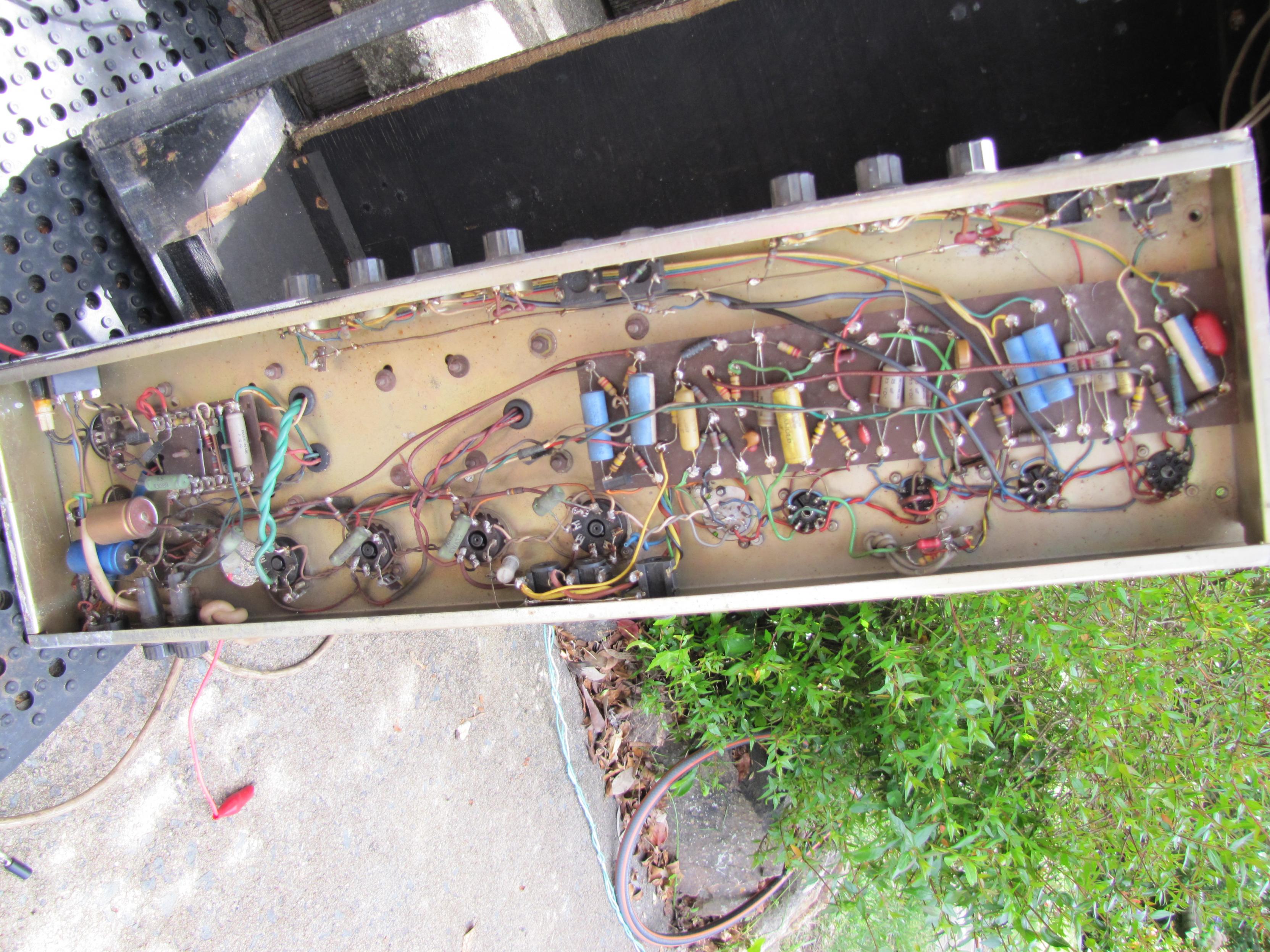

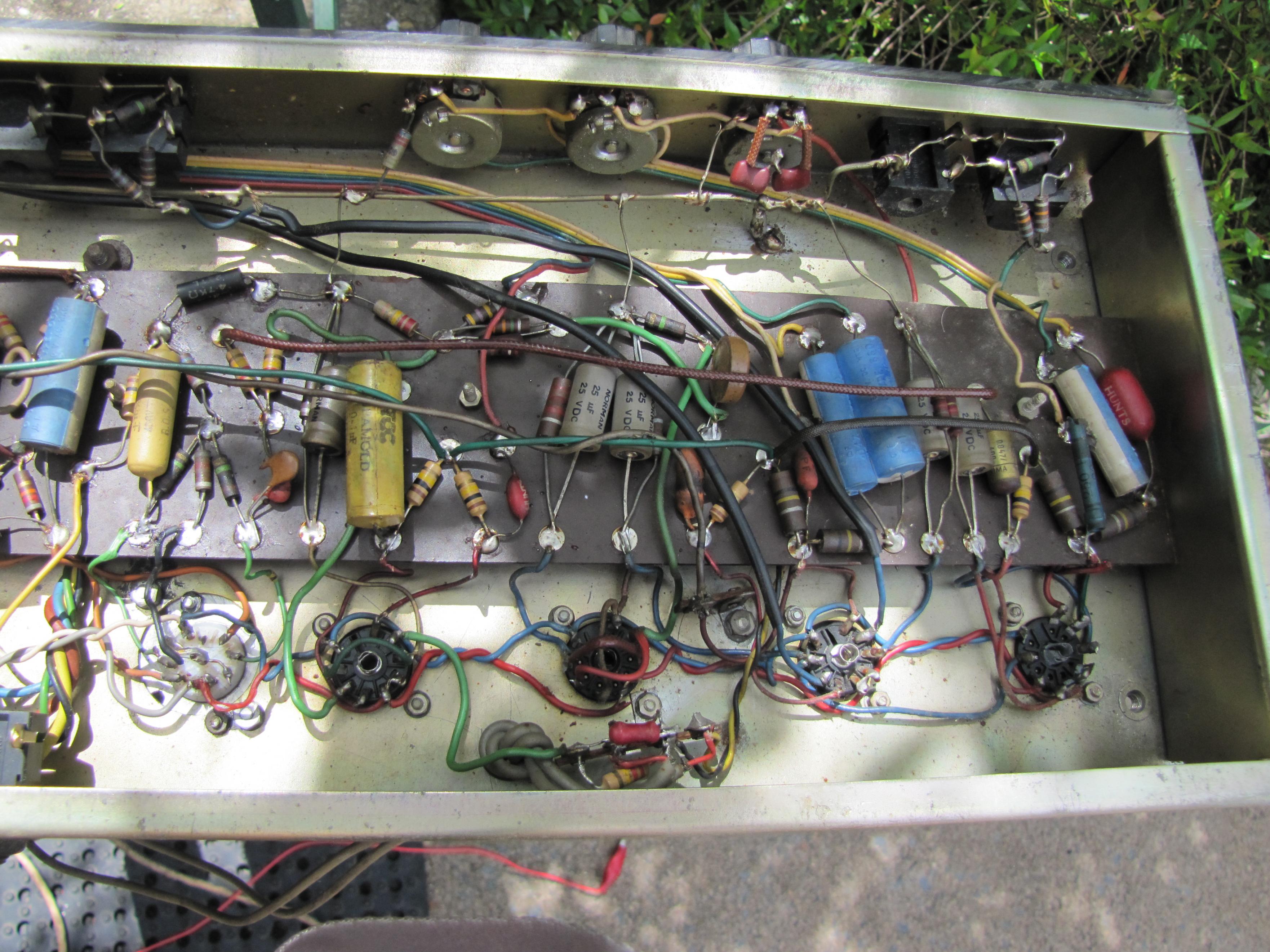

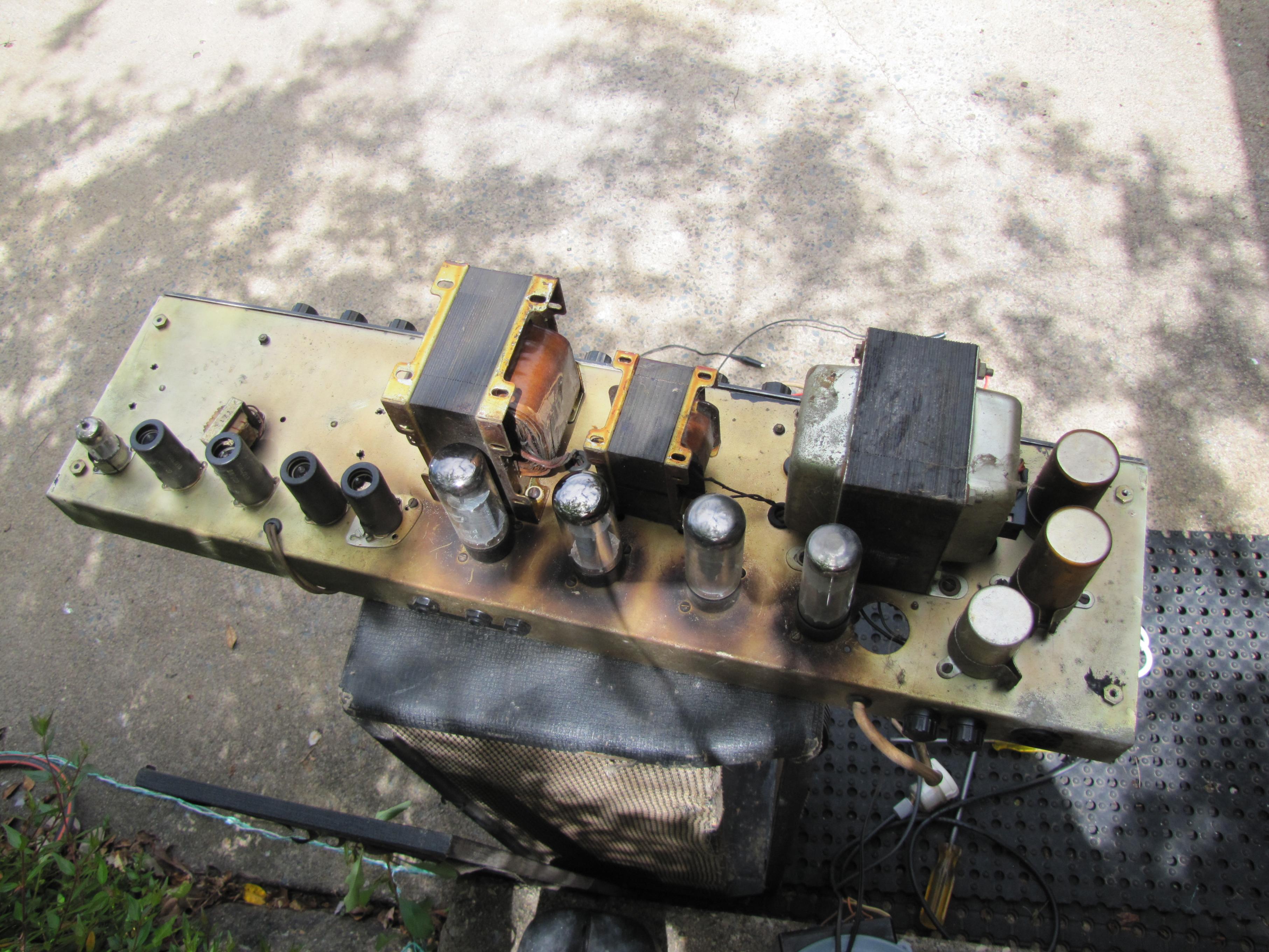

Thanks for all the responses. Have finally got around to pulling it out of the case and taking some pictures. Valve line up is 4 EL34, 4 ECC83, 1 ECC81. It is possible, one ECC83 has been added to replace an octal base valve. Powered it up through variac for a couple of minutes and surprisingly, it worked. No useful markings on components but most caps appear to be British made

The transformers without bell-ends appear to be Partridge, based on the frames and clamping (eg. as used by Hiwatt, Sound city, Laney).
Hunts capacitor datecode is a three capital letter format which includes only the following letters WHITSUNDAY (and the format provides a year of decade number and a week of year number). I've never come across the e-cap with the name/label of NORMAN before.
Chassis layout is sort of like some Laney's.
