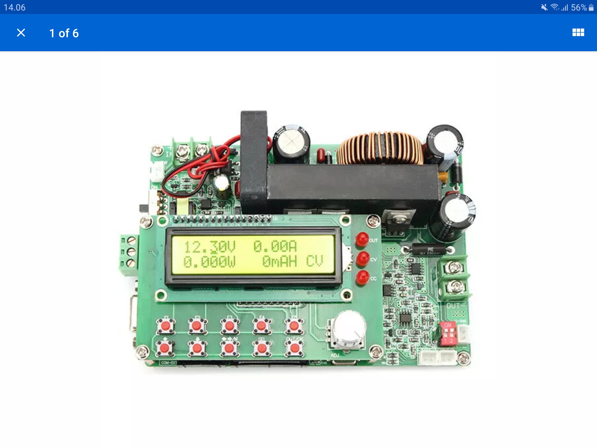

If it was me I would buy two maybe four of theese and an old amplifier chassis to fit it all in.
D6015a, maybe add some better cooling.
50mv p2p ripple, most amps dont mind a bit of noise, cmrr.
That would make a vertisale and powerfull psu, with ttl for computer control.
Now a stupid sounding question but you can often buy units, like these or more fancy models from Rigol, BK and many more. They can often be put in series or parallel, but is it possible to combine my PSU 15V 60A with lets say a 30V 5A to get 45V 65A, maybe combined with a sort of rail splitter to get -50%V / +50%V?
I'm not sure I got your question, but the buck module shown I think is a step down, so in order to max it out you will need a dc supply that delivers maybe 10 percent more, so what's needed is a powerful transformer 50 to 65 volt ac rectified and capacitors, around 1000uf per ampere.
