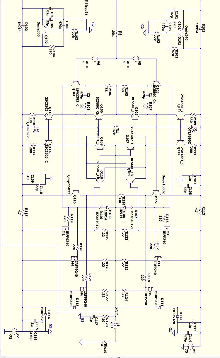

You have many of those transistors. Why not just send a few to Ostripper or others so they can provide you with a tested circuit.
Or find the model for those transistors and post the circuit topology you are interested with. Hopefully many will "design" it in simulation but of course the first option is better.

Do you mean the auto-bias OPS as depicted above? That circuit has never been built. Perhaps you confuses it with the Super-Tis front-end.

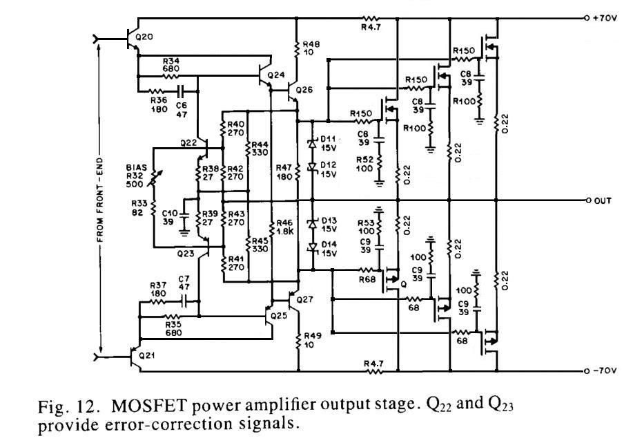

I do not understand why he used on every power mosfet a Zobel like solution.😕
Do you mean C8, C9 etc? Probably you will need it for each MOSFET and put them as close as possible to the gates. According to Bob this stuff prevents HF oscillations.

To use 3 pair output for the higher power I needed to do some minor mod. can you take a look these is correct how I drawn.
Each mosfet will get a 39pF and 100R because of that I needed to switch location of the diodes - drain resistors and C8 R52

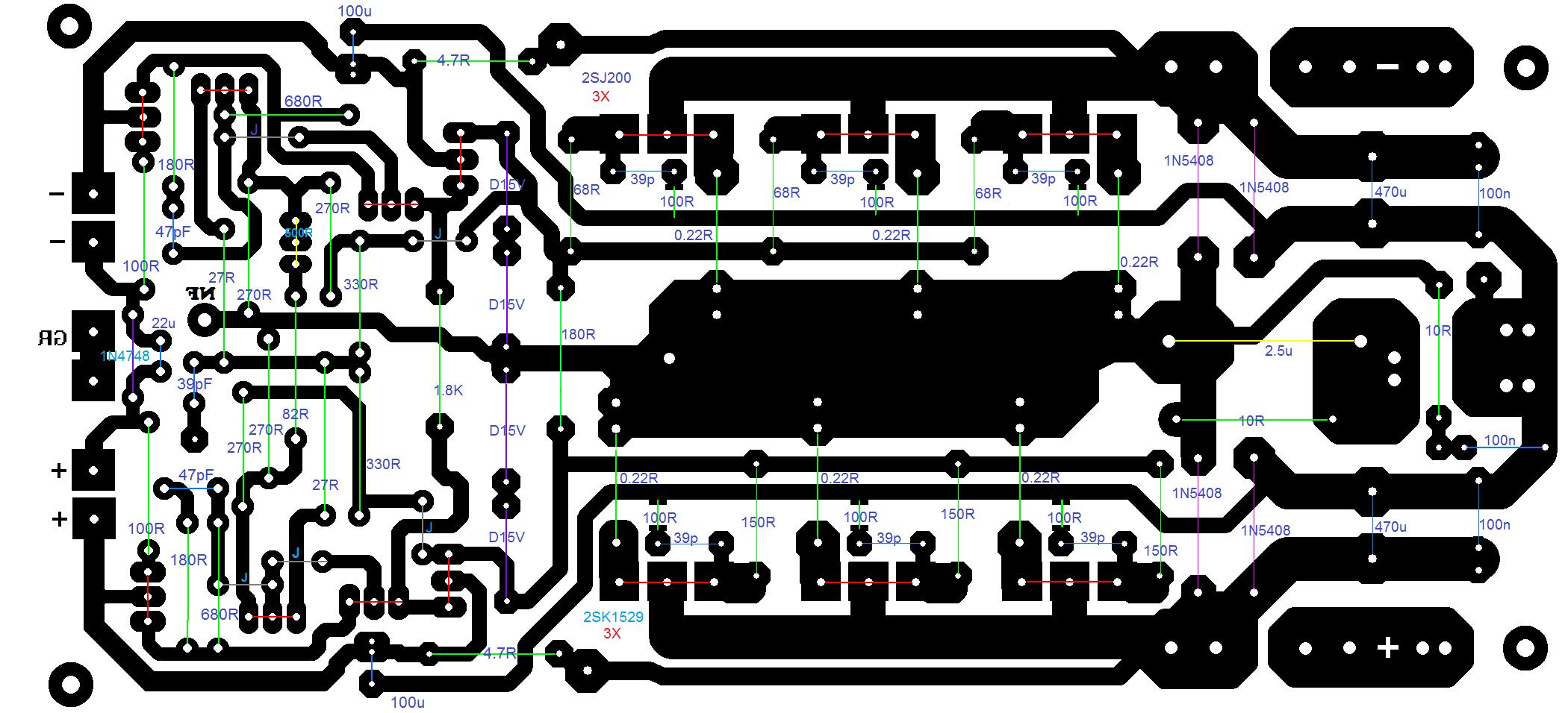

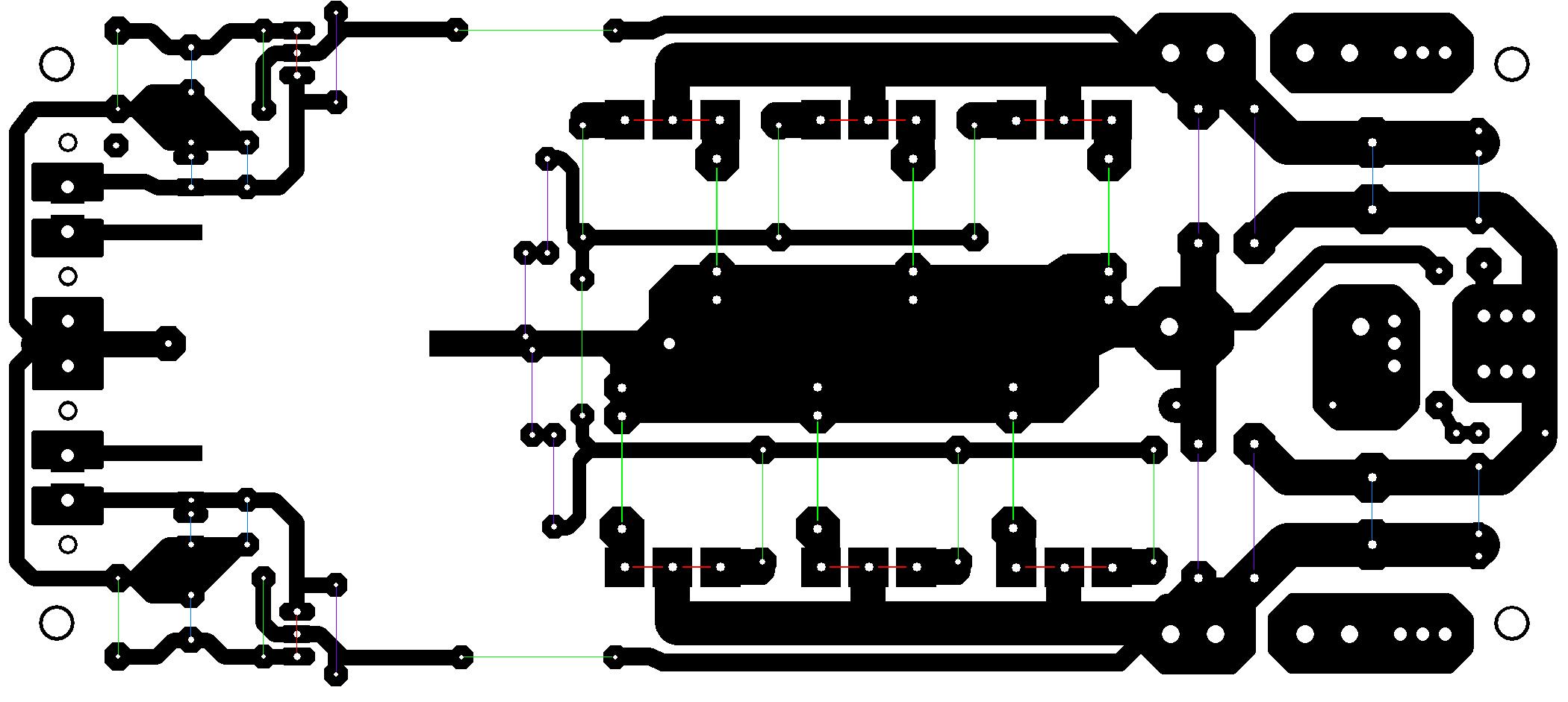

Hi
Just finished the layout based on the Cordell circuit with some minor mods.
C8,C9 hopefully is pF value not nF (actually I'm not sure about that)
The 100R resistors are SMD type.
It does has the option to use of the regular Zobel N if needed.
Also I added 2.5uH inductor with a 10R resistor (optional)
I do have to go over Cordele's file to get better understanding on the function of these amp.🙂
I needed to mode the front end so I can hock it up with the mentioned IPS.
Can someone take a look if the layout is correct also the added mode to.😀
Thank you guys
Greetings G

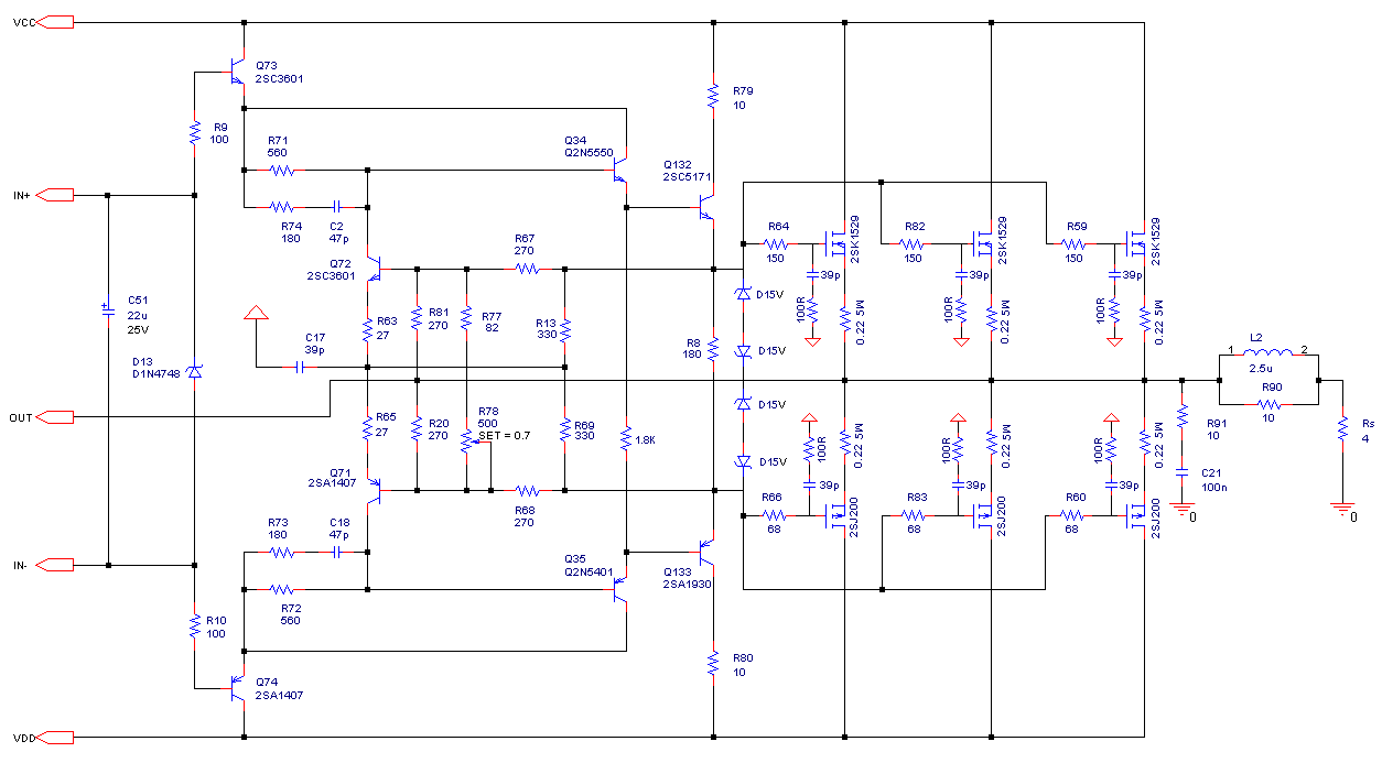

Hi
I redraw the schematic because hard to see the original.
Edmond, Jason and others would you please let me know your opinion if these correct!
I did some minor mode, otherwise I can not hock up with the IPS I would love to.
If these correct I will go on and etch the PC boards.
Thank you
Greetings Gabor
