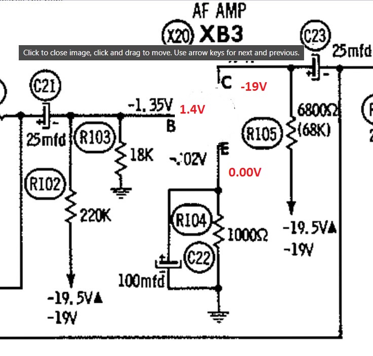

Look at the diagram. With the transistor removed (or at least two of the three leads isolated) we must see the following and these are all voltage readings...
The emitter must be 0.00V because it is only tied to ground via a 1k resistor.
The collector must read the same as the supply voltage because that is tied to the supply rail by the 6800 ohm resistor.
The base sees a voltage determined by the divider consisting of the 220k and the 18k. If the supply is -19 volts then the voltage at the base is (quick calculation):
I=V/R and so I = -19(220k+18k) which is -0.0798 milliamps.
Voltage across the 18k is V=I*R which is -0.0798E-3 * 18000 which is -1.43 V.
So the base point should have around -1.43 V present. The exact value depends on the exact supply voltage and the exact resistor values but that is unimportant. Around -1.4V is the expected result.

That is looking at face value like a failed transistor then. Do you know the part or device number of it?
-1.1 volt on the base is a wee bit low sounding but is does depend on the exact resistance values in that bias network. -18 volts should see around 1.36 volts.
It is probably unrelated but worthy of looking at at some point. Either the 220k is high, the 18k low, or the cap C21 is leaky... thinking aloud now... the leakage of a 25uF might be enough to slightly alter the figures anyway.

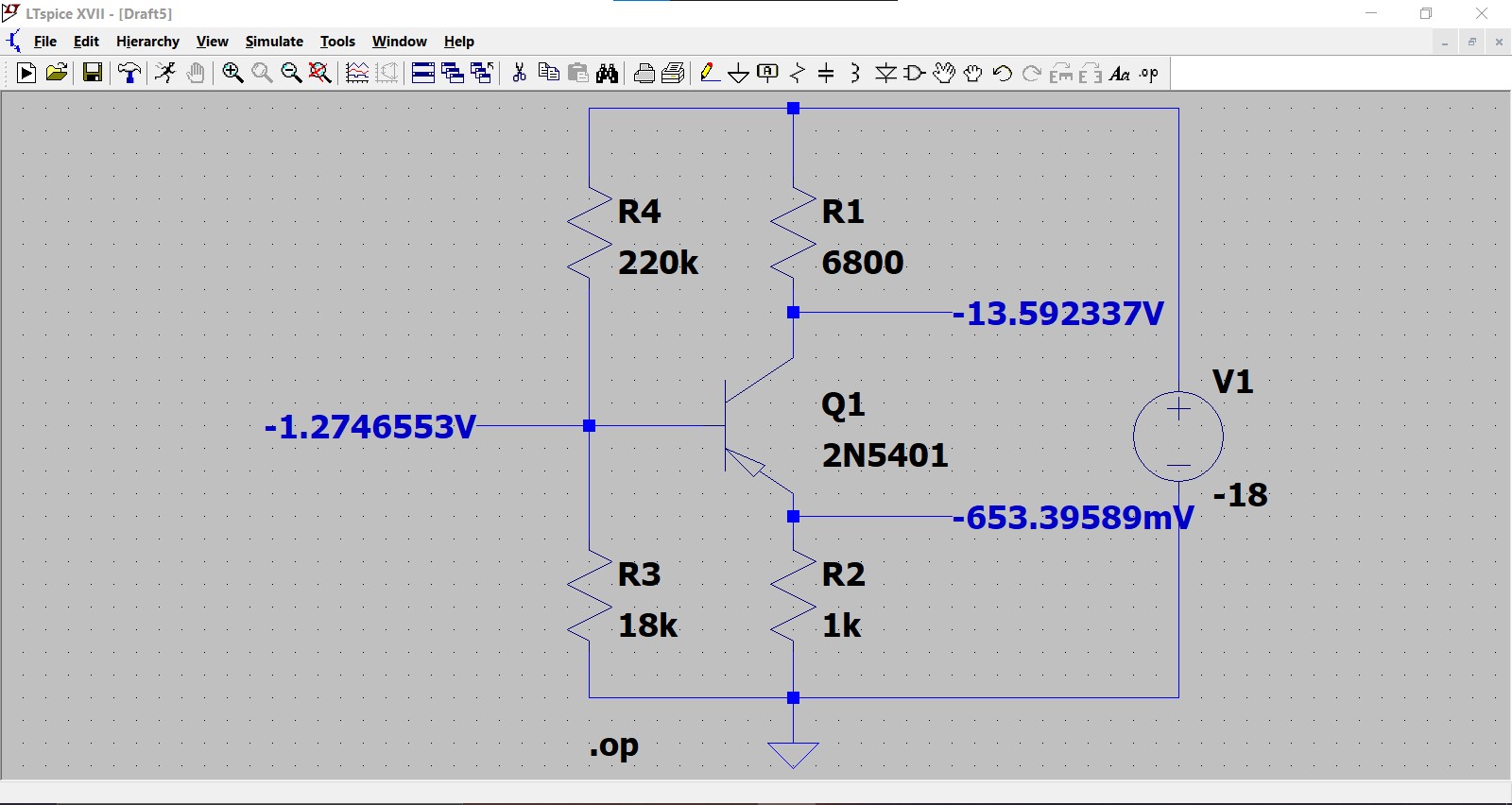

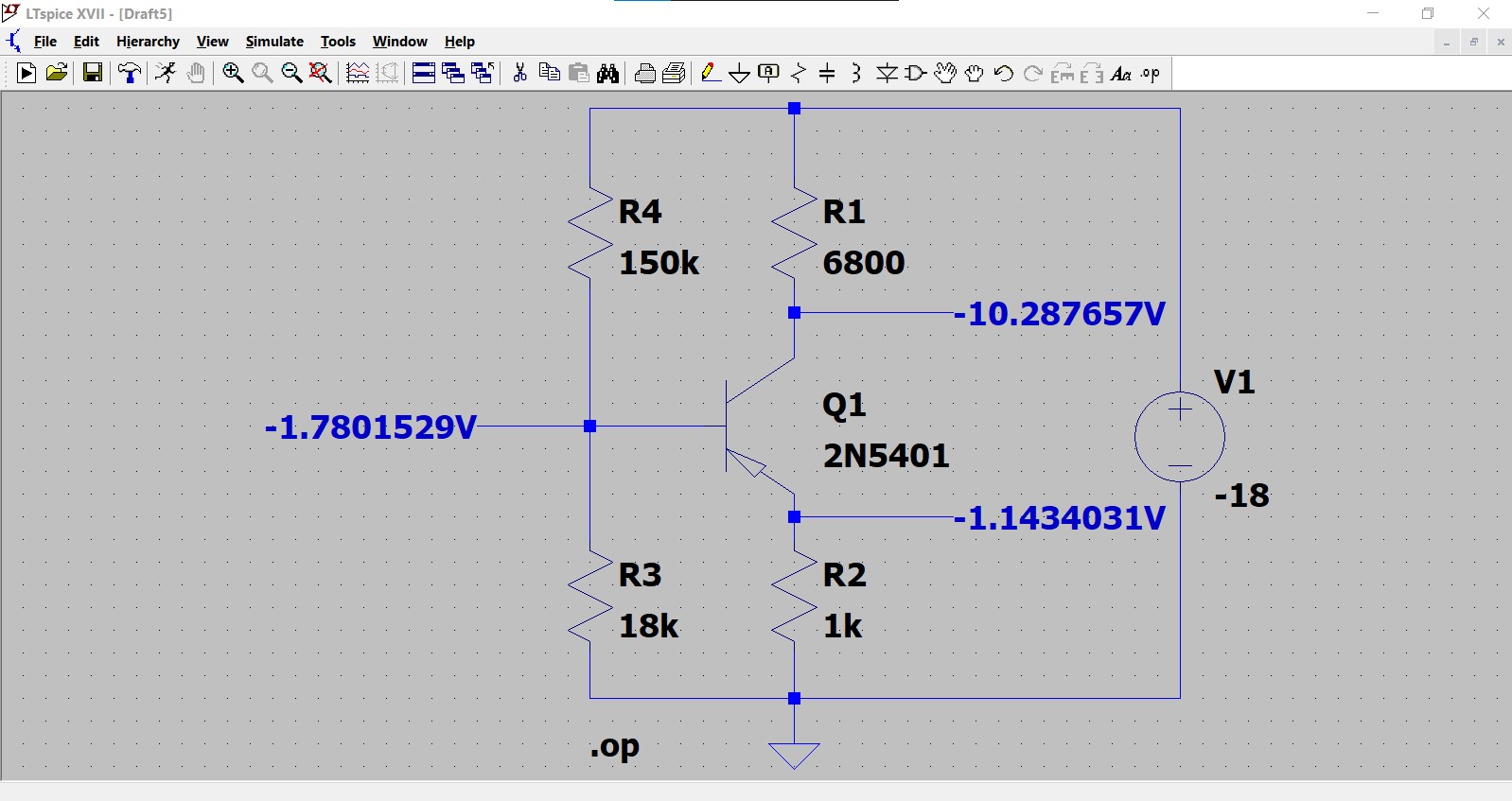

I'm just playing with that stage...
First image is what you have now with a silicon replacement, second image is with the 220k reduced to 150k to give correct biasing.

Oh wow, ok!
I will go with what you recommend. I'm only looking for the same audio performance, or better than original, without having to go crazy with modifications.

The only other parts you might get are a 150k and lets say a 120k resistor. 0.25 watt is fine here as is 5% tolerance or better.

The -9 volts on the collector is a voltage to aim for with the biasing. With it set to approx half the supply the transistor can swing equal above and below that point. If the bias point is off (to high or to low) then the maximum voltage swing is limited and the stage would clip prematurely on either top or bottom of the peaks.
