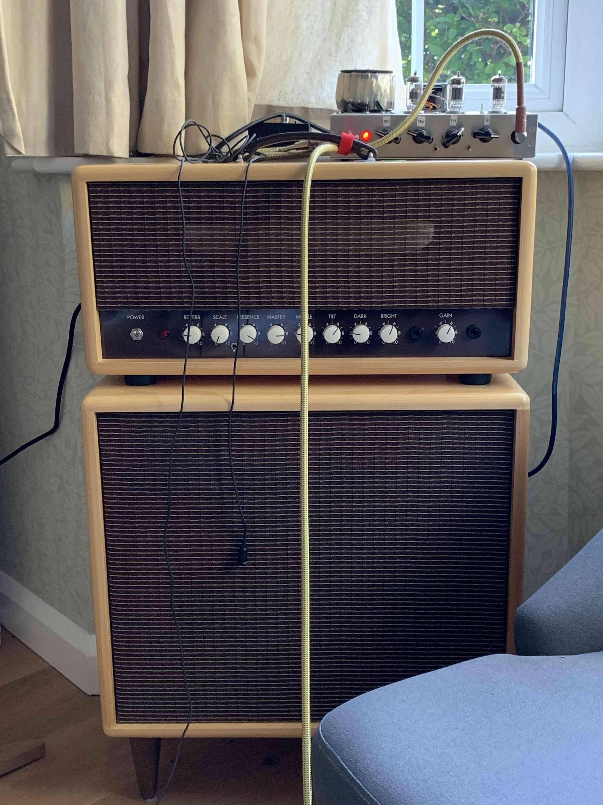

Ah, in that case you're covered - that's why I made both 18W and 2W versions to have a good starting point of a 'proper' sounding amp at both levels. 2W is still too loud. With the scale control though you can get some nice PA-style crunch from the LTPI at ~10mW output. It's sitting in my living room and I play along to backing tracks etc playing on the TV, so it's at conversation / not annoying neighbours level. I try to have the clean-to-mean thing happening so I can set and forget at the amp, use pickup selection and the vol/tone controls on the guitar to adjust from the couch without having to adjust the master volume every song. But you definitely notice it sounds better when you push this and the speaker starts to move slightly etc.
Yes, the Studio is more mature than the FF. The NFB and cancellation of 2nd harmonics(?) make it sound more like a 'proper' amp - lot's of time went in to voicing the power stage apparently: NFB calculation question - 4-4-0 / October Studio - The Amp Garage

I'd recommend my Mutineer Studio with the scale control (perhaps have it on a switch rather than a pot). Leave out the FX loop and reverb. Do both preamps, as I have, to cover clean and dirty. Or just do the HG and keep it even simpler. 5 knobs and a switch.

Wow, what an amp. My favourite of the ones I've built. The volume control on the guitar is so usable, from 2 or 3 to 10. Whereas the Studio is useful from 7 to 10. Might have to investigate with the scope why that is so. Might be lower preamp voltages. Or could be the valves - using proper NOS Mulllards in the FireFly...
