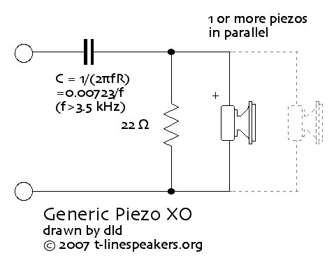

Tweeter fed in parallel from main driver through a capacitor in series with it.
Since this is a piezo tweeter, I strongly recommend connecting a 22 ohm resistor in parallel with the tweeter and a 4.7 uF film cap in series with the resistor/tweeter combination.
The 22 ohm parallel resistor makes the piezo look like a normal moving coil tweeter to the 4.7 uF crossover capacitor.

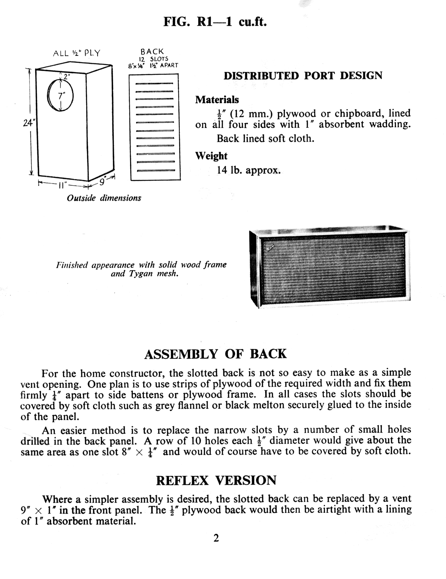

It appears that you have overlooked my suggestion that this driver was designed specifically to suit a sealed enclosure.
Its mechanical and electrical parameters may make it totally unsuitable for a ported enclosure.
Determining such parameters would require measuring equipment and a consequent outlay of cash that these drivers do not merit.
If you are interested in what these parameters are, then read the following link: https://www.monacor.com/magazine/th...he system is based on circuit analysis theory.
If the sound of the sealed enclosure is not to your liking you can subsequently cut a port opening, or vent, in the rear panel of the enclosure.
A narrow vent measuring 9" x 1" in a 1 cu ft enclosure will give a 'broad tuning' to accommodate the typical free air resonance frequency of a Philips driver such as yours.
You can even experiment further by:
  • Trapping wool speaker felt within the opening to form a resistive vent and thus emulate aperiodic loading.
  • Plugging the opening partially with wood sections to incrementally decrease the vent length and so alter the 'tuning'.
That gives lots of scope to deliver the fun you said you were after! :cheerful:

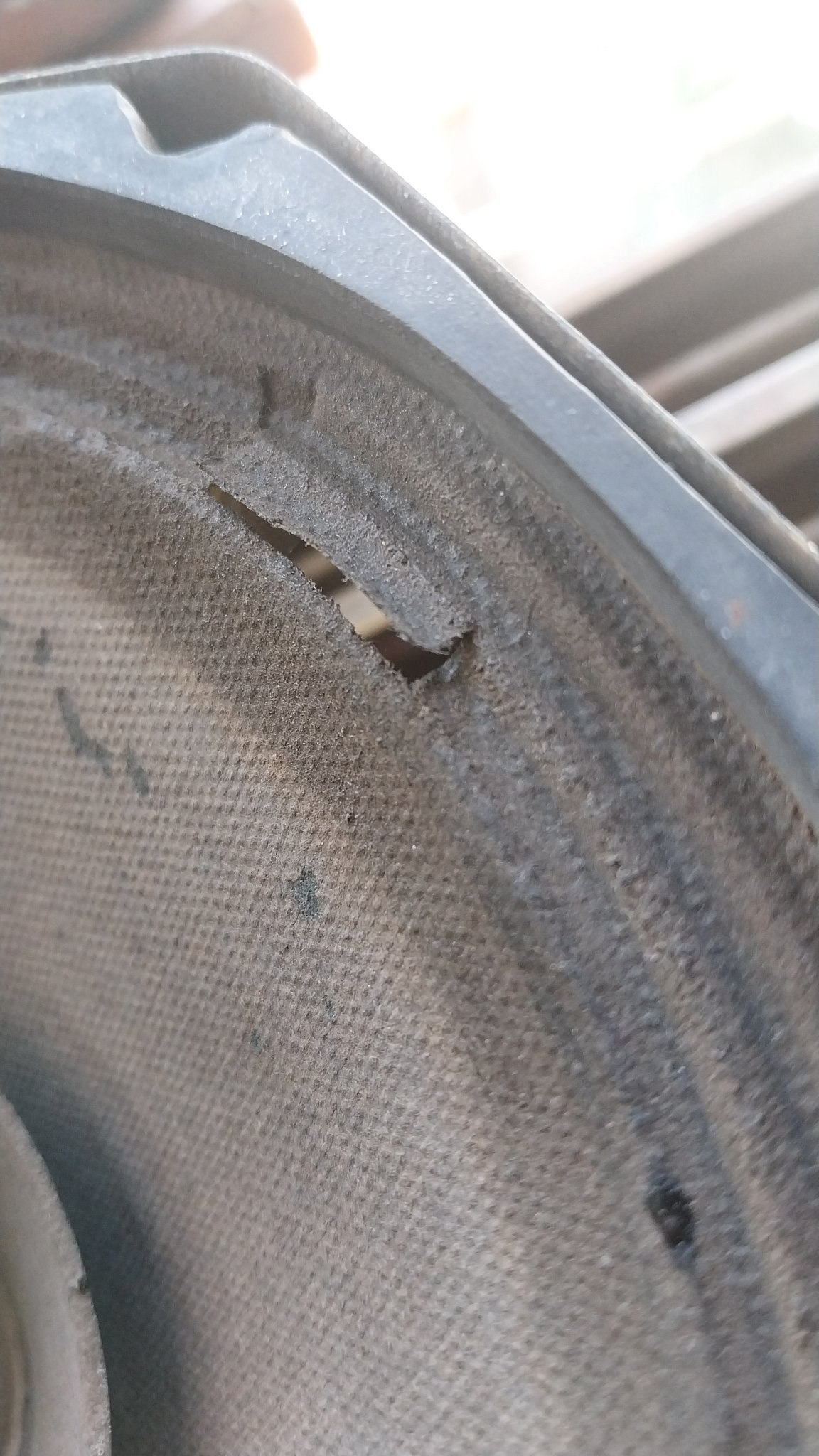

At the beginning of the thread, when I looked at Srimp's photograph, it appeared to me that his driver has a paper or fabric surround.
Consequently I reckoned that Srimp's driver was akin to the AD7063/M which has a "textile" surround.
That particular driver is specified for "high fidelity reproduction in sealed acoustic enclosures. Maximum enclosure volume 25 litres."
So, for my own peace of mind I must ask @Srimp, has your driver got a rubber or a textile surround?

According to my Philips catalogue:
  • If the octagonal 7" driver has a rubber surround then it is suited to a small sealed enclosure (7 litres max).
  • If it has a textile surround then it is suited to a larger sealed enclosure (25 litres max).
I'd really like to be sure of which type of surround @Srimp has.
However, I second the use of an enclosure that incorporates what Gilbert Briggs termed a "distributed port", i.e., a series of narrow slots or small holes in the back panel of the enclosure, lined internally with soft cloth to provide extra acoustic resistance.
In fact, in post #30, I described an alternative method of approximating aperiodic loading, which is to use a single, rectangular resistive vent.
Just for interest, I attach the old Wharfedale plans for a 1 cu ft enclosure to suit their 8" drivers of the day.
