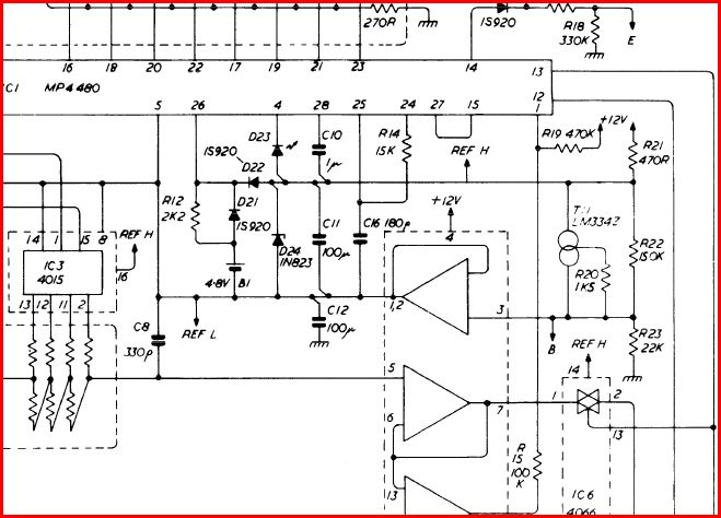

Just studied the Quad service manaul. There's a Birdie filter formed by C32 RV5 L16 C36 supposedly to suppress extra unwanted noise/tone prior stereo decorder...
Woah, quad fm4 tuner noise problem solved. Culprit was C11 and C12 capacitors. Seems like quad specifically chose some caps that suit its purpose, dadaelectronic has another guy change these caps to Nichicon bipolar cause high pitch hiss. Swap back these two old caps, I'm getting dead clean stereo sound without a hiss!!

Well thats great. I see those caps are marked as non polarised even though they are a 100uf. Now those caps would have been interesting to put a scope on and see just what was there.

I'm wondering too. Would it be because those caps are matched pair?

Would be very interested if someone has Fm4 and oscilloscope can make an effort to probe the c11 and c12 ?
Why recapping them could cause the high pitch noise..

My guess would be that the caps had high self inductance at hf that limited their effectiveness. Bypassing them with a 0.1uf and series 1 ohm might have done the trick.Why recapping them could cause the high pitch noise..
Edit... its actually quite interesting to have a real world example of where a supposed new and better part causes a problem and just goes to show that sometimes blanket re-caps and "upgrading" of parts should be done with care.

Some opamps tend to oscillate at capacitive loading. This might have happened with the TL094 and the signal modulated RefL that caused FM modulation of the local osc - all this due to too good capacitors... Probably a series 47R resistor at IC5 pin1 output could have also prevented it.My guess would be that the caps had high self inductance at hf that limited their effectiveness. Bypassing them with a 0.1uf and series 1 ohm might have done the trick.
Good point. Yes it could have been something like at work too.

I had this issue occur with an FM4 I'd recently serviced and have been scratching my head for the cause. The TL094 does indeed require a capacitor to ground with some appreciable ESR, unlike the Panasonic FC I'd fitted.
You can use a slightly lossy bi-polar, or as in my case a tantalum works perfectly in this position. There's about 1.8v dc across C11 and 6v across C12. A 10v tantalum is therefore recommended.
