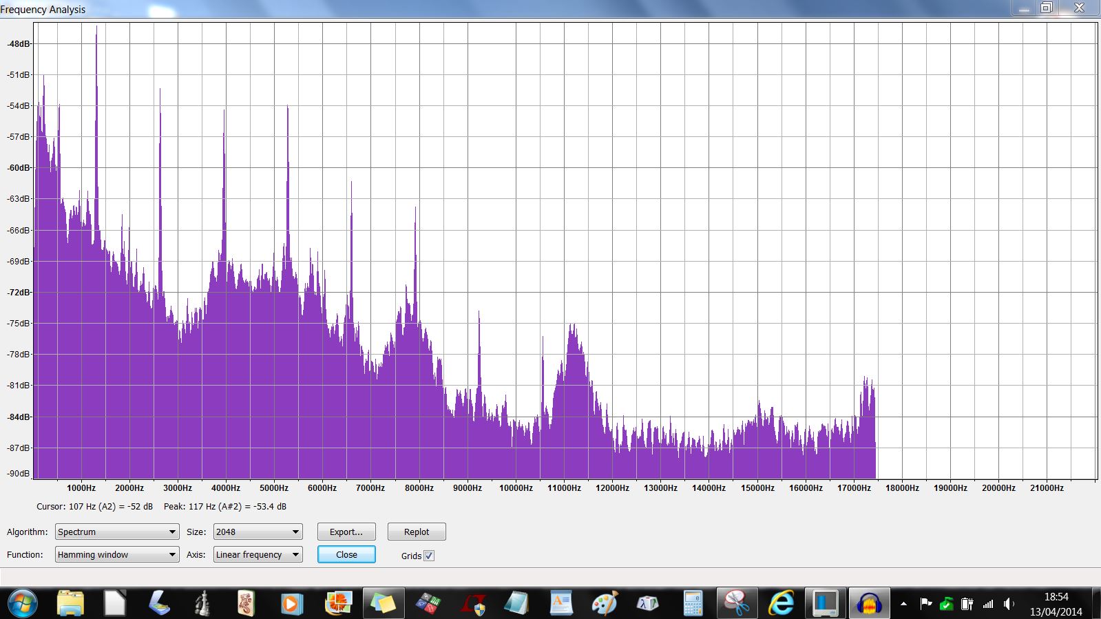

I reckon the noise does sound like SMPS noise very similar to my previous usb dac which didn't take care of isolating the usb ground and audio ground...
https://www.dropbox.com/s/shgyz0wxcxfnqw5/Voice 003.m4a
Interesting. I looked at the spectrum of that bit of silence at the start of the track and as you can see, there are definite components visible starting at 1320Hz and going up in multiples of that frequency. That is the definite "tone" you can hear. There is also a huge amount of background hash and noise.

Just saw the spectrum plot and I would say the hash is almost certainly the upper and lower filters have been widened, effectively widening the band pass filter. The function of this is to remove noise and cross talk from other channels.
