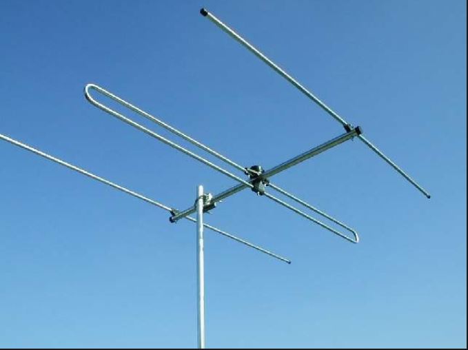

I'm afraid height alone doesn't guarantee a good signal. Glass bounces signals off it and causes multipath problems and buildings (reinforced concrete etc) absorb a lot of the signal. The signal strength meter isn't a guide either because they are often "customer orientated" and show full strength for totally inadequate levels. That looks better in the shops rather than it showing "poor signal" most of the time.
Sorry if that all sounds very negative but its the way it is I'm afraid. So you need to be 100% sure the tuner is or is not faulty and that means, at least on an easy to try level testing it on an outdoor aerial that is known to deliver a good signal that gives noise free reception on several tuners.
To test it accurately requires an FM stereo generator and RF modulator where a known level can be applied to the aerial input socket and the signal to noise measured.
Have you tried pulling the aerial out a little (to attenuate the signal) and see if that forces it into mono ?
Something like this would be a "minimum" for an outdoor aerial in a primary reception location for noise free stereo reception.
Roger that sir.
I'll invest an outdoor aerial first before my next attempt to mess around with FM4.
