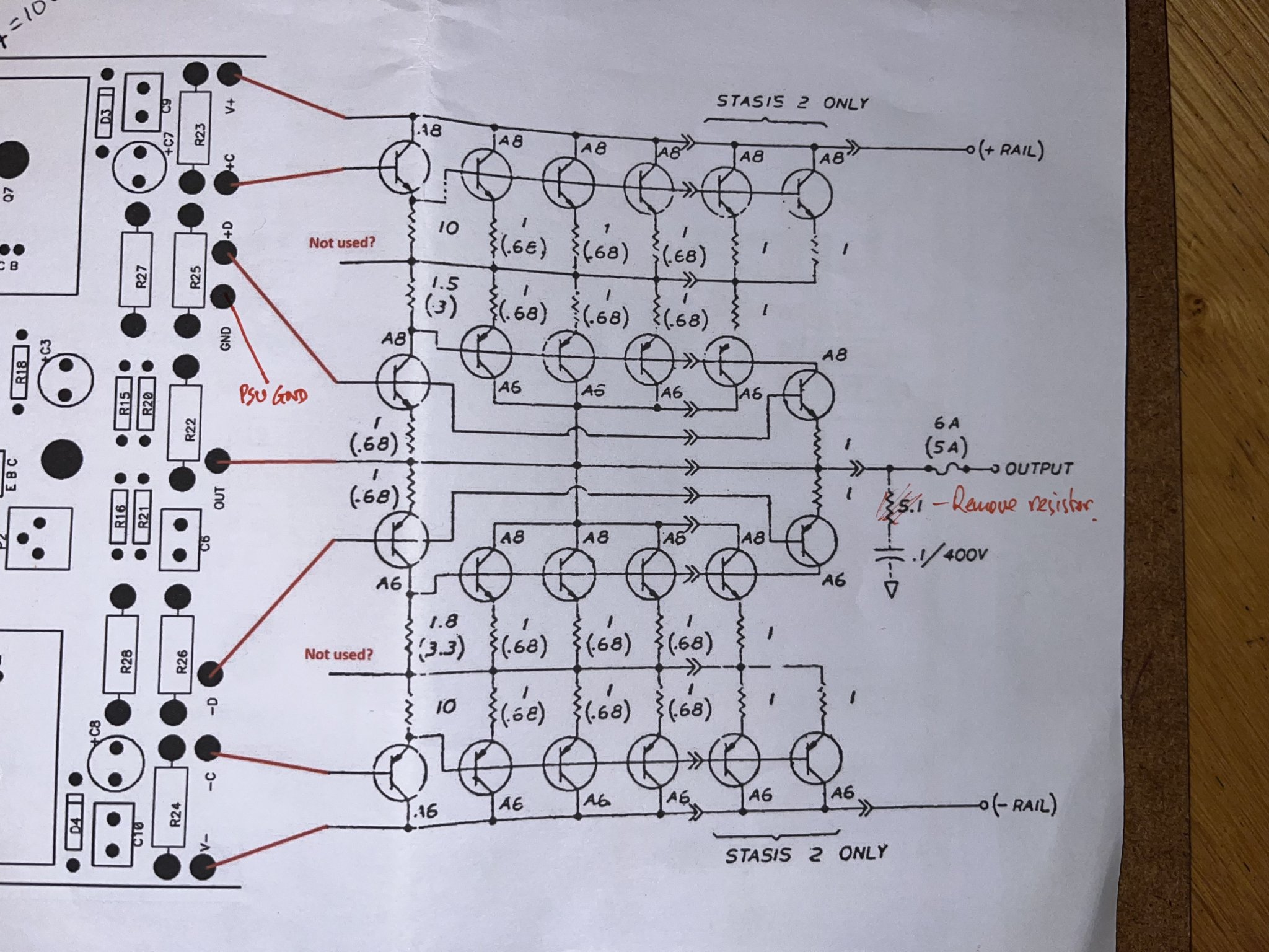

I should add that along with the burnt boards and components ( resistors and 2 faulty transistors) three output transistors were found to be faulty, these were the original Motorola A6/A8 ones and the these were all on the one channel, on the other channel we could see that all the transistors are the newer Motorola mj15022/23 ( before the G versions )
I will be replacing all of the A6/A8’s .

In my opinion, what you have bought was a piece of junk, I hope you did not pay much. No one in his right mind leave transistors floating in mid-air like that, anyway, and asks for trouble. You will have to carefully go through the board and check if any of those leads are close enough to touch or if debris had got stuck in it. When you bought that, what did the seller claim to be wrong? Have you been able to identify the burnt component on the PCB. This design is marginal and anything could have caused it, judging by the poor built quality.

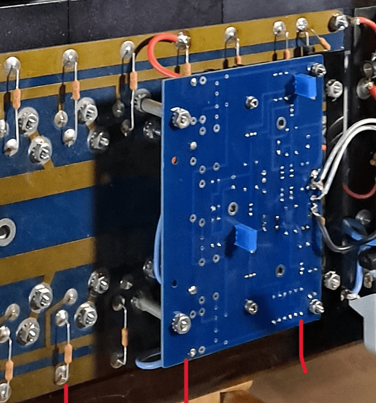

All output transistors now fitted and the new boards are complete but not yet mounted.
I screwed up by not ordering enough 1 ohm resistors so I now have to wait for those .
New 22,000uf power supply caps arrived today ( Nichicon )
I had a go at setting the trim pots before going to work this morning and discovered that one of them wasn’t altering when I turned the little screw so that meant yet another email to my mentor ( Gary ) and as always he pointed me in the right direction ( I sweated all solder joints again) so they’re now working on both boards and so the boards are ready for installation.

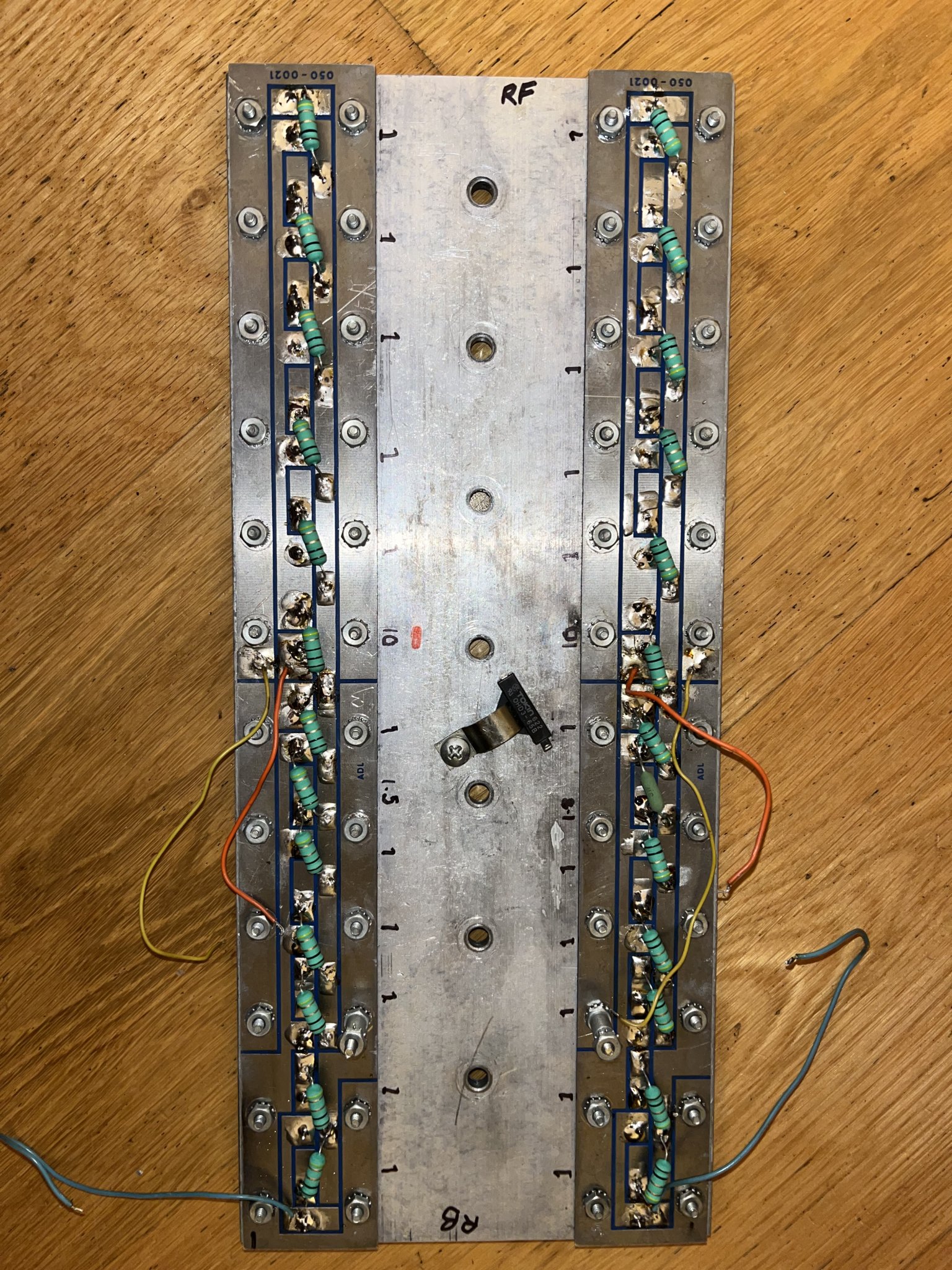

There’s still something that I’m not 100% sure about despite drawings, Gary’s help and even copying the original boards before I started and it’s the Resistors , I’m not confident that I’ve got them in their correct place on the heatsinks.
As long as the 1R8 is on the neg side and the 1R5 is on the pos side, then all other resistors are correct. Looks good to me.

So if you can, it may make it easier to adjust the trim pots from the top if you place them on the side facing the capacitors. Side adjust pots are also key. These will get you started so that you can confirm that everything is smoke free.
In the pic below, the trim pots are facing down because the whole channel is upside down. When installed in the amp, the trim pots will face up. It is also helpful to use a fine tipped sharpie to put a "O" for offset and a "B" for bias.

If you do that make sure the bias pot is still at max resistance for start up - if you flip by mistake it it will be zero in the circuit - you don't want that. Also make sure the 2 heat sinks are clear of the OS. Also, Mikes amp is an S500 , not a Stasis 2.
To make your self 100% sure on the OS resistors, get the DMM on resistance range and measure each one as follows:
From the RF end you have marked - the pos side is on the left vertical row and neg on the right vertical row - there are 13 resistors on each side. Starting at the top end you have marked RF.
POS.
1R
1R
1R
1R
1R
10R
1R
1R5
1R
1R
1R
1R
1R
NEG.
1R
1R
1R
1R
1R
10R
1R
1R8
1R
1R
1R
1R
1R

yes, checking the clearance from the heatsinks and the OS is a good idea. I had to add washers to space mine out from the OS. I had forgotten about that...If you do that make sure the bias pot is still at max resistance for start up - if you flip by mistake it it will be zero in the circuit - you don't want that. Also make sure the 2 heat sinks are clear of the OS. Also, Mikes amp is an S500 , not a Stasis 2.
The reason for the trim pots being out is so you have a clear path to them. Looking at the boards from the top of the chassis when the channel is installed, there will be components in the way.
I have sent you the top adjust trimpots Andy - to do what Mike has done you will need the side adjust trimpots - Bourns 3296X-1-501LF, so you can mount it so the adjust screw faces the top of the amp.
