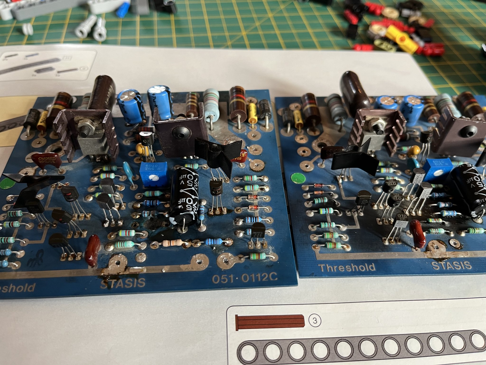

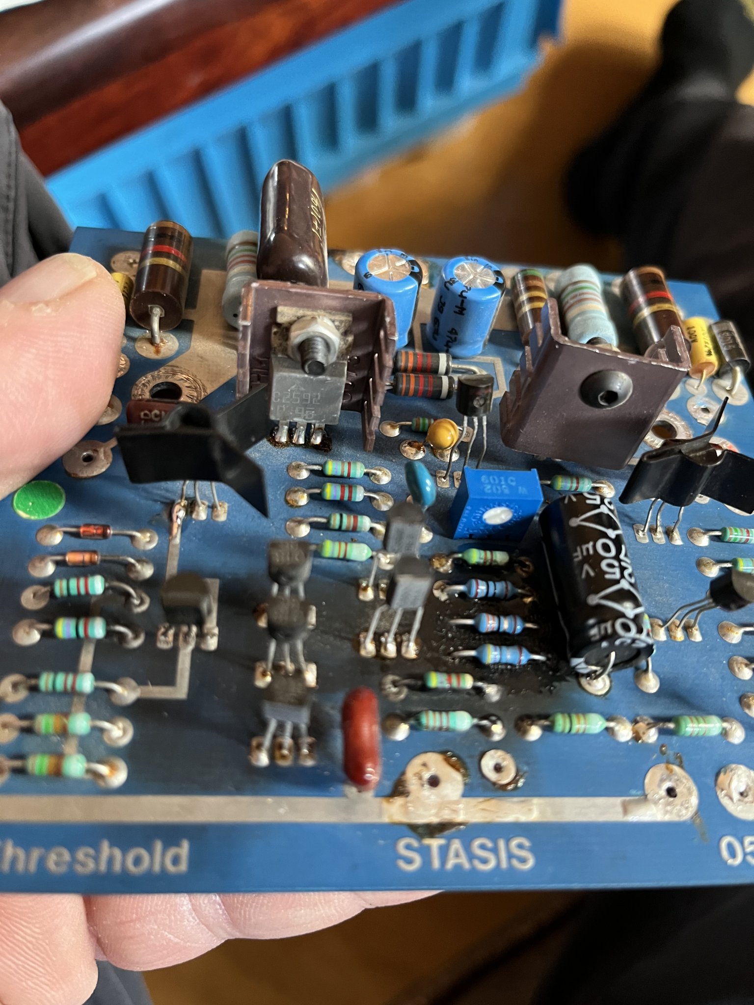

Help please with my poorly Stasis 2
There is 1 mpsa92 on each board . There are 2x c550c’s on each board and they are right next to the damaged resistors
OK, we have our first problem.
The MPSA42 when looking at the flat on the body has pins left to right of E B C
The BC550C is opposite, being C B E.
I am assuming the BC550's have been fitted where there should be MPSA42's. What does the other working channel board look like where these are?
Both boards have the same transistors in the same place and oriented the same way .
Are these 2 transistors clearly marked as BC550C's?
As I said before, the big issue here is the fact that the pcb is not silk screened with the components. I think the next step for you if you want to be in a position to repair these 2 pcb's is to print out the schematic and label the components from left to right, ie:
Resistors R1 to Rx
Capacitors C1 to Cx
Transistors Q1 to Qx
etc....
Then you need to identify the resistor values by being able to read the colour bands, google will help with that.
Then you need to carefully draw out the pcb an a large sheet of paper, and identify the components and label them as you have marked on the schematic.
By doing this you can then identify each transistor, its type and polarity (NPN or PNP), once each transistor position is identified, you can check what each pin is, by looking at the circuit to see what components it is attached too. Familiarize yourself with the transistor symbol to identify if NPN or PNP.
An NPN transistor symbol has the arrow on the emitter pointing away from the base, and a PNP transistor has the arrow on the emitter pointing towards the base. (the arrow identifiers direction of current flow when the transistor is turned on).
You really need to be able to identify each component on the pcb and be able to match it by value and component number to a marked up schematic to be able to trouble shoot and check each transistor and which way around it should be inserted.
I dont know why whoever repaired the amp before has used BC550 transistors which have the C-E pins reversed. These should be inserted 180 degrees form the original MPSA42's for the amp to work. I would get rid of those and get hold of new MPSA types which are still available from Mouser , Farnell, RS etc...
