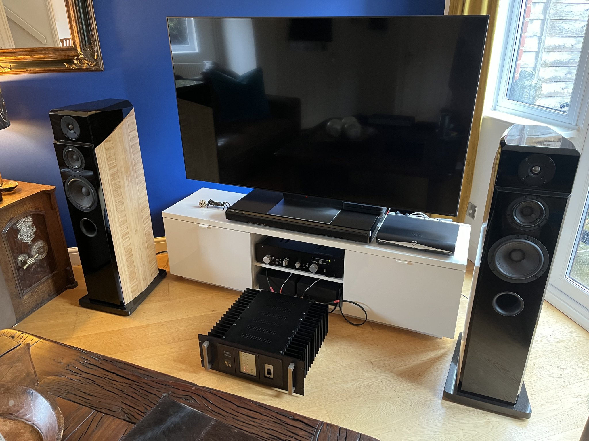

Well Andy, apart from those great looking speakers, the Stasis 2 looks brand new as well.
It will take a while to bed in, as it is all new inside apart from the transformer that is.
Any initial listening thoughts.

I didn’t expect it to sound anywhere near as good as it does Gary , fantastic! And it’ll only get better 😁😁
