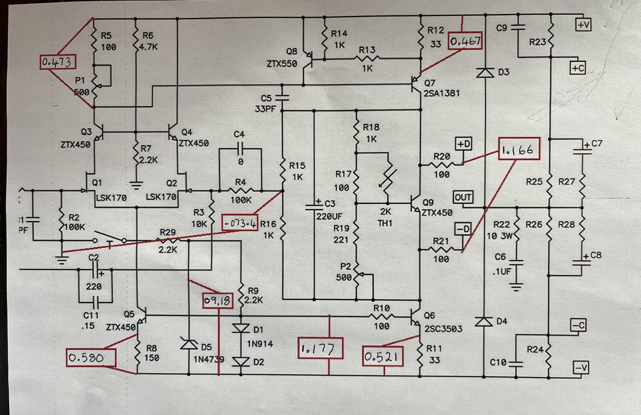

Nothing connected to FE except D+ and D- and GND ( and out & GND speaker terminals)
D+ and D- = 000.2mv ( turning P2 pot does nothing)
D+ and GND = 2088mv and constantly dropping ( turning P2 pot does nothing)

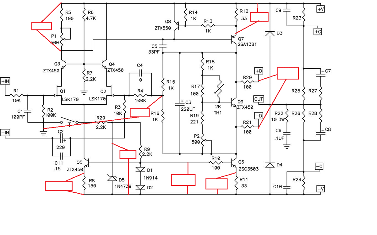

OK, if you're in the mood
Print this
inputs (both) shorted to GND, "T" closed (confirmed prior to powering on with ohmmeter)
connected PSU - both rails and GND, but no OS (leave it in other room)
measure DC Voltages for each red rectangle, write in rectangle
red probe is upper line from rectangle, black probe is lower line from rectangle
when all done and written in appropriate places, post here

Please confirm to this simple man if this is how I should be connecting the FE ?
Red ( positive from psu ) to V+ on FE
White ( neutral from psu ) to V- on FE
Inputs go to GND
I have tested the thermistor which before powering on is at 093.4 ohms which drops with heat ( hairdryer)

Well I so hope I have gotten this correct….
will have more time tonight
now - preliminary (first morning coffee then must fly) - it seems everything OK with FE

in meantime, you can do few more things with FE measurement:
  • P1 - gimme measurements for both extreme positions (min and max) - repeat measurement across P1+R5 and write here (both cases)
  • I assume P2 is in max position for this measurement; dial it all the way in other position, gimme measurement D+ to D-, write here
  • write here Vdc for rails during the test; V+ and V-, black probe to GND in both cases
  • same for C+ and C- points; I need to be sure these are appropriate before connecting OS modules

I can't help you with task of reading pcb against schematic
you alone must struggle and succeed in that, or you'll never be able to finish what you started
to repeat, and that's crucial for measurements - for each red rectangle I drew on schematic, there are two lines going from rectangle - upper one is red probe, lower one is black probe
when written "ref. to GND" that always means black probe to GND point ( anywhere in circuit, but most sure at pad where GND wire coming to pcb)
for now, I see fishy value across P1+R5
take your time, do it properly, or it will be no-go, you'll have door-stopper instead of singing amp
