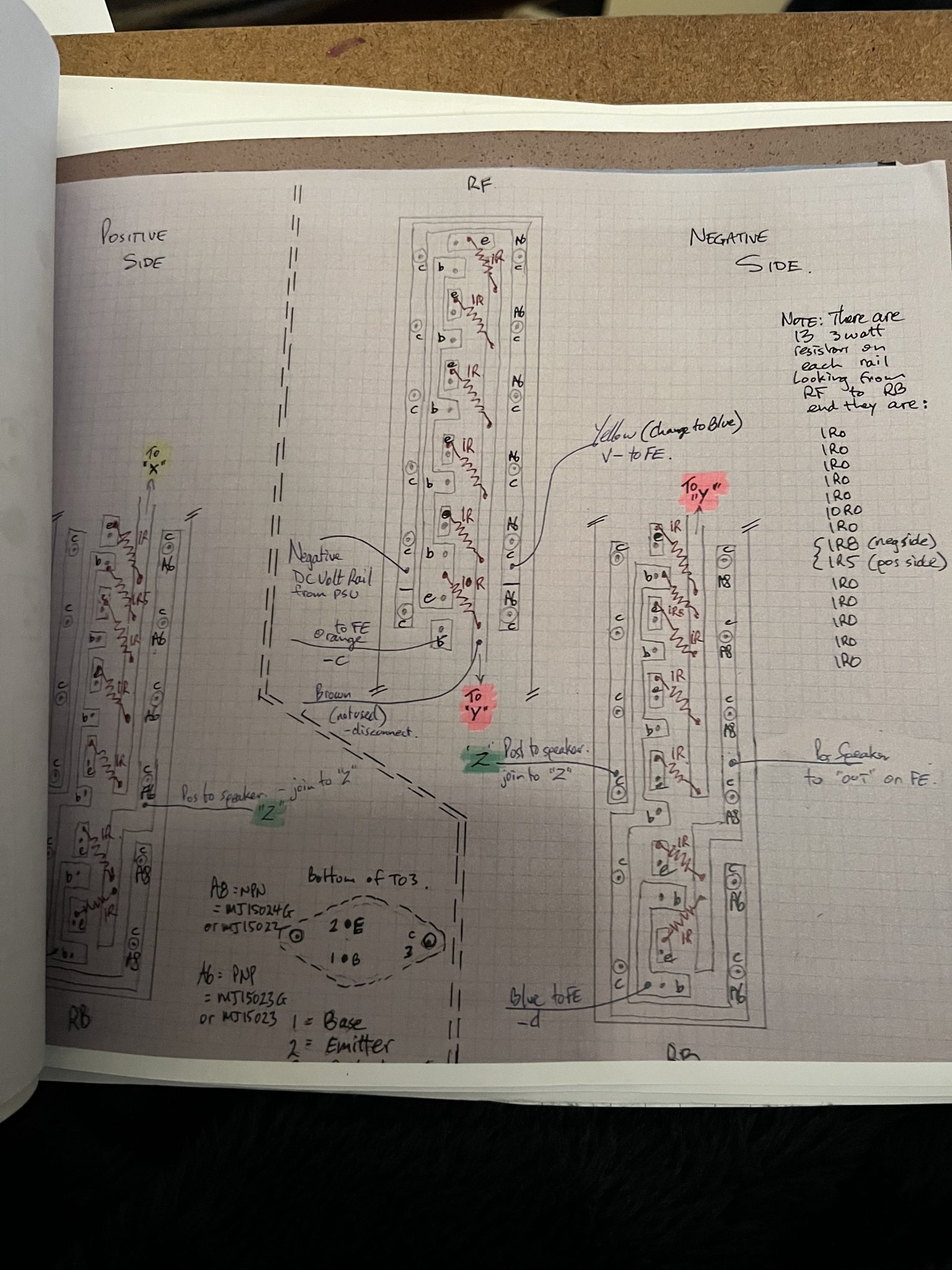

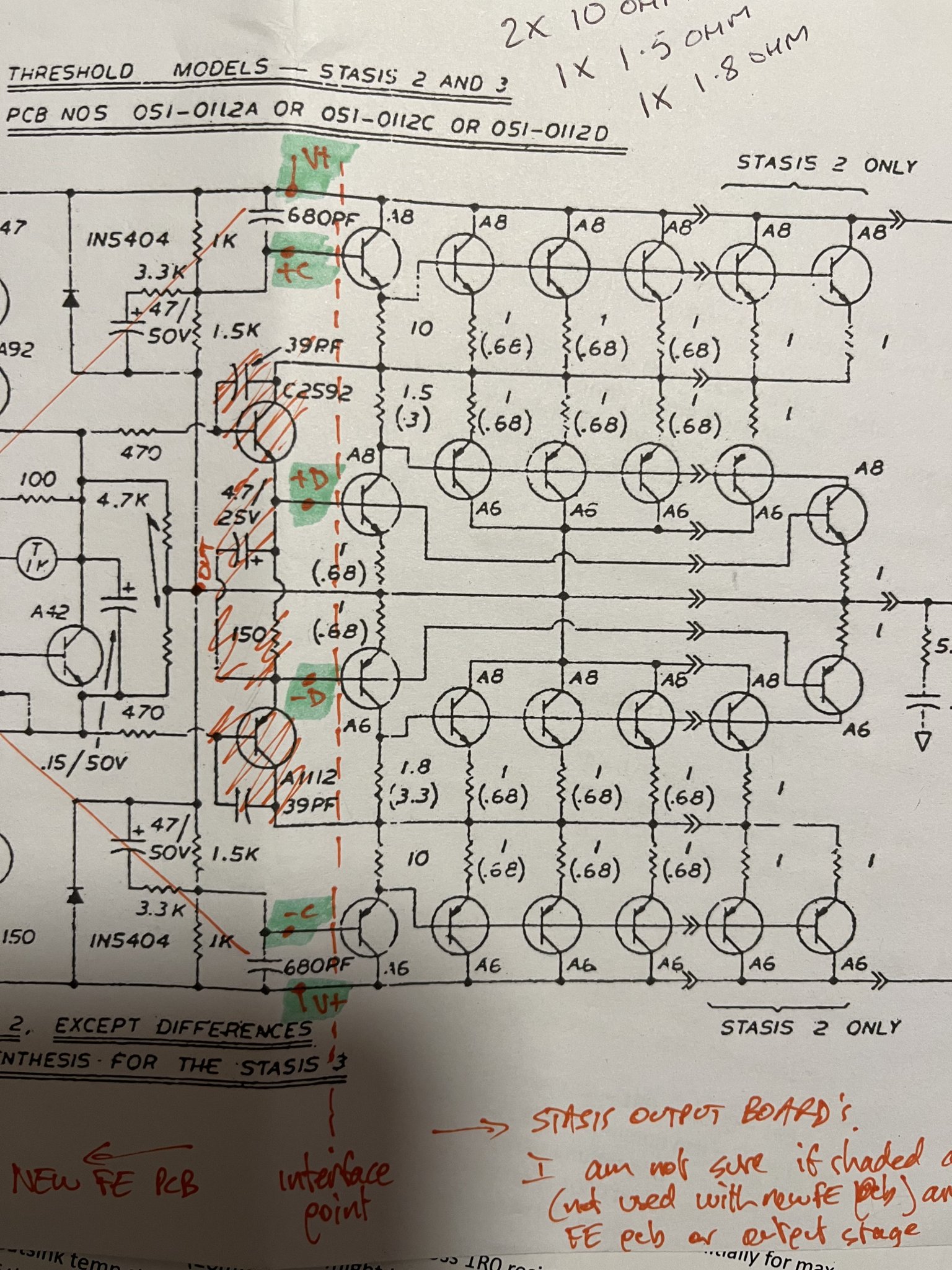

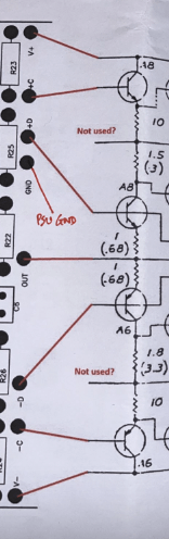

Could the issue have anything to do with the fact that originally there was also a brown wire that came from the OS to the board ? There isn’t anywhere for this wire on the new board so I was told to discard it .
I can't tell if the wiring is really correct to the output stage there. If this amp was in front of me I would need to go through the learning curve of identifying the parts to verify with absolute certainty that +C -C +D -D from the front end really go where they are supposed to. With that confirmed, I would be looking for current flowing through the string of components in this first stage on the output board.
Being totally honest I can’t understand the drawing ( I’ve tried believe me )

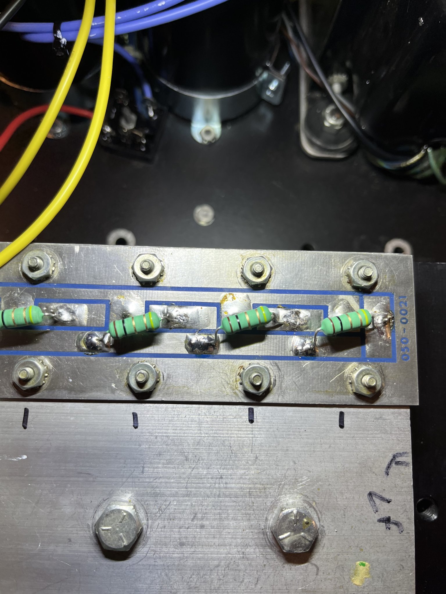

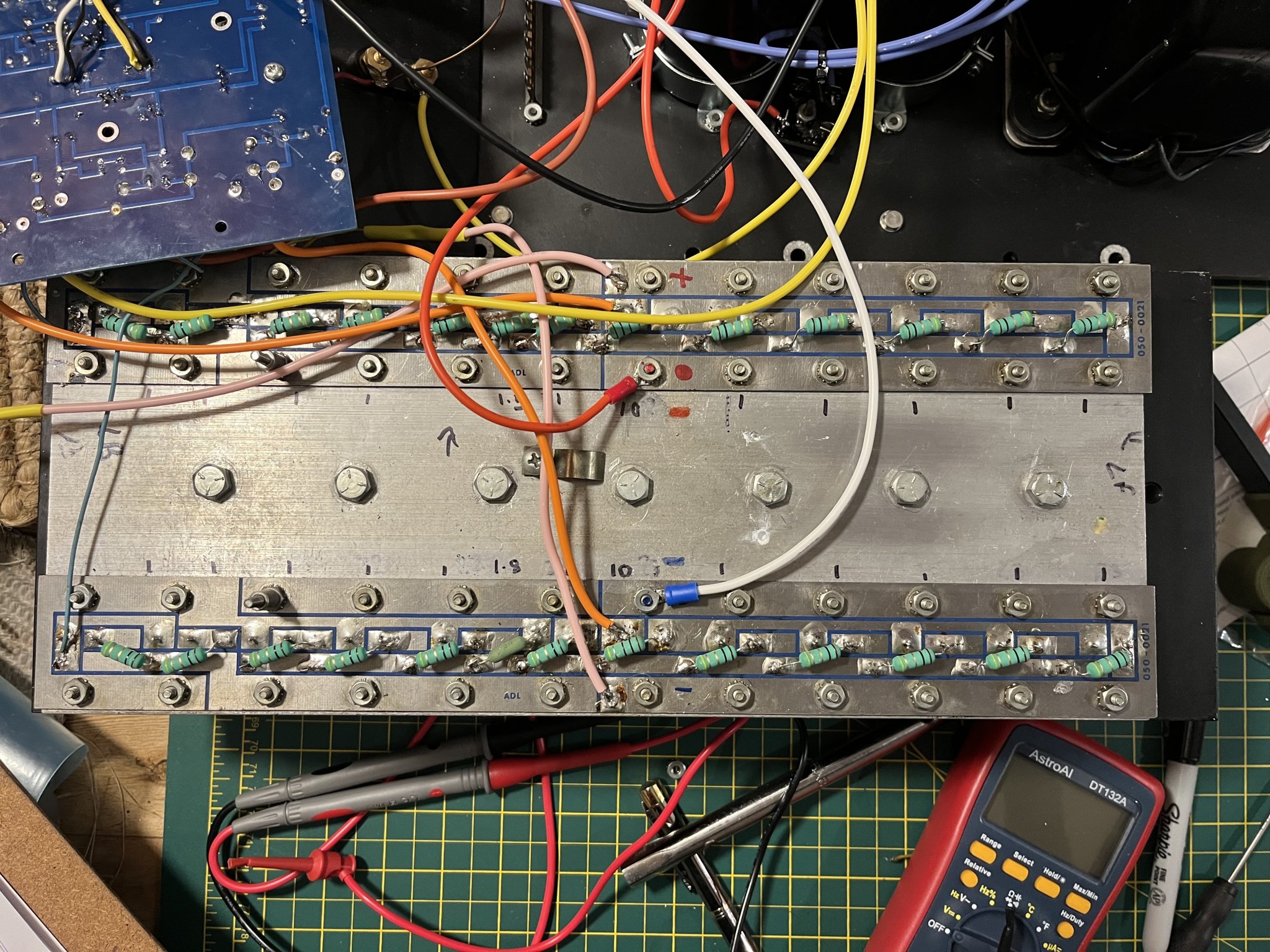

Yup, that's it. It looks like it's bridging to me.
Also, take a close look at the rightmost leg of the first resistor on the right. Probably not bridging there, but awfully close.
I'd be inclined to clear that bit of solder on the blue line at the lh end of resistor 3. It's probably loose and could end up anywhere anytime...
Reactions: TheFinisher
Well spotted, it was a bit of solder that I’ve now blown off . I’ll check out that 3rd resistor, cheers.

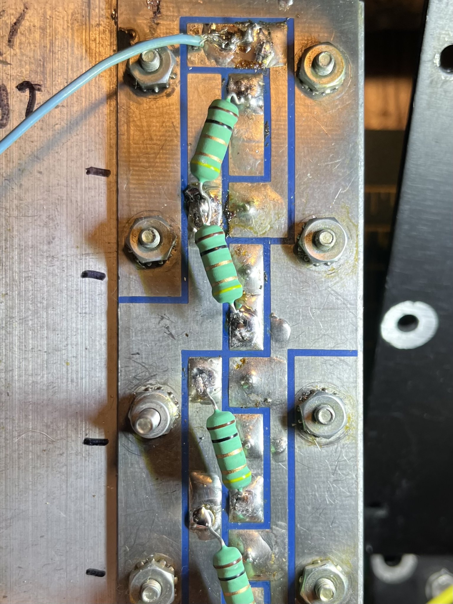

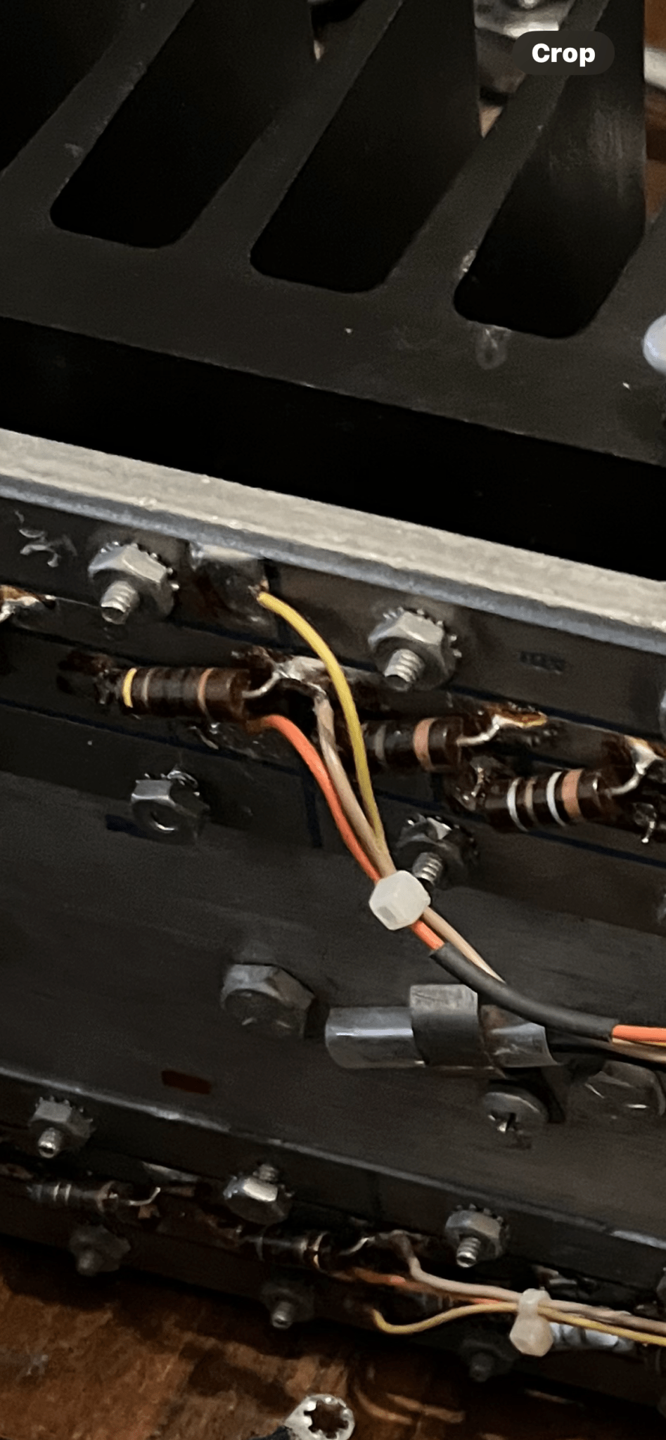

One thing, looking at the photo I've attached is that resistor correct? It seems to be different to the others, top leg soldered in correct place?
Take a look at both of those output doobries. From the photos I can still see what appear to be bridges across those blue lines.
Give them another going over with a MK1 eyeball. I follow gaps between tracks/pads with a cocktail stick and magnifying glass to keep my focus in one place, or take a sharp photo and zoom in then slowly scroll...
You are close to getting this thing working, don't leave any turn unstoned.
