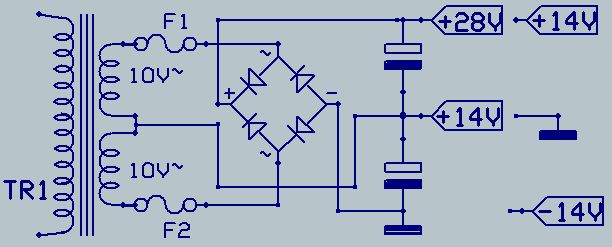

You cold do it like this.Depending on witch connection goes to the ground
it is a symetrical supply or a simple-double voltage out.

Thanks Mooly and Ketje for the help. Yes I tested it (I'm waiting to get oscilloscope in the mail) It ends up being 26.5v DC. I really like that LM317. That is nifty. I'm sure I will end up using that in the future. I used a voltage divider with resistors 4.7k and 2.7k and ending up measuring about 9.5 volts. Its a simple preamp I was powering with a 2n3904. The resistance the battery sees was between 68k and 115k depending. So I shot for a voltage divider an order of magnitude lower in resistance (or higher in current) so the load wouldn't effect it much. It worked very well, but of course isn't very efficient. Its basically a distortion with gain control which will go into an amp. I need to make a buffer going to the amp, and have a lot of trouble getting op amps to work right. I will repost another topic or look through some. I made such a basic op amp buffer with a battery and I can't understand why it doesn't work. But I will post this in a different section I think. I have such a hard time getting op amps to work right for me. That's why I'm using transistors. I may make a jfet buffer, I think that would be hard to mess up.
