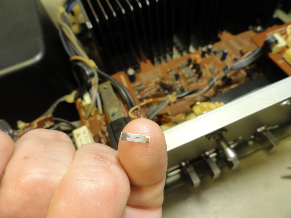

Hla, necesito conseguir el interruptor deslizante remoto del rec.selector de mi SUV7 TECHNICS, no lo puedo encontrar por ningún lado, tiene una llave de 5 posiciones que va en el frente y un terminal que se coloca en la selectora al fondo del equipo. Muchas gracias!!!!!!!!!
Please post in English as per the forum rules.
Hla, I need to get the remote slider switch of the rec.selector of my SUV7 TECHNICS, I can not find it anywhere, it has a 5-position key that goes in the front and a terminal that is placed in the selector at the bottom of the equipment. Thanks a lot!!!!!!!!!
Help please to identify switch type

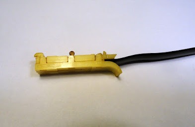

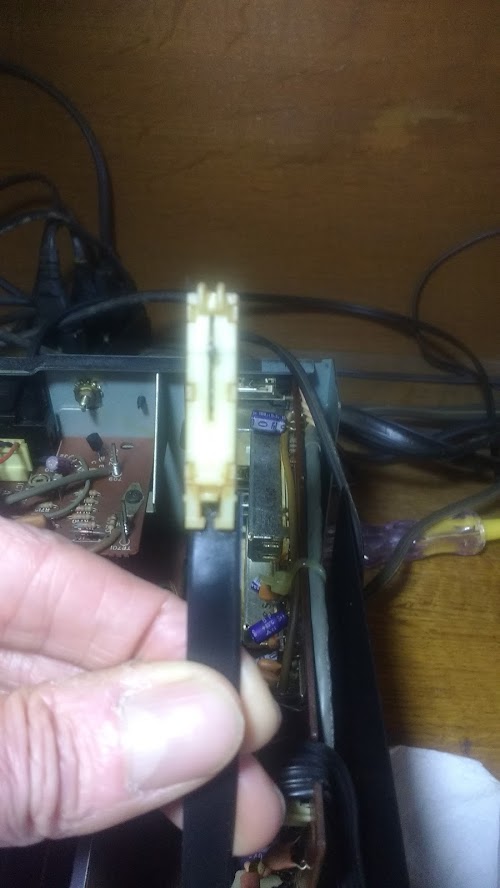

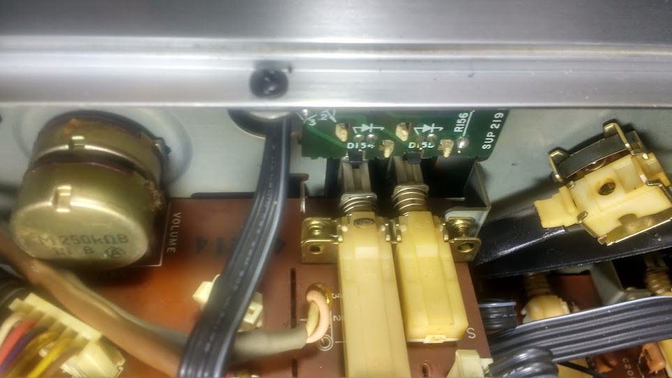

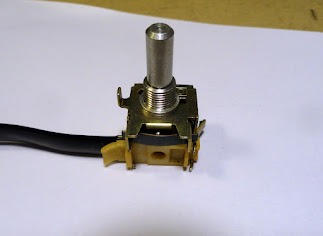

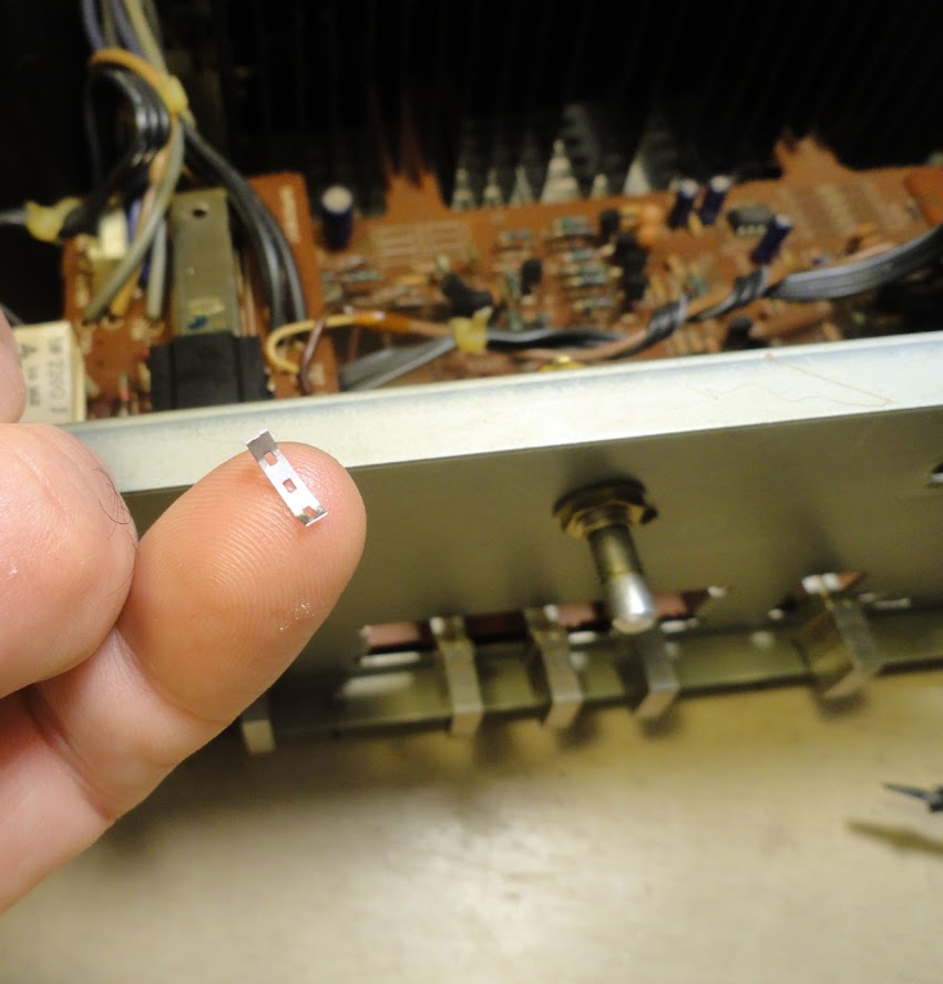

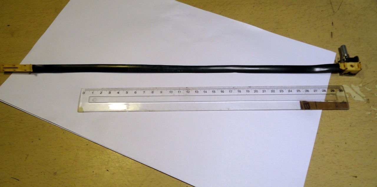

Hla, I need to get the remote slider switch of the rec.selector of my SUV7 TECHNICS, I can not find it anywhere, it has a 5-position key that goes in the front and a terminal that is placed in the selector at the bottom of the equipment. Thanks a lot!!!!!!!!!Attachments
Terminal aplicado al frente del equipo, parte interna.jpg71.9 KB · Views: 88
That looks like a unique manufacturer specific switch. The linkage is a mechanical flat metal flexible strip allowing the control on the panel and the actual switch to be located in separate locations.
A lot of commercial gear (the likes of Sony, Aiwa etc) used these but they were not off the shelf parts, they seemed unique to the product,
The part is ESA2682.It is as you say, that's why I'm looking for someone who has it or tells me who sells these parts, either new or used. Thanks a lot.
Hi JUCATO, I have the same problem with that, i have a technics su-v5 where the cables of input selector and rec selector are broken now, those cables have 10 000 cycles of use as said the fabricant, i founded some similar cable slider https://www.ebay.com/itm/255144520808?hash=item3b67cc6c68:g:X50AAOSwLTZfWyTf this not fit directly with the switch, but you can adapt the cable to work with the internal slider selector, i try to do that but unafortunately works to reverse direction the reason is because if the selector is on the tape2 position on the input selector the selector slider works to reverse direction its working with the aux input, if you put tape 1 this work with the tuner selection and so, the unique values where match this selector is on the central position, because this selector is not the original its a rare selector Alps and this model is not found actually on the website of alps electric co, i hope you can use it for a while, i will try to replace this ESA2682 with a rotative 2 way 5 positions as an experimental solution but i dont know if this works to the end..The part is ESA2682.
Study the schematic to find out if it is only switching sources or also REC outputs.i will try to replace this ESA2682 with a rotative 2 way 5 positions
In the latter case You need a switch with perhaps 4 decks because of the tape copy functions.
