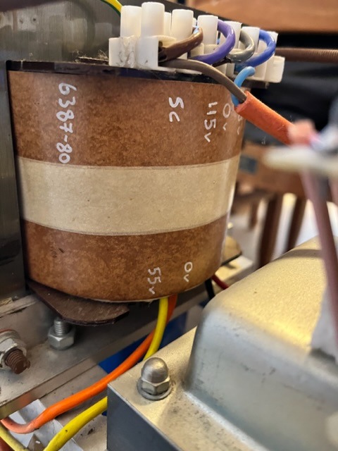

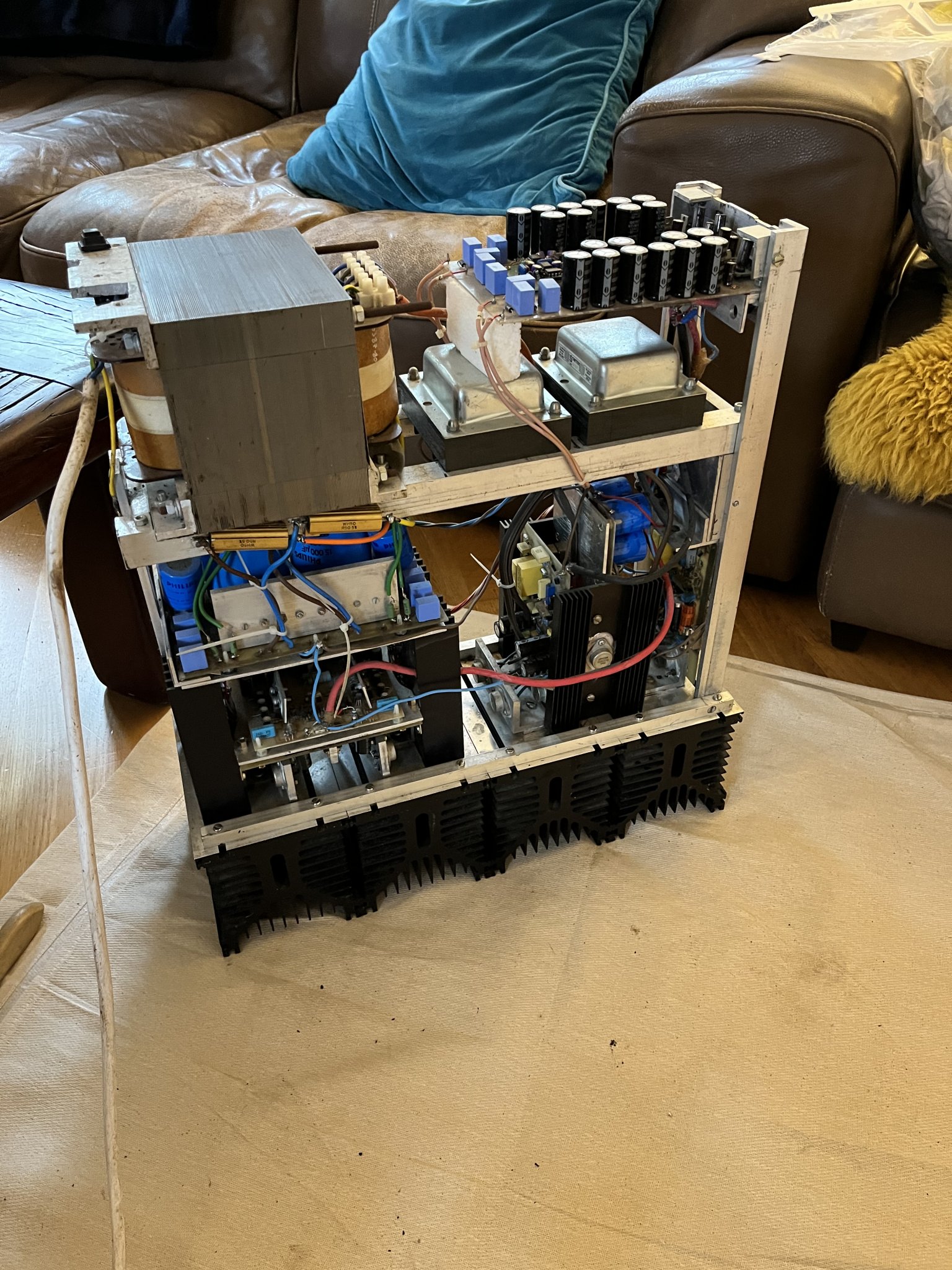

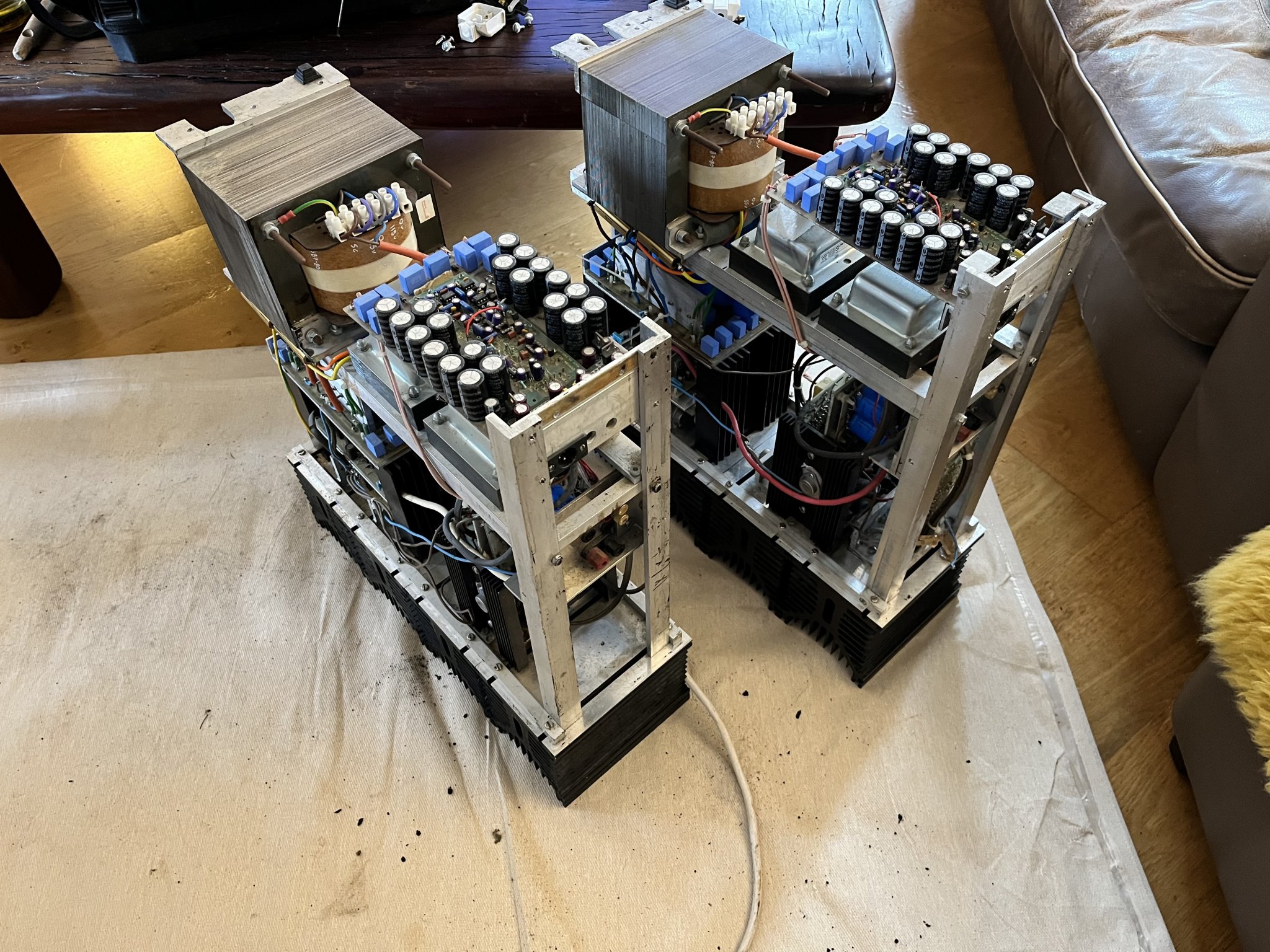

I picked these up a few weeks ago, all I know is that they’re apparently 1000watts each , built by a medical doctor whose hobby was diy hifi .

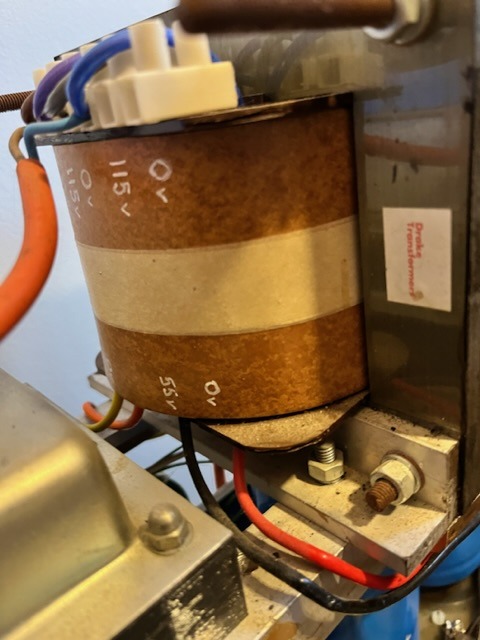

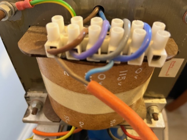

They are rather intimidating to look at with those huge Drake transformers and then there are more transformers ( Sowter ) I can see quite a few mosfet transistors, they drove 4 sets of speakers, the fronts ( diy built) were around 6 ft tall and the rears were built with ATC drivers.

Some close ups, enough to read numbers on the outputs, will be nice.

one solution would be to get you a big 240Vac to 120Vac transformer to wake them up gently and put a suitable fuse between the two (even undersized), all that only to wake them up gently by supplying them with 120Vac.
Also look at the service voltage of the capacitors of the "power" part to give you an idea of the supply voltage of the power boards.

However I doubt that even that massive amount of heatsinks visible on the pictures would be enough for 1000W (possibly with forced cooling, maybe).

Outputs meant output transistors, not the supply transformers.
If you post transformer photos when asked for part numbers on outputs (output transistors, which is what I expected in this device), you are very new to this field.

I can anly see a few power transistors, not enough to for a 1000W rating.
Try to take as many detailed photos of all the pcbs as possible.

I did doubt that the mentioned 1000w would be correct.I can anly see a few power transistors, not enough to for a 1000W rating.
