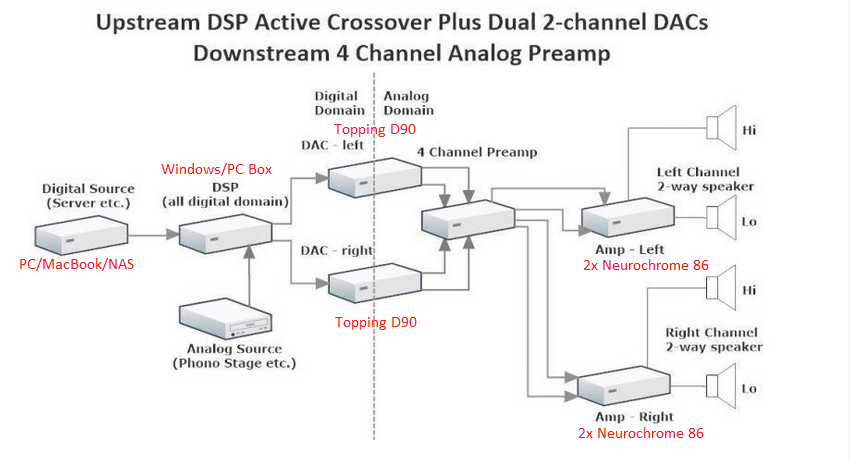

Can the required equalization if done via DSP make them sound as good as if done with passive components?

DSP will give you more design flexibility and faster results so in essence, yes….it can sound likely even better than passives in the case of mid/high CD drivers as the amp used can be chosen for such high efficiency and a reduced noise floor and a more stable impedance. No need for level matching using resistors…..just input gain staging. You won’t need much power for these so clean class A or Tube would be the way to go for these IMO…..you can use the cheaper class D or AB for the midwoofer.
Be sure to use the digital input on whatever DSP unit you choose……you want to avoid another AD/DA step in the process if possible, especially if you already have and use a high end DAC…..it would be redundant and better of eliminated from the signal chain.

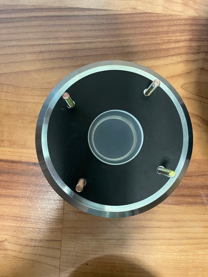

Based on much more recent experience I would not recommend current production PB950 on horns like the Yuichi A-290 and similar. They work well on some of the JBL resin/fiberglass horns though. They have a step in the throat which causes a discontinuity in the lower mid-range from memory. Gotta be other better choices. (I went to TAD TD-4001) The 951 might be OK, as far as I know it does not have a step in the throat. (I posted this because someone liked one of my posts extolling the virtues of the PB950 today and I have a very different feeling about it now.)

Using DSP rather than passive crossovers sounds like a shoe-in for a two-way speaker system https://www.diyaudio.com/community/attachments/possible-chain-png.822406/ , but wouldn't it rule out using two stereo DACs, as there would likely be clocking issues? Instead, a multichannel DAC, such as.

Is that “step” you’re referring to that eccentricity inside of the throat in that photo? How likely is that a manufacturing defect? If yes, why didn’t you return it to Radian to have them replace the defect part?
You said that the defect causes audible lower midrange discontinuity. Is that aberration something that can be measured and displayed as some kind of spectrograph?
However, you also said that yours and the “current” production runs of the 950 (close consecutive serial numbers) do work well on other horns, so could that eccentricity somehow not be a defect, or even an intentional feature of the throat geometry? Perhaps owing to my limited knowledge, I did have some trouble interpreting Vance Dickason’s measurements, otherwise both the 950 and 760 apparently measured very well in most respects. https://audioxpress.com/article/tes...eering-950pb-and-760neopb-compression-drivers

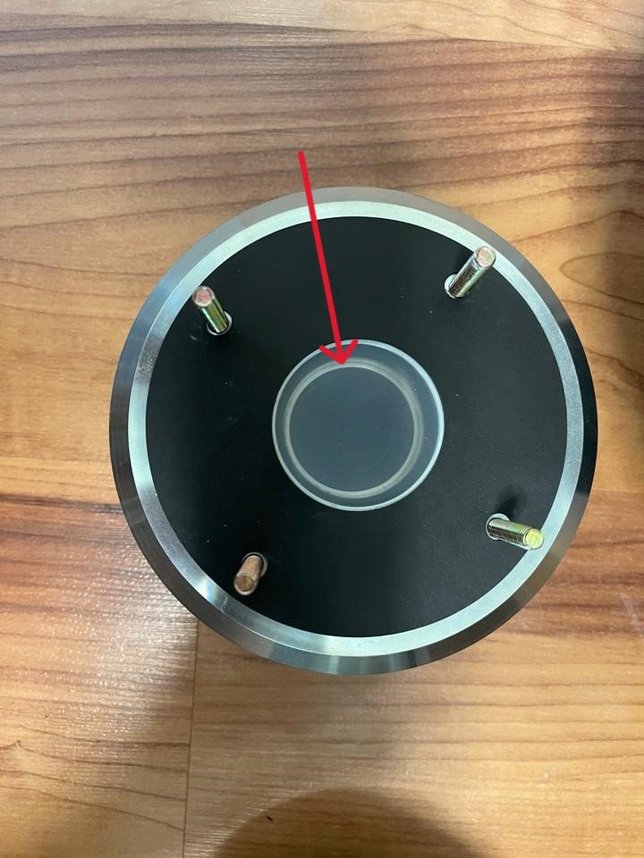

The *eccentricity" is caused by the angle at which the picture was taken is and not the issue. The step he is talking of is the lighter coloured ring in the back of the throat which is causing a discontinuity.
It is the circle highlighted by my arrow, in the back of the throat.
And no it is not a defect, it is sadly produced like that.

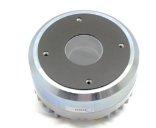

The 951 is a better bet, the 950 is a 951 with that adapter that has clearly been altered at some point.
As has been stated many times before.
Since you referred to audioxpress/voice coil mag, go look up the 4015Be review and you will see the effect of a similar throat debacle made by the reviewer.
No it is a native 1,4" exit.

Look into the throat opening of the driver? use a concentrated light source if necessary for a good view.
But they do not have it.

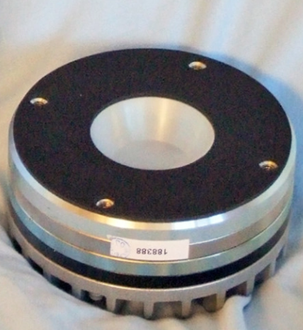

And it is not a defect.. It is a part that has been purposefully machined and fitted to a 951PB "base", as to make the 950PB.. But that detail was not so in some of the earlier produced drivers for sure.
As for the 760 it did not use to be like that either, is all i can say for sure. Look at the picture and you can see the expansion in the throat, not just a abrupt step.
