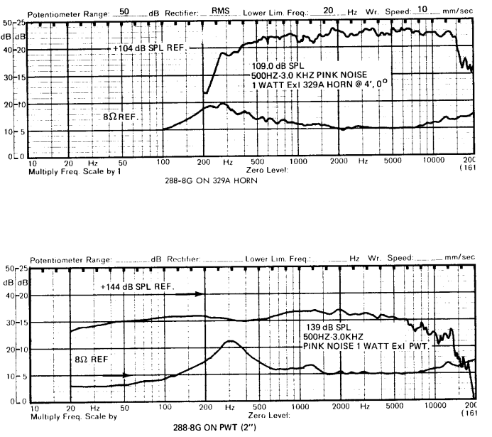

Way out of date, but curious how Altec's once best of the bunch large format (1.4") 288-8G on a 300 Hz expo horn fares with these newer ones.

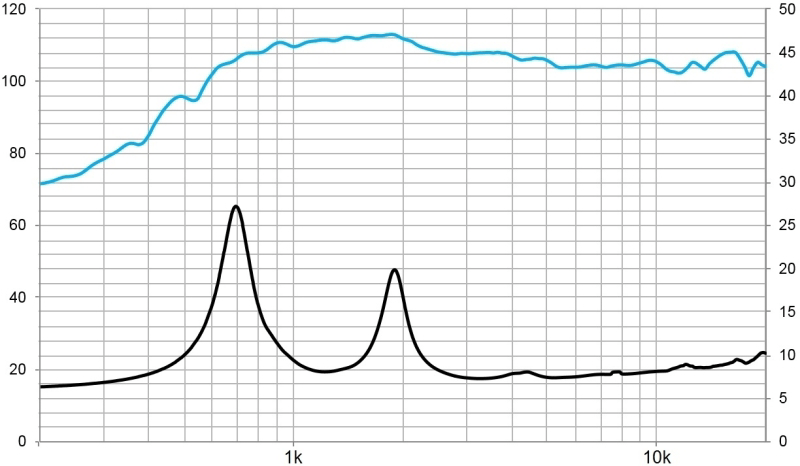

Beyma CP755Ti is a ferrite versión. Has same diaphragm and is cheaper than 755Nd
https://www.beyma.com/en/products/c/compression-driver/1CP755TI8/motor-cp-755-ti-8-oh/
I support this choice. I have Altec 299-8 and am very happy with them. They may be difficult to get hold of, but if you come across some, they are certainly a good choice.Way out of date, but curious how Altec's once best of the bunch large format (1.4") 288-8G on a 300 Hz expo horn fares with these newer ones.
