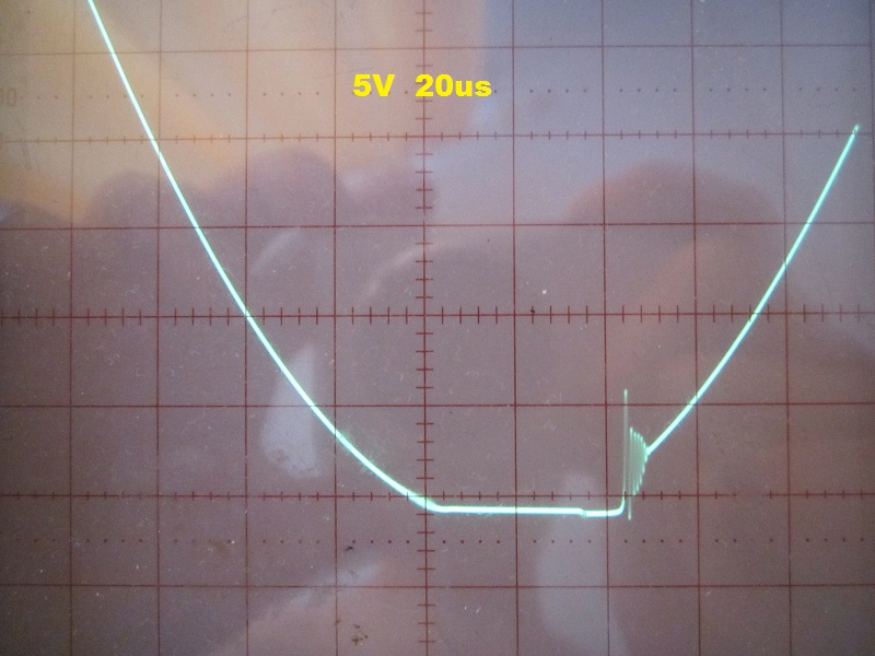

I would connect scope channel A to the collector of Q16 and scope channel B to the emitter of Q16 (pin 4 of connector J3). Display them both. If the emitter swings 7V past the collector, despite the presence of diode D8, that's quite a big surprise.
In fact that's Q18 (sorry for the quality of the image). I thought about that of course but I have only one osc. probe. I will have to buy another one to measure two voltages simultaneously. This is why I indicated in the attached oscilloscope images of my post #15 the position of -VCC as seen on the scope when I connect the probe to the collector of Q18.
So the oscillation problem is largely solved!
Increasing the VAS emitter resistor from 2R2 to 20R is effective indeed, it reduced the oscillation, but what was even more effective is a 680pF capacitor from VAS collector to GND. These two things together almost completely eliminated oscillation even with capacitive loads (6R parallel 100nF).
Using lower than 680pF has less effect in reducing the oscillation, any higher capacitance doesn't make it better, so 680p seems to be the best.
Unfortunately this 680pF capacitor slows down the positive slew rate to about 9V/us. The maximum slew rate of a 20kHz 40V peak voltage sine wave (that is 200W/4Ohms or 100W/8Ohm) is 5V/us, so 9V/us seems to be still acceptable, but I'm inclined to use only 470pF that allows about 13V/us positive slew rate. (thinking about high resolution audio that may contain frequencies above 20kHz).

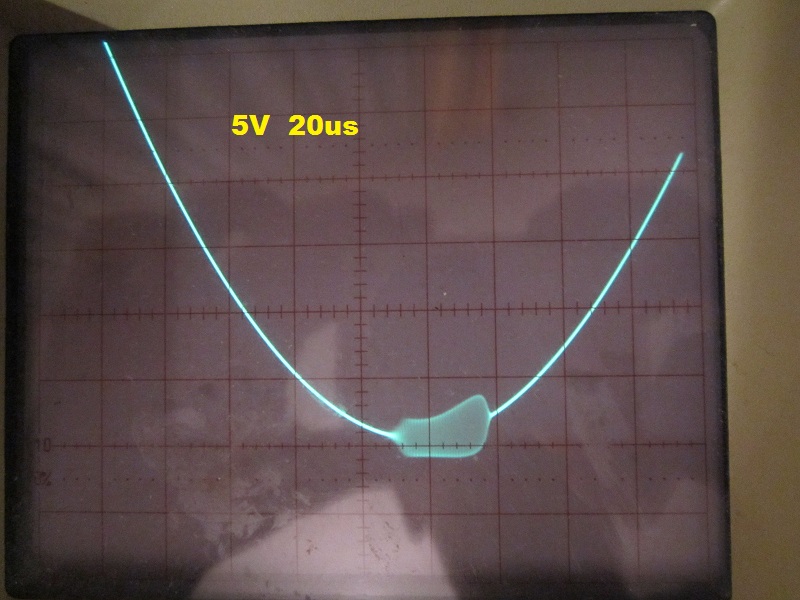

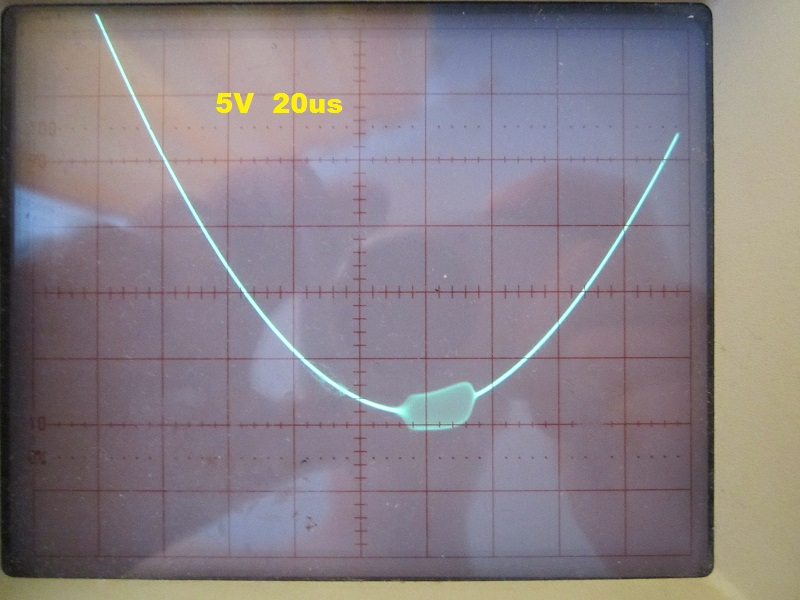

I'm back again, because my "almost completely eliminated oscillation" sentence was an overstatement. It indeed dropped to about 1/13 of its original amplitude. But that amplitude was about 40V p-p. With 470pF capacitor from VAS collector to GND, and a 20R VAS emitter resistor the oscillation is still about 3V p-p. And I'm afraid it can radiate RF via the speaker cable. The oscillation starts when the output voltage comes closer than about 2V to the negative clipping voltage. See images! I plan to post images with the Baker clamp removed tomorrow. It's a bit different without the Baker clamp - it doesn't oscillate anymore once the bottom (flat) portion of the curve is reached, but comes out of clipping (hard saturation) quite abruptly.
I used FDH400 for the Baker clamp (very similar to BAV21). It seems that whether the Baker clamp is in place or not, phase inversion or significant phase shift of the VAS occurs near clipping, so the feedback becomes positive and >1. The oscillation frequency is around 1.1MHz. The amp is solid even with capacitive loads if not driven near to negative clipping. The problem is always the negative clipping.

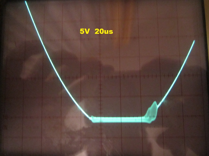

So here are the images with the Baker clamp removed. It seems the Baker clamp only helps the amp in coming out of saturation, it actually worsens the oscillation.
No wonder: When the Baker clamp acts, it bypasses the VA transistor so the inverting action of the VAS is diminished becoming a non-inverting stage and the overall feedback may actually become positive. Even makes me think... that the the higher the phase margin is (the more stable the amp), the more disastrous the feedback may become if the VAS goes non-inverting from inverting...
LTSpice showed some tendency to oscillation when coming out of clipping but it also showed that the Baker clamp does away with it. Well, not in reality. I think the problem is that as soon as the voltage peak gets near clipping and the signal gets too distorted, the input stage current mirror "bottoms out" and drives the VAS "too hard", so to say in laymen's terms. :(
I'm neither a fan of high loop gain at low frequencies, nor against it, the high loop gain of this circuit comes as a byproduct of the current mirror (to linearize the IPS) and the beta enhancer (to linearize the VA transistor). If I remove the current mirror, then the IPS will be the main source of overall distortion and if I remove the beta enhancer then the VA transistor will be the main source of distortion.
And I don't want to increase the Miller cap (Cdom), because the amp is rock solid even into very capacitive loads, so the thing is not about overall loop instability.
Wonder if there is any means to clamp the input stage near clipping, because I feel the problem is best handled just there.
Also tried a few changes with the OPS, but it said: "Thanks, I'm fine, I'm just doing what I'm told to do!" :)
Also wonder why so many people who have built the Blameless have not run into this problem.
And why it oscillates only at negative clipping? I think (again in laymen's terms) the VAS has a tightly fed back current source that effectively "resists" sourcing more and more current at positive clipping. But at negative clipping nothing stops the VAS from trying to sink more and more current, except for it's emitter resistor.
