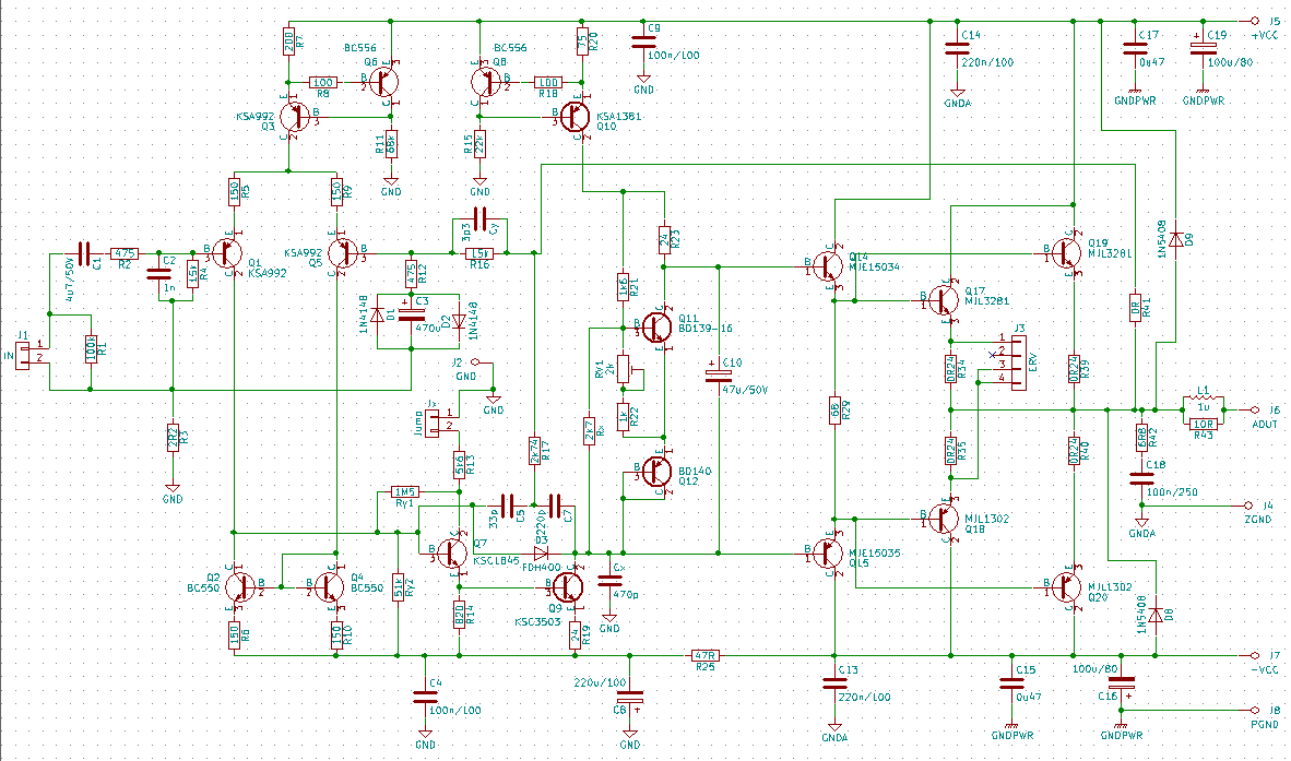

Hi Generis69,
Can you post an updated schematic?
Have you tried base stopper resistors on your CCS transistors?
Best wishes,
M.
The most recent circuit is attached to post 68 which shows this has been done. It also introduces a lag capacitor to the output of the Vas Cx 470 pF.
This is worse than superflous since it introduces yet another pole making the in-fighting such than none of them has enough domination.
Re stopper resistors I would increase the values of those in the output transistors bases - there are notches in the latest 'scope pictures which suggest output stage sticking effects.

Have you tried increasing the power supply rails to the pre-stages rather than having a voltage drop in the filter sections you originally showed?
No, I haven't. I don't want to make the amp overly complicated if not strictly necessary. I think I can do with a bit of oscillation on clipping. I just don't want that big surge current during positive rail sticking.
Some time ago I removed the 100u-47R RC filter from the positive rail to the IPS-VAS as somebody recommended, but unfortunately I haven't reported on that for you guys. Sorry, I update the schematic now.
Ry1 and Ry2 at the input of the beta enhancer (Q7) is only experimental and probably won't remain. I just played with them to reduce the Loop Gain (LG) at low frequencies from 100dB to about 80dB without upsetting the current mirror balance too much. I know D. Self suggests a resistor between the VAS C and B to to this, but that resistor -- if too low -- upsets the VAS biasing and causes a peak in the loop gain with two-pole compensation. Putting a big series film capacitor there is not elegant. But I'm not sure that reducing the low freq. LG (and so shifting the -3dB rolloff point of loop gain higher) does any good to sound quality... At least I can't hear any persuasive difference when I listen to music with this lower LG setup.

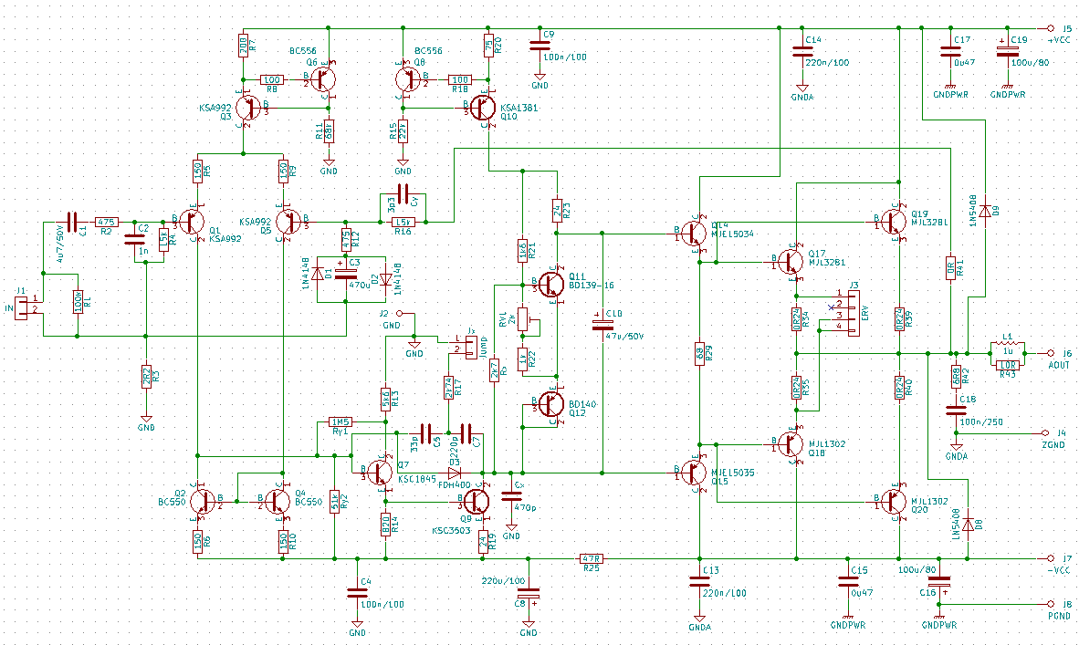

Correct schematic and LTSpice file
There is a mistake in the schematic at post #125. The Jx jumper was put in the wrong place. It's to select between Miller and TPC. Here I upload the correct schematic.
Hi mjona, Without Cx, the "lag" capacitor, negative clipping will become Hell Unleashed. I can't see any problem with the pole introduced by Cx.
Or am I making a mistake in simulation? I upload the LTSpice file, you guys can check the effect of Cx or anything you want. Unfortunately the simulation doesn't show any oscillation problem at clipping, so the KSC3503 model may be very inadequate. Inductances are all parasitic except for L1=1u at the output.
For any difference found between the schematic and "200W LDA192-1.asc" file, the schematic is decisive.

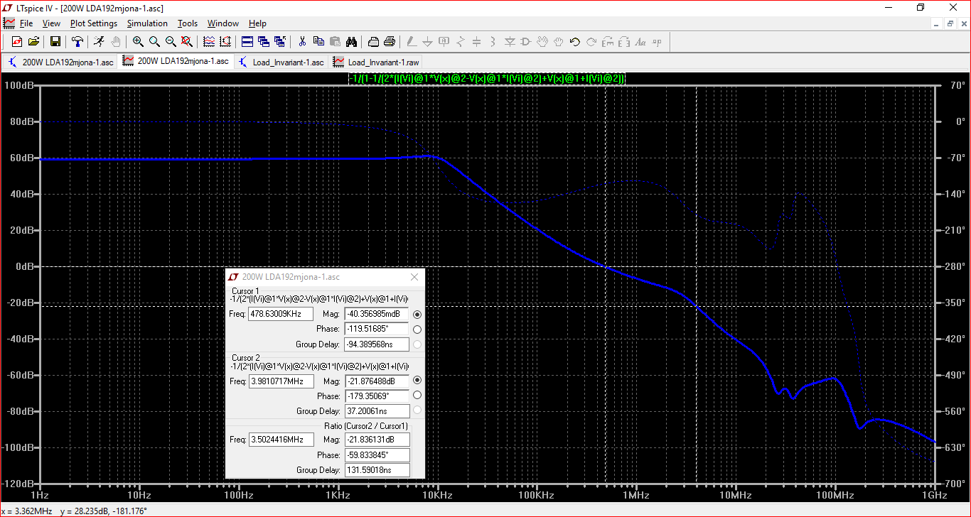

To see the loop gain plot: Run the simulation and Add new trace "-1/(1-1/(2*(I(Vi)@1*V(x)@2-V(x)@1*I(Vi)@2)+V(x)@1+I(Vi)@2))".
To run transient and check THD, set prb to zero. Set freq and/ or input signal level as you like. The THD data is saved in the Spice error log.

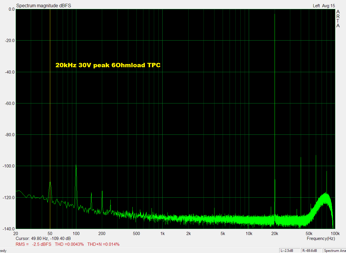

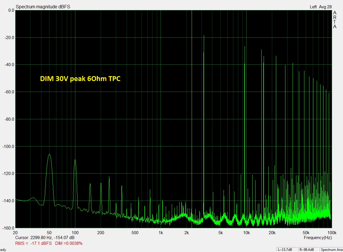

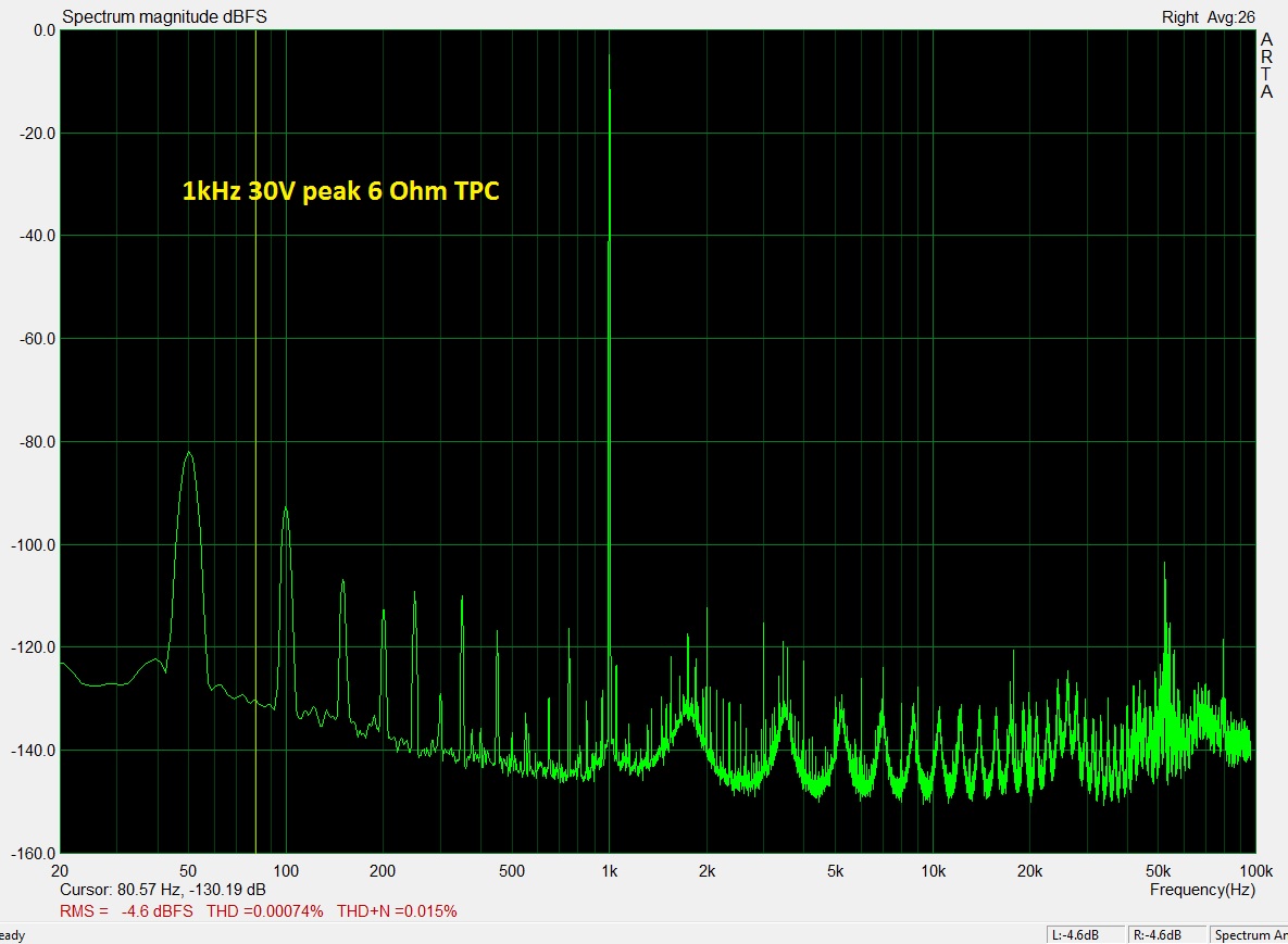

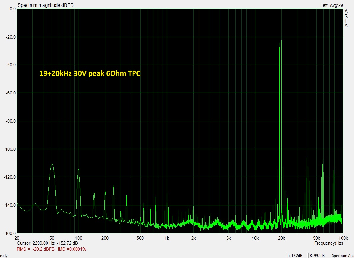

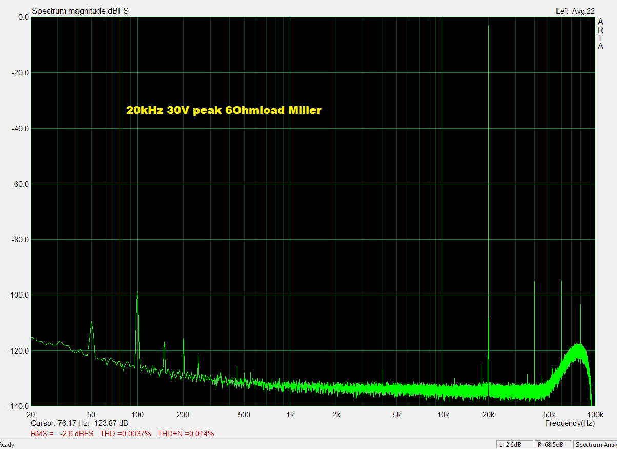

distortion measurements
I could buy an E-MU 1212M PCI card and could do some measurements with ARTA. The E-MU driver (there is no official win7 driver for the PCI version card) throws me a BSOD every single day, but the E-MU card itself is very cheap for its noise and for its 1kHz THD performance and does fine at 192kHz sampling rate.
Surprisingly at 20kHz the E-MU performed worse than the Steinberg UR22 mkII, which I had over from a friend for a couple of days. However at 1kHz the Steinberg had about 10x higher distortion. So all measuremetns were with the E-MU, except the 20kHz was with the Steinberg. (20kHz THD only incorporates 3 harmonics beacuse of the 96kHz limit.)
Measurements were 30V peak signal into 6 Ohm resistive load (about 75 Watts). All measurements turned out to be around the distortion of the sound cards specified in their manuals, or even lower, so the power amp itself probably has lower distortions than measured. It would require a finer equipment to know for sure. DIM is Dynamic InterModulation distortion.
So the prediction of the Spice simulation is good about distortion figures, they are very low.

I did not like the shapes in the phase and gain plots in post 131.
The strategy of adding parasitic elements looks to me like adding complexity which could be a two edged sword.
Unless such effects can be modelled reliance on covering these should rest on adequate phase and gain margins.
Another Possible Approach
My simulation is attached. The gain and phase margins are reduced in this version and the unity gain point is at roughly half the frequency in the original.
In the natural world phase alters more quickly than gain will decline. It is possible in a simulation to boost phase so there is a delay causing this to lag behind to some extent.
I have included the expression which needs to be pasted in the vout header as a comment in blue on the .asc file. The .models are all due to Cordell and the .inc statement is linked to his website.
For this version the trend in decline reaches an early point where the plots run in parallel. There is no secondary boost in the phase. If you look at post 131 it can been seen how irregular the shape of the second boost was and see perhaps why I did not like it.

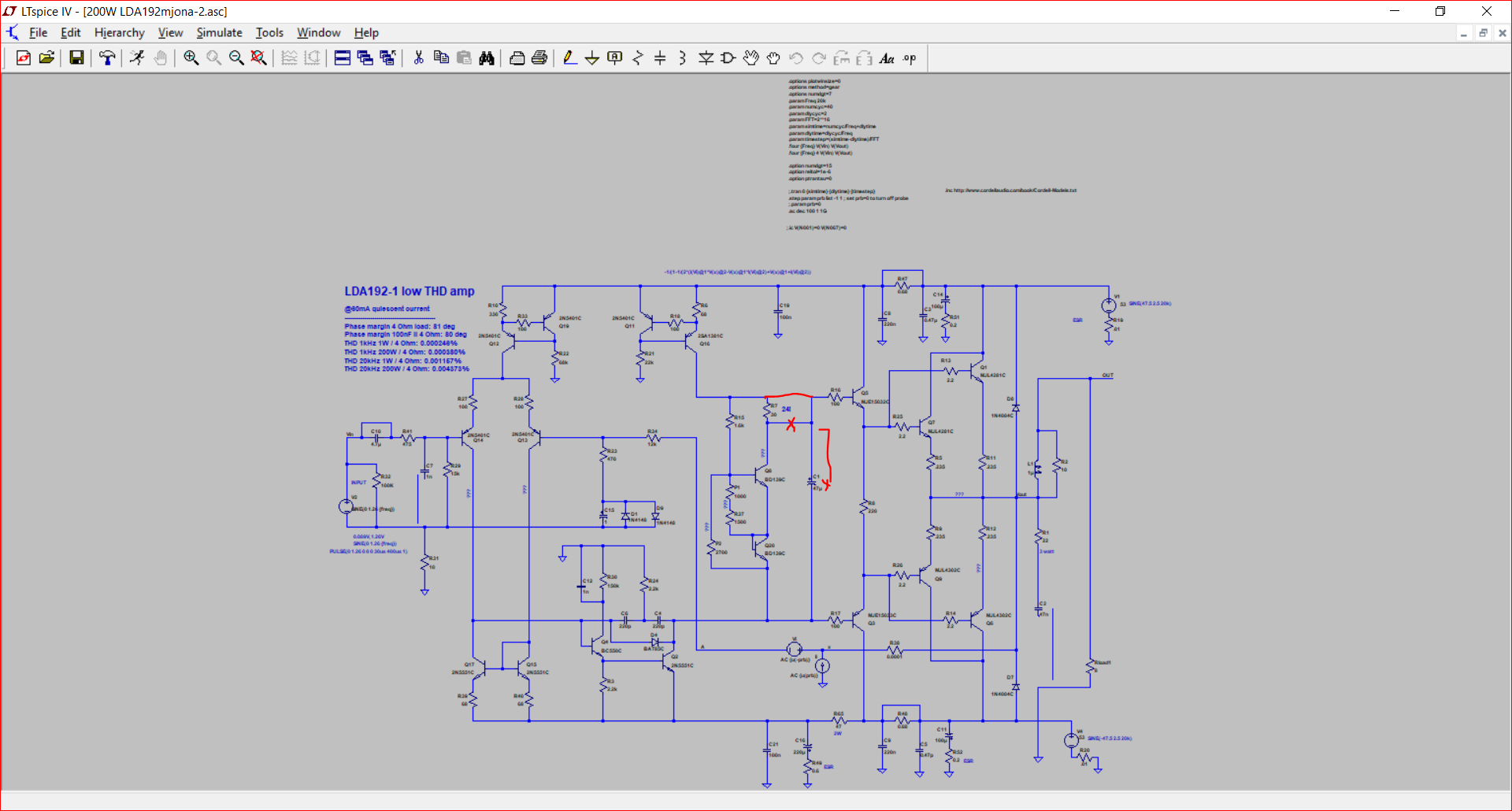

This partial schematic illustrates a way to avoid positive rail sticking.
I have tried the circuit you proposed in post #119. Unfortunately it didn't stop the rail sticking nor the current surge across the output transistors. The LTSpice simulation also showed that the current mirror transistor does go into saturation, and your circuit prevents it. (The simulation also showed however that the current mirror transistor leaves this saturated state very-very quickly, so it doesn't really affect rail sticking.) Perhaps that is why this method doesn't work with my amp. The "significant" saturation occurs somewhere else.
However I could decrease the current shoot-through across the output transistors to a level where the overcurrent protection doesn't encroach, by adding a speedup capacitor across R29. Both you and John Ellis proposed this capacitor before, but at that time I didn't install it because both the LTSpice simulation and the datasheet suggest that the OPTs are fast enough to prevent significant shoot-through even at a 30kHz full swing signal. Well maybe they are fast enough to prevent cross conduction around zero crossing but maybe not fast enough near the positive rail at low Vce.
The optimal value of this capacitor still needs to be found, because if it's too big, then it does more harm than it does good.
The first thought that comes to mind is what impact are the output transistor stopper resistors having on the speed up capacitor across R29 and considering there are 100R base stoppers in the driver stage are these 2.2 ones strictly necessary.
An additional thought about the problem with the positive swing relates to the connections for R7 in the Vbe circuit.
The way the Vbe is configured has R7 in series with R16 while R7 forms a low pass filter in combination with C1 - see attached.
The collector of Q16 should connect directly to R16 stopper resistor and to collector Q8 via R7.
For checking purposes see the attached image.
